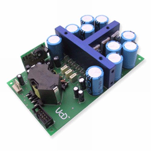

I'm finally getting around to building up a pair of UCD700 mono amps. I have all the parts and now I'm working on the case design. After looking at the UCD700s, I have a few questions.
1. What is the best orientation for the amplifier module? I'll be mounting it to the back of the aluminum case. My guess is to mount it sideways with the small PCB towards the bottom and the output inductor above. I think this should provide the best flow of cooling air past the module.
2. How should the 4 power supply wires and the 2 speaker wires that go to the faston connectors in the center of the module be routed? Just run them all together out the side of the module above the output inductor? Or route the power supply wires separate from the speaker wires? If so, where?
3. Would it be worthwhile to flip the power supply fastons on to the back side of the board? It would make the wiring much simpler and neater and I have plenty of room to do this, but I'm a little leary of damaging the PCB or unsoldering a couple of surface mount parts in the process. Any negatives otherwise to this idea?
4. The case will be roughly a 9" (225mm) cube. Is 1/8" thick aluminum adequate from a heatsink standpoint, or should I go to 1/4" material for the back plate?
Here's a picture to help in visualising what I'm talking about.

The only way of mounting the UcD700 is to put them down on an heatsink, whereby the solder side becomes visible. Or sideways with the small Modulator PCB on bottom and the output inductor above.
You can run the cables just between the heatsink/mounting plate and the component side. Is no problem at all to have all wires very closes with each other, of course you could replace the fastons to the other side, but be careful with the small SMD!
1/8” thick aluminium will be fine.

IMO the best way to mount the module from a thermal point of view is with the top of the T section mounted against a serious heat sink. I really don't like the thermal design of the UCD700. It is a step backwards from the UCD400. I figure they must have originally tried to build a bigger UCD400 style unit but for some unavoidable layout problems they had to flip the heatsink around. It certainly didn't make my day when they did that.
It’s indeed less easier mounting as the UcD400….but we have done this to make the EMI as low a possible.
