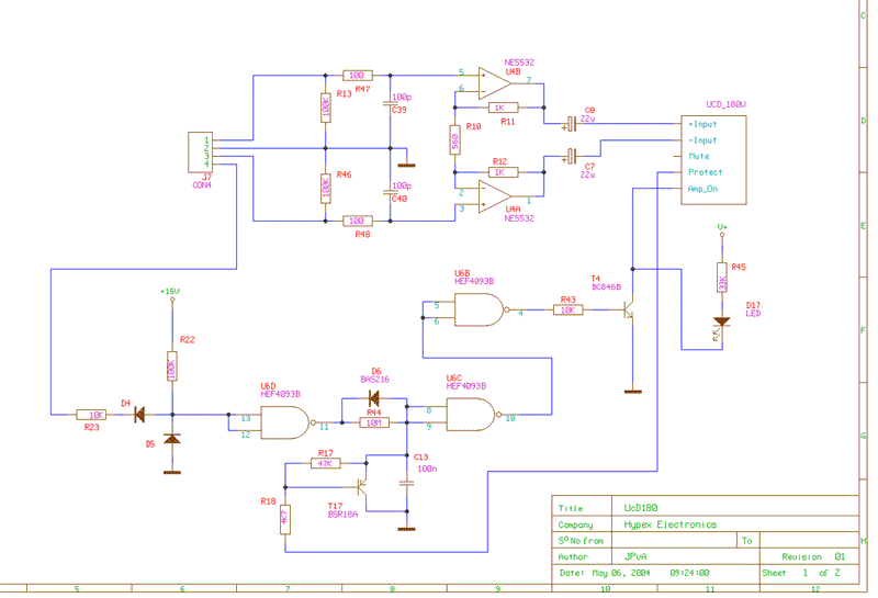

A few questions concerning the input of the module. The module has a symmetric input using a NE5532 dual opamp. It seems to be used as an instrumental amplifier like input with the UCD itself acting as the 3rd differential amp. I can not see all traces on the PCB but it seems to be connected like an instrumental amplifier with a gain of about 4.5 or so. The outputs of the two opamps go to the inputs of the UCD amp itself. This is done by two coupling capacitors that are 22uF electrolitic capacitors. Assuming that the input impedance of the UCD amp itself is something like 1.8k for the inverting input (as stated in the classd.pdf file), then that gives a high pass filter at 4Hz. That should be fine for all apllications. However, when I`m going to use this amp for a tweeter or a midrange, I sure would want to replace the electrolitic caps with a different type of cap and of course with a lower value. Are those caps really required? What happens if they are replaced with a piece of wire (0 Ohm resistor). Would that give problems when the input voltage is not purely symmetrical? I assume that when the input signal is pure symmetrical, it sould not hurt to remove the caps, would it?
Keep in mind that this will give another pole in the highpass transfer function if you take a smaller one.
So I would either leave them as they are (for all channels) in order to not have to care about this added pole or deliberately dimension them such that they are a part of the wanted x-over function.
On the ones that I will get, I will probably add a parallel polyprop cap.
But I would never replace them by a piece of wire.
To be sure if it is save to remove them you may ask Jan Peter by e-mail and post his answer here.

What are the input impedances of the two inputs ? I am asking because I may probably use a 1st order passive RC crossover on one of the two channels.

Charles,
Please take a look on the attachment. The inputimpedance of the UcD modulator is 1.8K.
Jan-Peter

It was not the input impedance of the modulator per se I was interested in but the input buffer. But from the diagram I can see that it is around 100k from each "leg" to ground (at least at LF).

Charles,
If you take a look to the original Philips IP datasheet about the UcD there is written the inputimpedance of the modulator.
Inverting input 1.8K and none inverting 10K. Because of the extra Opamp, you now have a true balanced input.

Hi Jan-Peter, Charles,
Jan-Peter, thanks for the schematic input.gif.
If you check the file input.gif, you can see that the input resistors at the input of the opamps are 100k. However, when I check my modules, that are actually 10k (1002 written on them). I also measured them and they are 10k. All the other resistors around that opamp have the same value as given in the schematic input.gif. So it seems that the input impedance is 10k.

Oeps,
Gert-Jan you are completly right!
I send this yesterdaynight from mine Home PC, the schematic at home is having two difference. Guess which one?
The input impedance is 10K, probably we are going to change this to 2 x 100K. In this case you can use a tube preamp.

Hi Jan-Peter,
Thanks for the confirmation. I`m OK with the 10k inputs🙂

Gertjan,
By an Half-Bridge Class-D amplifier you always have the problem with powerupply pumping effect. On the website of www.irf.com is a good explanation, please search there for the Class-D tutorial.
A good powersupply with enough capacitors will work in the most cases (2 x 10.000uF). If you will drive a servomotor or very low frequencies you will get problems. If you like I can post a overvoltage protection.
