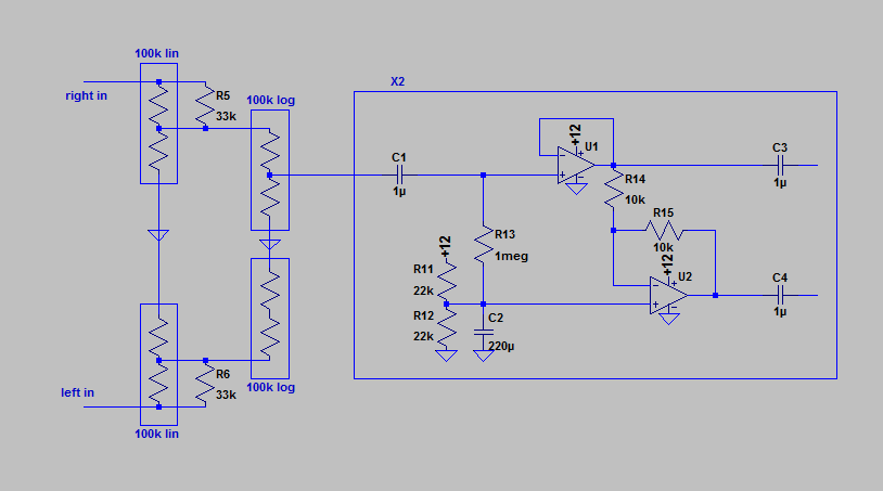

I'm about to build an integrated amp based on two ucd180hg modules. I've read Hypex's app notes and I don't really feel at ease with their suggestion to go class II if building it unbalanced.
Furthermore, I plan on using a motorized pot kit for volume control... but the pot in that kit is 100k, so I need a buffer in between the pot and the UCD's input.
So I was considering the following:
- Building the preamp section (see schematic below) and using a ground loop breaker in between the audio ground of the preamp and the enclosure. All the input section would be isolated from the chassis. Since I've got 2x12vac transformer for the auxilliary stuff, I can use a winding to power the preamp.
- Connecting the chassis to earth and to the audio gnd of the amplifiers (by earthing the midpoint of the power supply).
Any problems with that way of proceeding ? Is a shielded connection between the preamp and the amps really needed inside a box ? If yes, where do I connect the shield at the preamp side ? Right where the ground loop breaker is tied to the chassis ?

just search the chip amp forums for "loop ground breaker". and all your questions are answered BTW your grounded chassis is the shield and all amps need RFI filters at their inputs, if they left it off then they failed.
hum, no. The chip amp forums has plenty of general info on ground loop breakers, which I don't need. I've built enough dead silent amps to know how to use those. Most chipamps don't have a differential input as the ucd180 either.
The questions in the original post are about a particular implementation. Let's try with other words: if I float the input buffer (which is simply a basic unbalanced to balanced converter) with a ground loop breaker, is there still a path for a ground loop if I earth the amp section ?
i don't see any purpose for the buffer in the receiving section, infact C2 provides a dead AC short to the non floating ground. If it was me i would build the buffer at the sending end and use pro balanced connectors. otherwise consider BALUN transformers to break system grounds up AFAIK that's what the chip amp vendors ( lawyers?) suggest for those who insist on Class I gear and experience ground loop noises.
Building the buffer at the sending end isn't an option since the sending end is made of half a dozen pieces of consumer gear.
Could you clarify what you mean by "non floating ground" ? All the grounds in the schematic, including c2's, are tied together and are connected to the "floating" end of the ground loop breaker.

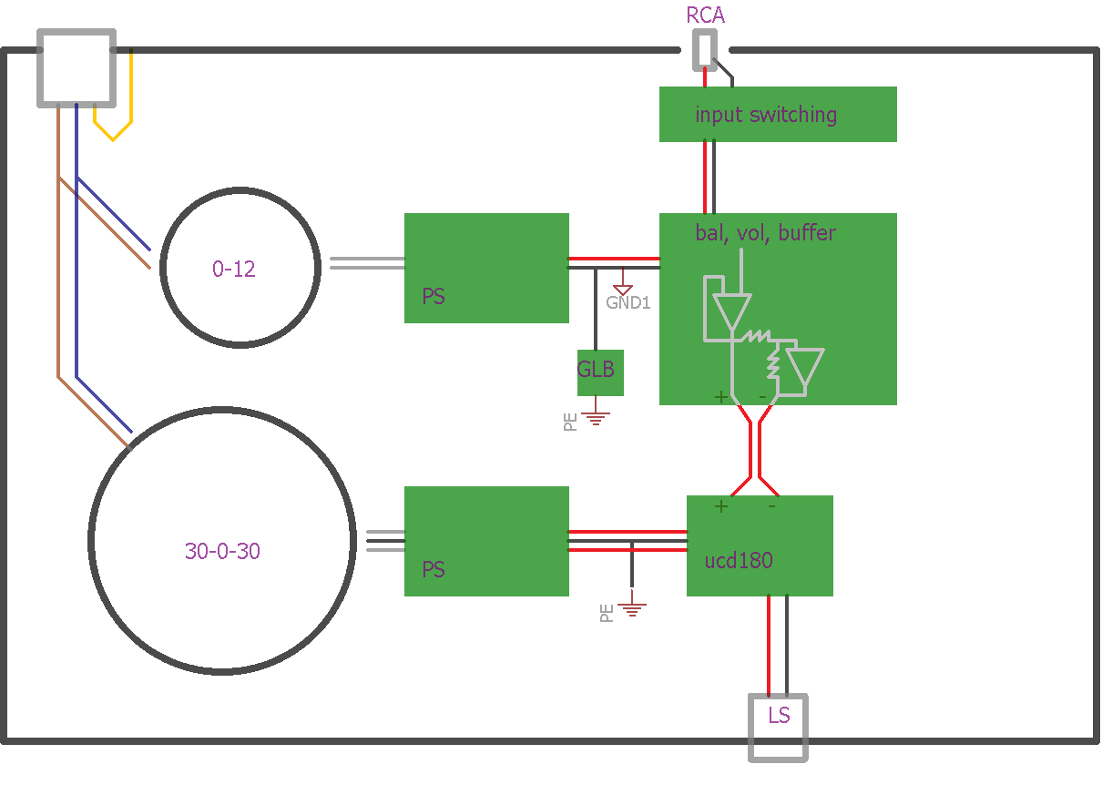

again not a fan of the loop breaker thingy*, are you going to convince any safety guys that your transformer secondary is really floating from PE too.
*I think it was born from a one off deal by an unlucky commercial guy getting his nuts caught in the UL vise. don't see it in any gear today LOL
draw your proposed grounding and DC power scheme on a block diagram level
label PE gnd, signal gnd, power amp or digital gnd, etc
BTW the class D digital noise appears as CM on its gnd and should be well isolated from signal gnd at the differential interface, signal transformers work very well and best of all they don't need power supplies that's one reason why I suggested a split or outside the box approach for yer active buffer circuits.
Fire up a class D PA look at gnd with an O-scope its very eye opening to say the least. basically you want to keep the D amp floating at all inputs / outputs by use of differential lines and for DC power, apply CM chokes very liberally. Look up how to make a common mode toroid choke with pairs of wires, very useful for floating or isolating hash from power circuits.
