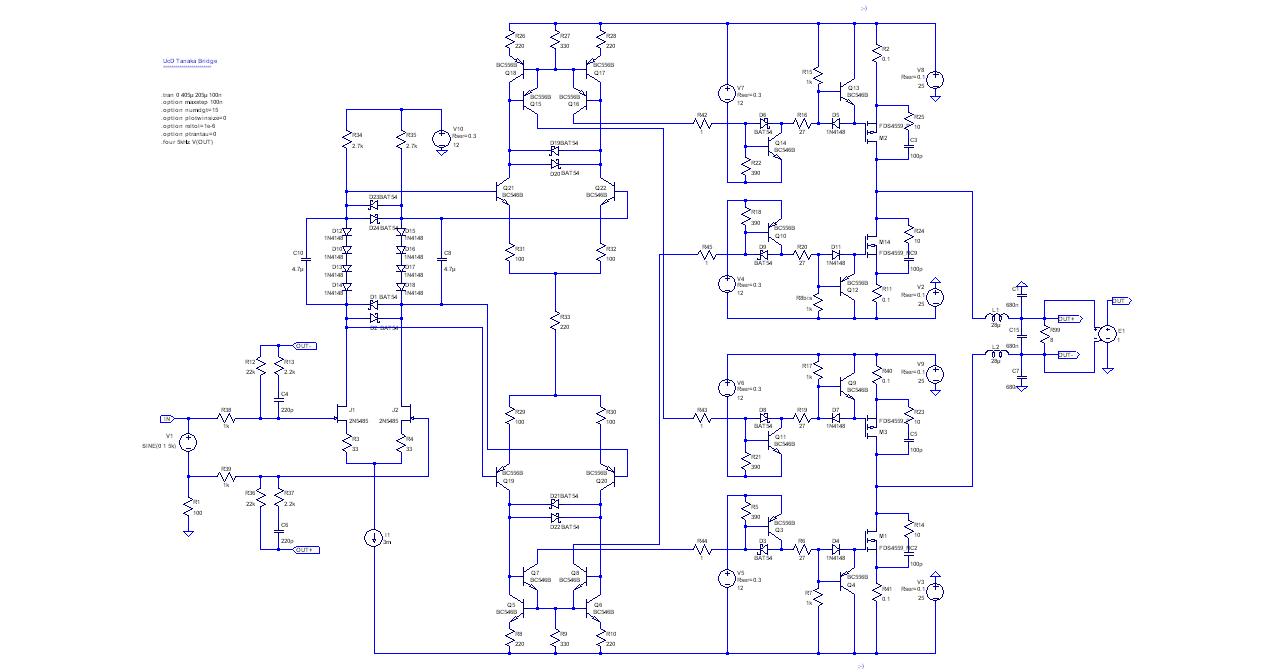

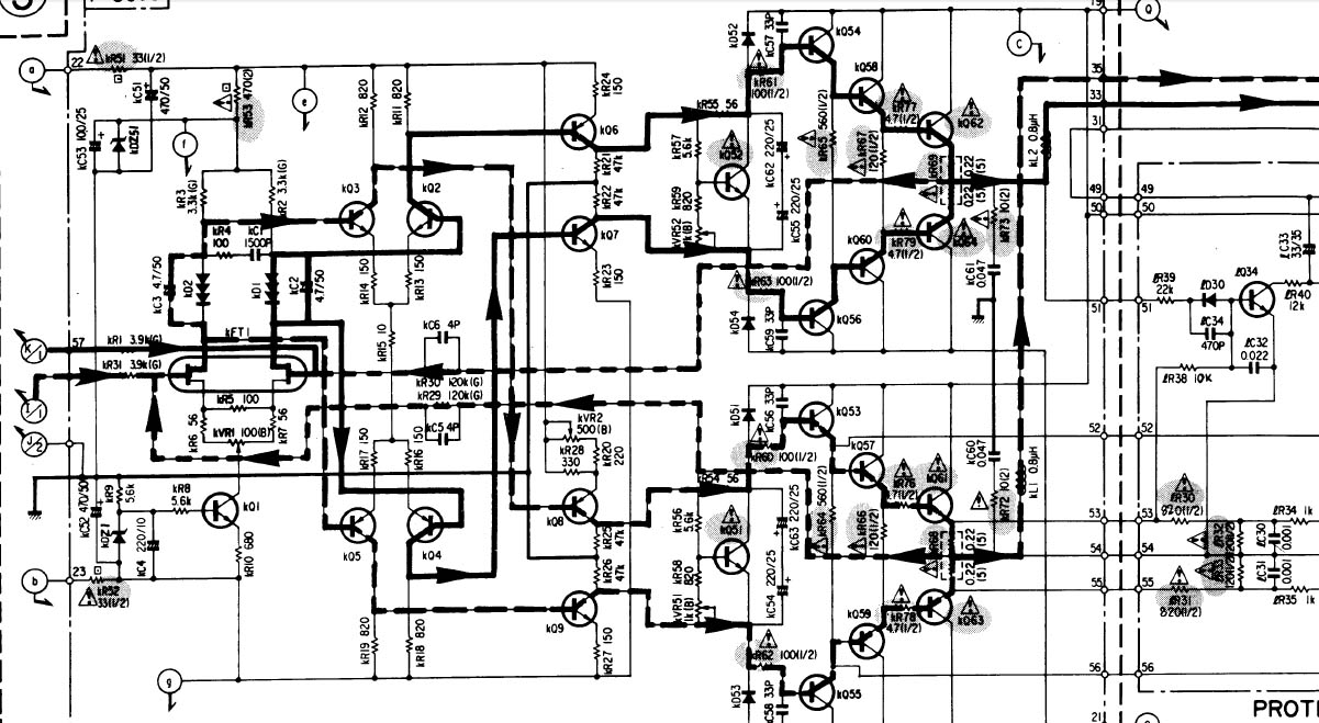

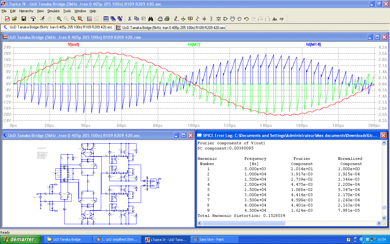

Hello, I had great fun transforming the Sansui-Tanaka Full Balanced Bridge into a Class D UcD amp. Can somebody check the waveforms ?

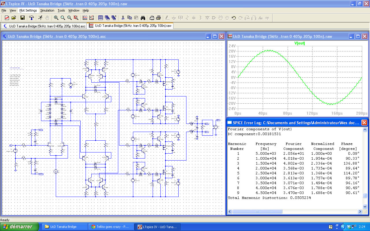

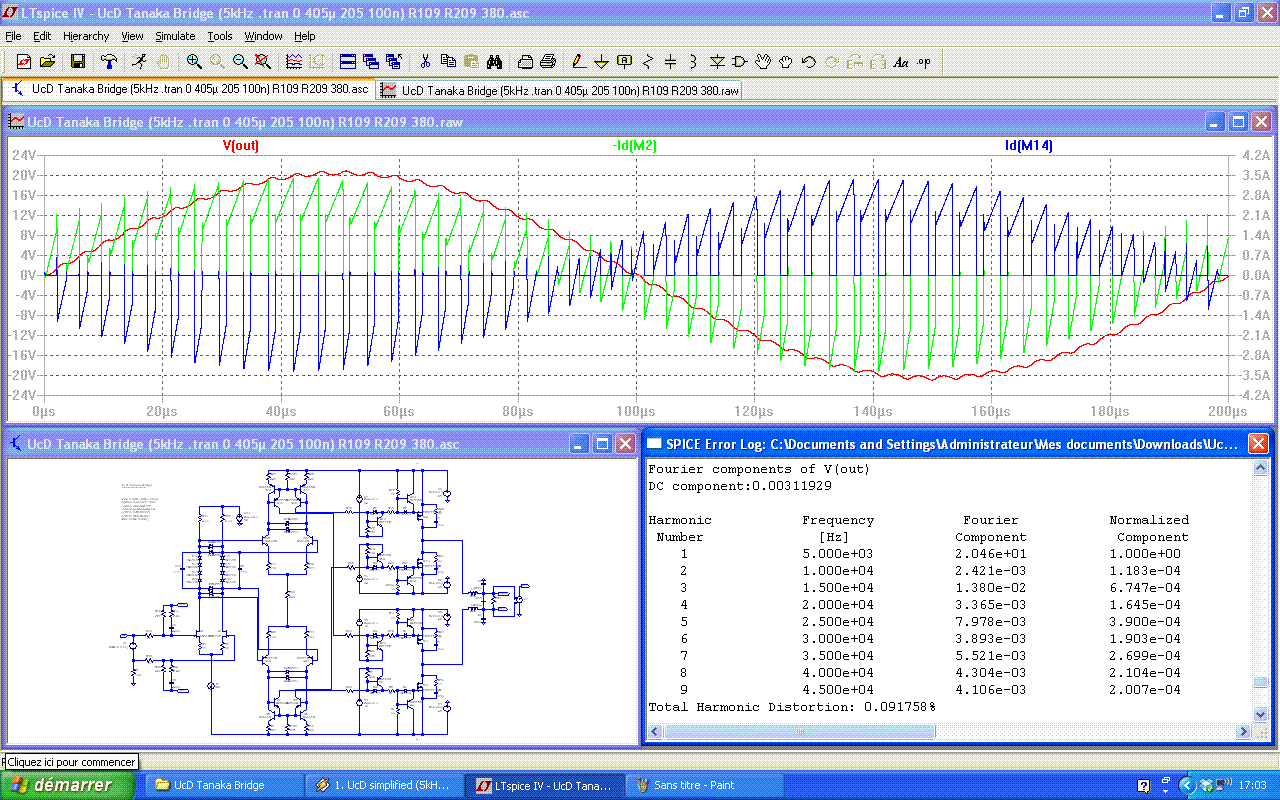

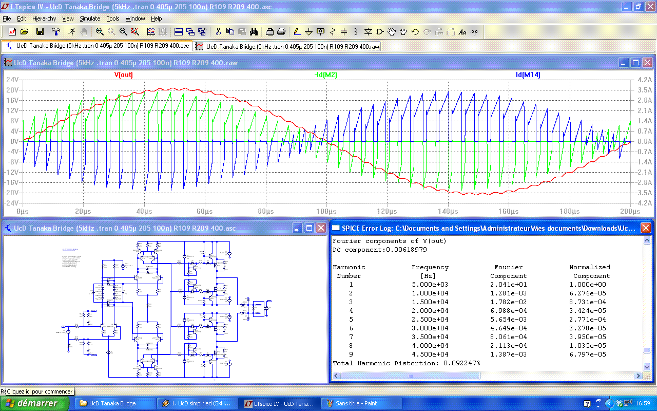

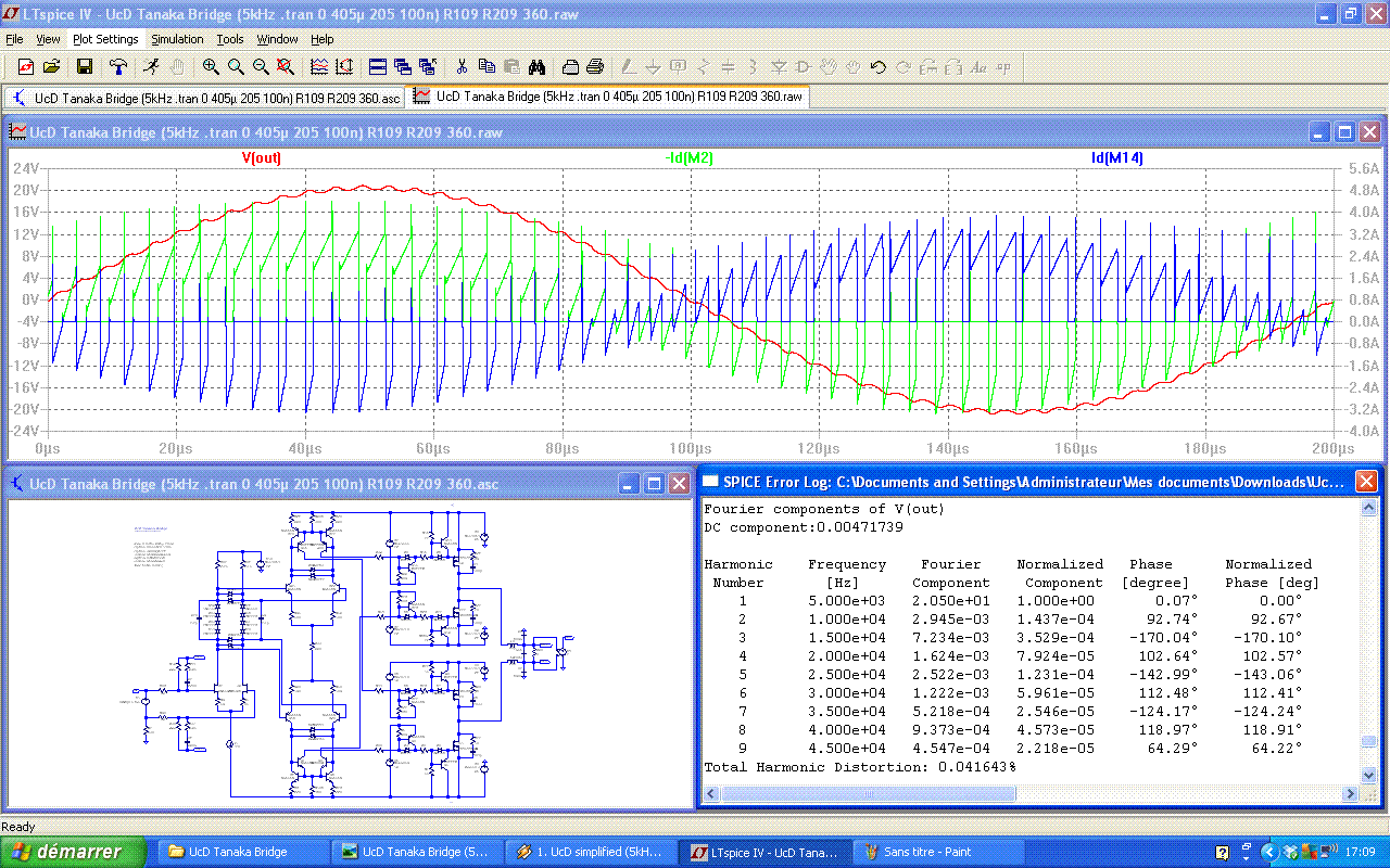

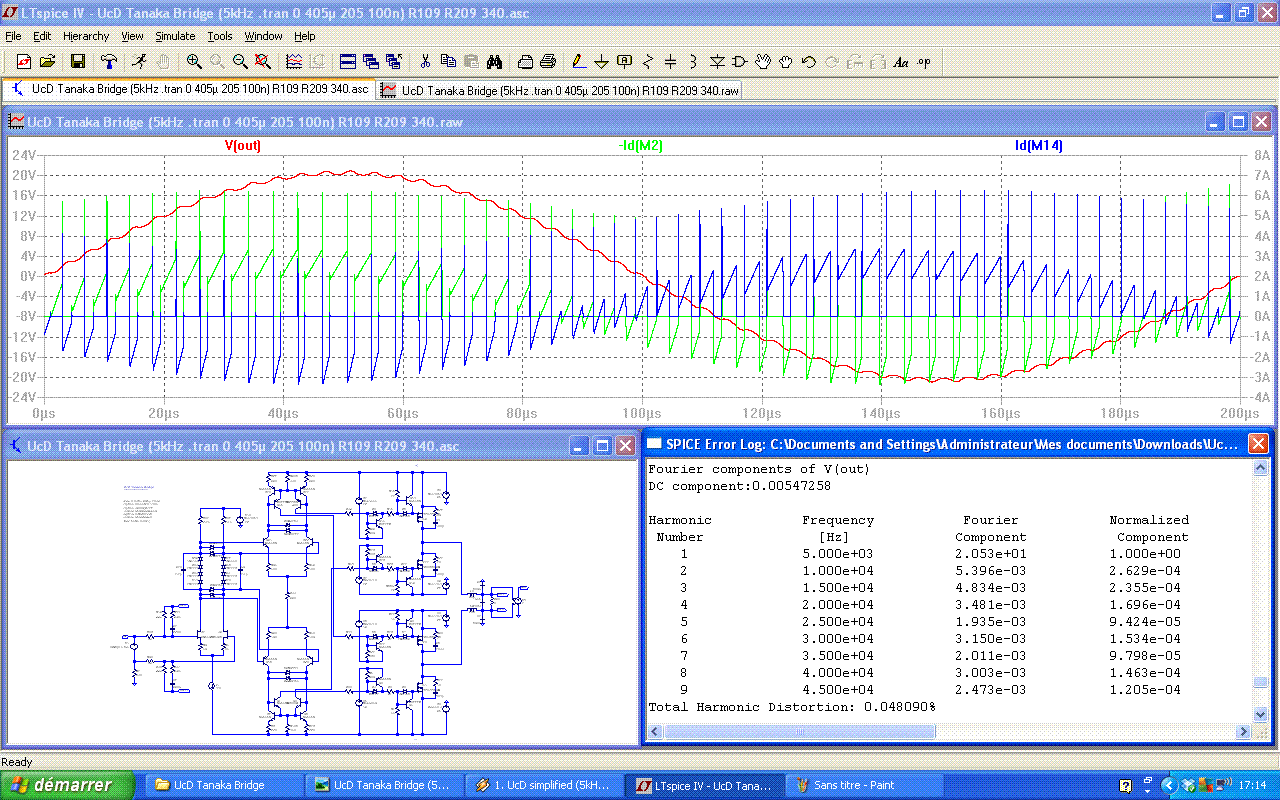

As suggested by Tekko in the "UcD Philips UM10155 LTspice simulation" thread, I played with the value of R9 (R109 and R209 here) for controlling the deadtime.
Here are the results:
R109 and R 209 (ohm)...Spikes.............................THD at 5kHz (%)
340............................Twice the AVG current........0.048
360............................Same as the AVG current.....0.042
380............................Acceptable......................0.092
400............................Barely noticeable...............0.092
420............................Past barely noticeable........0.152
See attached pictures and .zip
Thanks Tekko!
