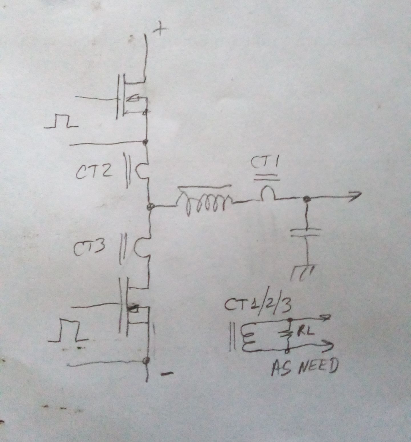

I suggest a current transformer. As you have a high frequency switching, it's easy to build on a small ferrite toroid a current transformer, and from its secondary rectifier peak to peak, you take the action whished: shutdown the entire amp, indicate via a led for warning, etc.
Also using several of them you can test each arm current (top and bottom MOSFET) and load current indepently and, again, take an action.

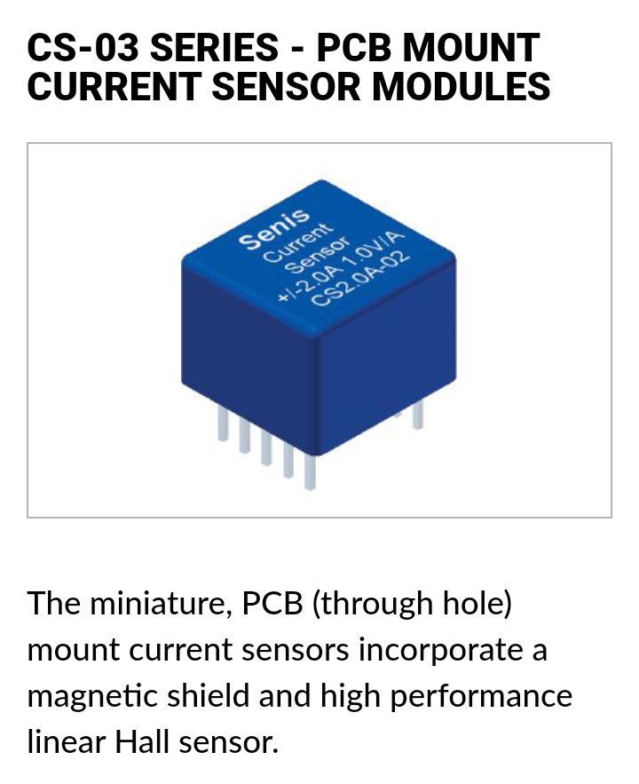

There are several current tranformers manufactured ready to use, some of them are internally closed loop. Some give you a DC voltage proportional to current sensed, and others a current. But in my experience, all them relies on a hall effect and a true current traffo, and a opamp. But invariably most of them suffer from DC bias at their output as a consequence of overload (a powerfull shortcircuit in the sensed current that manetizes the iron path) or resistor aging or SMD trimpots becaming noisy.

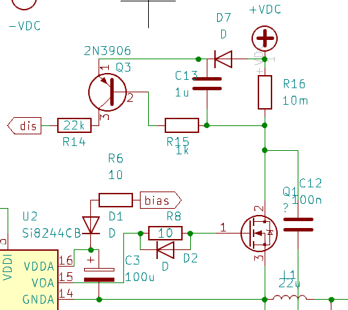

Theorethically a short could not last for more than 25 ms (half of a 20hz period),and a mosfet could probably survive that if it has a long enough time to rest afterwards for the heat to migrate out.Pictured is the over current detector I had pictured,altough I should use a monostable circuit to get a 1-3s cooldown time rather than the capacitor
should be fine the short is connected through the inductor of the output filter so is limited in di/dt. You can limit the maximum duty cycle to reduce the bootstrap capacitor size and also ensure that you have a chance to sense the short current. Make sure your OCP retry is not too rapid. High side sense will be tricky!Fast enough to get low ish switching losses,the switching frequency i see no reason to be higher than 250khz.The issue with one sided current sensing is that if you get a short when the other fet is conducting it will not be protected,whether that is a problem or not,i'm not sure,that's why i'm asking
put the current transformer in series with the inductor or simply add a sense winding to the output inductor
