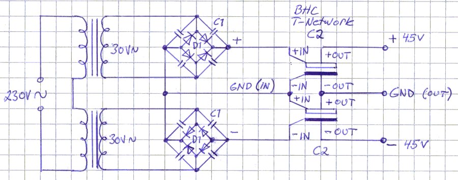

I have ordered T-network caps to see how they perform anyway.
One minor question. Do T-network caps need any special attention to power supply. Only separate inputs and outputs as descriped in BHC documentation?

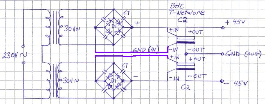

You have to use separate secondaries and separate bridge rectifiers per power supply side to get the best from them (so you only join the grounds at the "outputs" of the T caps).

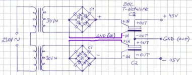

Sorry, i did not exacly understand.
I thought it as in picture attached, but do i have to connect GND(IN) and GND(OUT) together?
(sorry about bad picture
