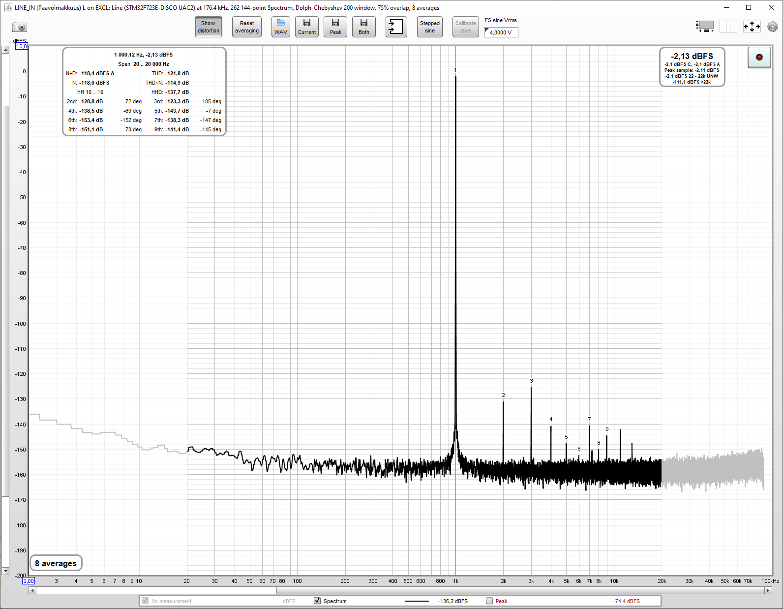

I made a simplified version of my STM32F723 firmware for STM32F723E-DISCO board with just I2S input (no I2S output). Should work at least at 192k/32.
It uses this board:
https://www.mouser.fi/ProductDetail/STMicroelectronics/STM32F723E-DISCO?qs=DXv0QSHKF4wBapbNjrzotQ==
Attached is the source code. It runs on FreeRTOS although this version does not really utilize it.
I used STM32F723E-DISCO board's Arduino connectors CN11 and CN13 for all I/O.
I2S signals are at CN11.1 (FS), CN13.4 (BCK) and CN13.7 (SD).
I2C2 is available at CN11.10 (SCL) and CN11.9 (SDA).
4 GPIO outputs at CN13.3, CN13.5, CN13.6 and CN13.8.
GND at CN11.7.
The source code also includes a "driver" for my AK5394 board which uses all 4 GPIO outputs. This can be used as an example of how to connect to ADC board.
STM32F723E-DISCO board is of course not optimal for running I2S as it is meant to be a showcase of various MCU capabilities. For best results a custom board dedicated to I2S should be used.
Have fun!

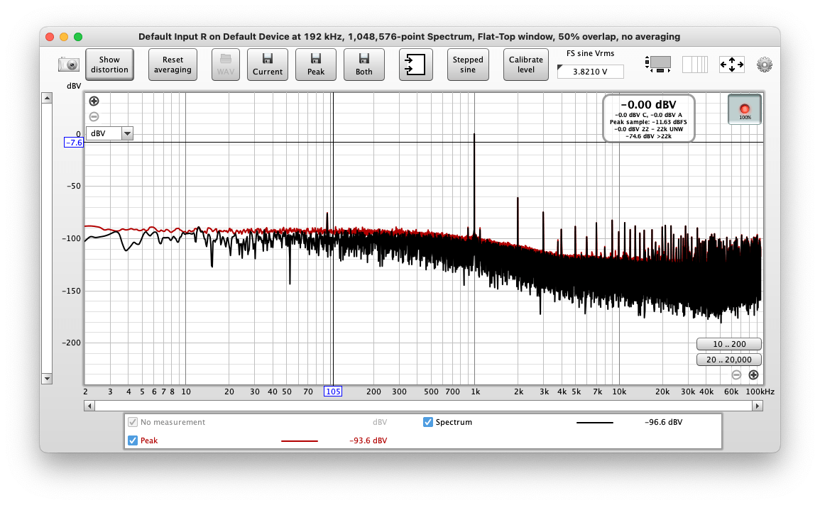

@bohrok2610
Hello (& happy new year everyone),
Thank you very much for your work.
I'm running your raw code.
I get an FFT of the same type as NickKUK above, with lots of THD (my source is a DSP with an output THD of 5 digits behind the decimal point).
I tried some changes suggested by EvSap above but no better result.
I may have missed something.
Can you provide a final code to obtain a nice FFT like the one in your initial post?
Thanks in advance.
Hello,
@bohrok2610
I finaly make your code working fine. The bad FFT was due to hardware issue.
On my STF32F723ZET6 custom board, I had to add resistors in series with the I2S signals :
1KΩ on BCK and FS
10KΩ on SDATA
With theses resistors the FFT is perfect from 44,1 to 96K (the range I want to use). On 176,4 and 192K it seem not working fine (perhaps I need to find good resistors value for 192K and try after lower frequencies)
I already had in past this kind of issue using I2S_CKIN input with a clock generator. With some STM32 processors it's possible to connect directly the clock to the pin, with others i need to add a 1KΩ serie resistor else USB crash.
