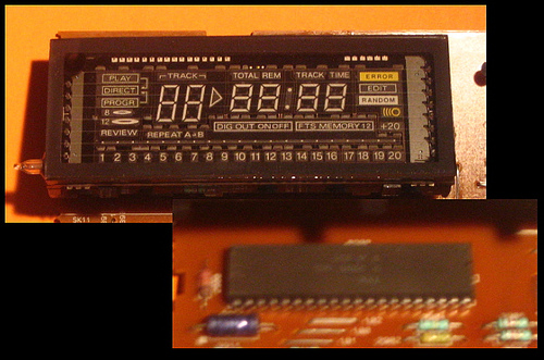

TFK U3090 (U3090MK) for Marantz from Telefunken (display driver for Futuba Display FV112) Datasheet still wanted

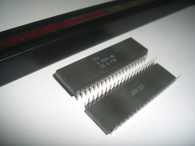

for troubleshooting in a CD player PCD2 (PCD 2) from Proceed I need a data sheet of the 40-pin. dual inline IC "U 3090 MK" from Telefunken Mikroelectronik. The same type also used in some Marantz models from the same aera.

Thank you for this advice. From which supplier you has been order? Perhaps I can ask there for a datasheet.I have 15 pcs of U3090MG in original Telefunken tube pakage. Please do not hesitate to contact me if you need 🙂 !

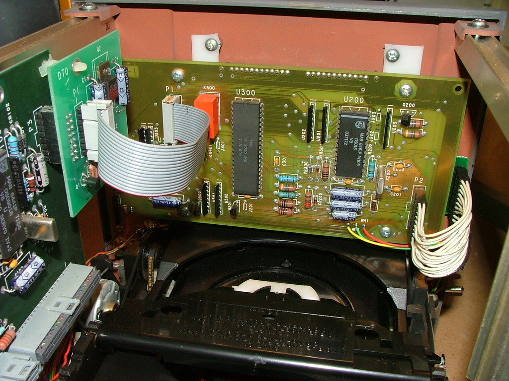

BTW - more images from Proceed's PCD-2 I have upload there:
http://www.diyaudio.com/forums/digital-source/92348-proceed-pcd2-2.html#post2883927

May I revive this thread? I am looking at a friends Proceed PCD2 player.
He tried to mend it himself but put connector P1 in incorrectly causing damage to the display board. My quirey is, I have replaced the U3090MG VFD driver and MAB8461P W105 processor but s.data line is 38 Ohms to ground, this cannot work on I2C bus! It proved to be U3090 has internal resistance pin 30 (S.data) to ground (pin 25)
I obtained from another source replacement U3090 and measured pins 30 to 25 whilst still in its antistatic pad, 38 Ohms again!!
Am I unlucky in getting 2 faulty I/Cs or am I missing something simple here?
See tiefbassuebertr's excellent schematics earlier in this thread.
Greetings! I have the same issue as Mclaren2, the resistance between the data line and ground on U3090MG is around 35 Ohms. Any help would be appreciated.
Hi Chiahead, This gave me a lot of greif, I was repairing a Proceed PCD2 with the advise from the owner to repair it "Whatever it costs"! In the end I bought a philips cd player from ebay that had a U3090MG fitted and believe it or not, it measured 38 ohms to ground on the Data line. However when powered up it all worked!
I hope that this is of help, What unit are you repairing?

Hi Mclaren2, thanks a lot for a prompt reply and useful info, it is indeed helpful. My unit is Marantz CD72. I disconnected the data line and it can play but, of course, no display or control works. Given your experience, the problem must be elsewhere, but where? I am a bit puzzled by how your new unit can work and still have 38 Ohm to ground (0.11 A current through U3090MG?). Have you you been able to fix the unit you have been working on? Have you ended up putting in another U3090MG replacement?
Hi Chiahead, to be clear, the I/C that had 38 ohm to ground works ok. When it's powered up there must be some weird circuitry in it that releases this anomaly. The PCD2 that I worked on was a year or two ago now, yes I did fix it, after changing most of the semis in it. As stated earlier in this thread the customer caused all these problems by fitting a multipole connector in backwards!!
