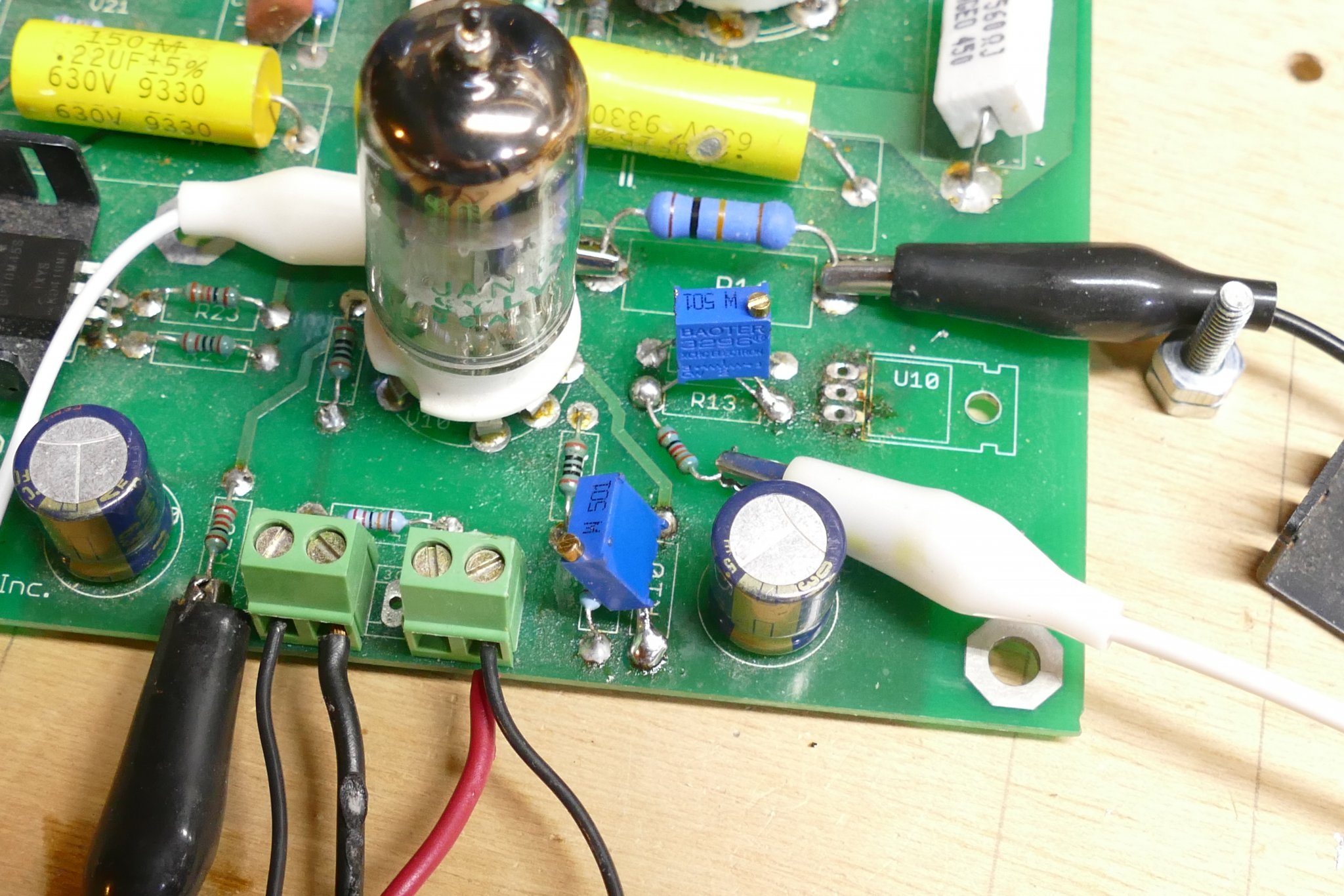

I got SSE board number 1 out of the "box of dead circuits" for some investigating of alternatives to the hard to find IXYX ICP10M45S chip. This board was the first ever SSE board produced by a commercial PC board house, as all SSE's before it were test boards DIYed in my kitchen in 2005. It was built in 2006 and after some testing and use in an amplifier it was swapped out and became my test board for experiments that might not end well. Several traces have been cut and resoldered, the cathode bypass caps on the output tubes both exploded in an experiment gone wrong, and both of the power supply caps have been replaced but I don't remember why, as have many of the other parts. It was last used to test some large transmitter tubes, but that experiment didn't work out, so the board slept in the box since 2009.
I dug the board out of its box, popped in some tubes, wired up a pair of Transcendar 3K ohm OPTs for 6000 ohms in triode mode, connected it to a bench power supply and fired it up. With (expendable) guitar amp quality "Audio Glassic Blues Tubes" 6L6WGB's and a NOS 12AT7WC I get 1.8% THD at 1 watt and around 4% at 4.5 watts. I do not have FFT testing capability at this time. I listened to the old board cranked up to the edge of clipping on the scope (not audible) for 3 CD's just to wake up the old parts before testing. Everything sounded as expected. The OPT's in use do not have UL taps since they were intended for 300B's, so UL was not tested.
Some pictures and data are here, and yes there are alternatives to the 10M45 that are in stock.....for now.

R13 / R23 sets the plate CURRENT and the cathode resistor R10 / R20 sets the plate VOLTAGE. I recently did some experimenting on an SSE and I simply put a 500 ohm pot in place of each resistor and tuned for lowest THD. The tube current can be monitored by placing a voltmeter across R14 / R24. Easch 10 volts equals 1 mA, IE 85 volts is 8.5 mA. The two pots interact to some degree. The plate voltage can be measured directly. Best measured THD does not always coincide with best sound quality, so listen before soldering the final choices in place. Every tube has a different sweet spot, and often the two halves are different. You could leave the trim pots in the amp, but use something of higher quality than the surplus Chinese Bourns clones from MPJA. I find that often best measured or perceived sound quality comes at or over the maximum dissipation rating. I have run some 12AT7's pretty hard at 2.7 to 3 watts each with no issues, but I have lots of spares, so they don't fail. If you only have one, it will die.
