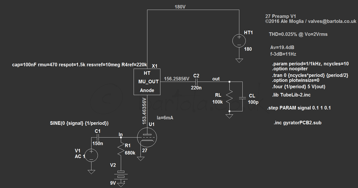

First look at site bartola valves. This is the top in preamplifiers ***
For something simple follow the next schematics

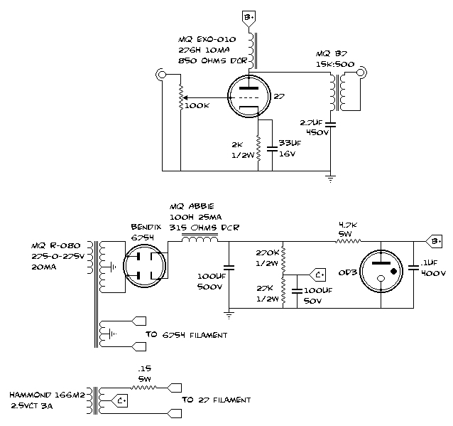

My favorite circuit for low mu triodes is transformer-coupled differential stage biased by common cathode resistor, with common choke between primary CT and B+. There is a number of suitable high quality transformers made by UTC, Triad, Microtran, etc. No semiconductors, no capacitors.

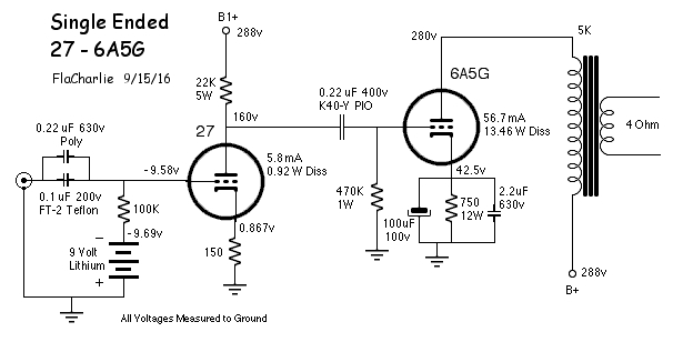

I've never built a preamp with the 27 but I've also been thinking about it for a while. I've also considered using the 37 as an alternative, but only because it uses a 6.3v heater. I use the 27 in this amp I built and I've never had any issues with microphonics but I only use ST shape tubes. I use mesh plate versions which are harder to find in the ST shape but the solid plates sound very nice too.

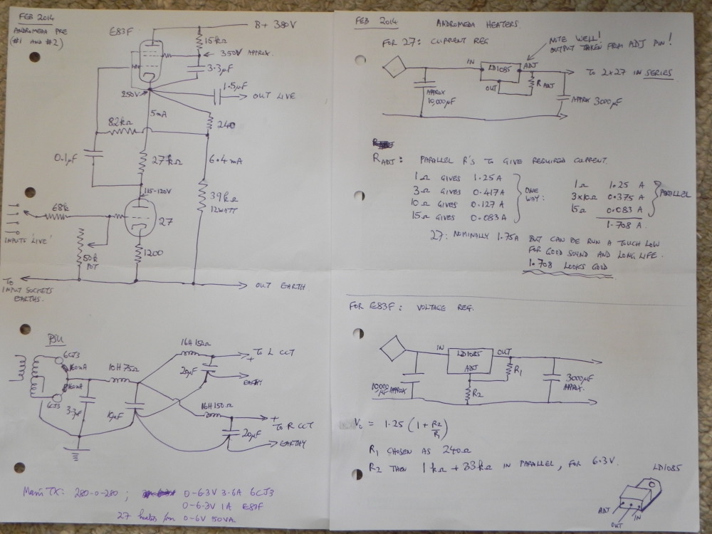

Andromeda 27/E83F mu-Stage preamp
Over in AudioAsylum an inmate named Mike C. developed a preamp based on type 27 tubes which he found very satisfying; best he had heard. I have the tubes and will build it when time allows. Of coarse I have not heard it, but I thought Biwado (OP) and some of you on this thread might like to know about it if you don’t, comment on it and even try it.
He started the journey many years earlier, early 2000s, with an E80CC tube in a Kimmel Mu-Stage configuration with an E83F pentode at the top. After all refinements at the end of his journey it was type 27 he liked best, again with the same Mu-Stage. Strangely, Mike C. never mentioned any issues with 27 tube regarding noise or microphonics that I recall. He did employ a constant current heater supply for the 27, so perhaps that dealt with some of it.
Mike C’s hand-drawn schematic is here:
