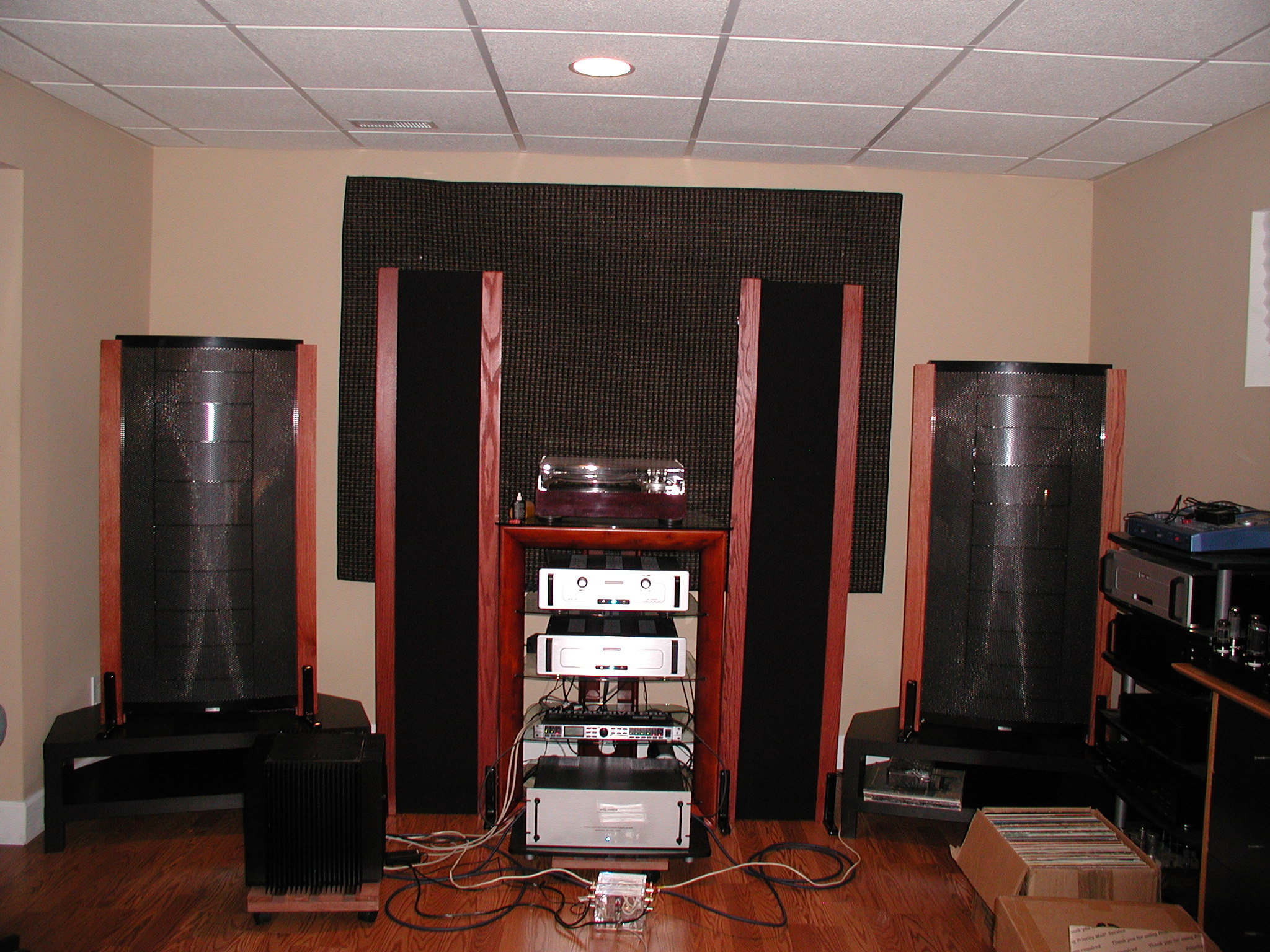

I reconnected all the bad wiring connections on the bad T-1D panel. I used DAP Weldwood to secure the connections...I have been listening to the setup (single T-1D bass panel per channel) for a while and will leave it as is for now...got some fabric and some oak panels from teh local hardware store to dress up the T-1D to match the CLS.
Below is a pic of the setup...I really like this - Magnepan / Martin Logan / ICEpower / Audio Research D-75 all in one...
I am ABx'ing the Krell KSA-50 Clone and the Audio research D-75A amps - the Krell has a bit more gain, but otherwise very close sound wise...
