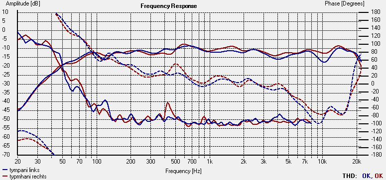

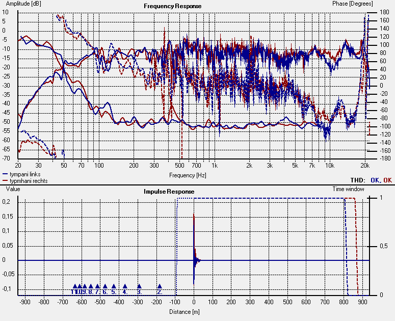

🙂i did a tymp 1d few years back. although i replaced all bass wires by foil. since they where completly gone, and i hated the wires glue crap.
there is a post on here somewhere. the tweeter still worked so i did not open them.
this is how they measured in room.
so foil is another option, for the bass. the tweeter will be hard to find the right foil.
