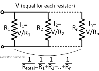

In series, resistances add, so that part is straightforward.
In parallel, the total resistance gets smaller than the smallest individual value. Mathematically it's more complicated than the series case:

The woofer you referenced has dual 2-ohm coils. I can't tell from your post if you are talking about the two coils being in series and/or two woofers being in series also, if you missed the dual voice coil part, or if I'm misreading something.
For the amp scenario you describe in point 3, the load and power are both equivalent (assuming two 2-ohm loads in stereo vs a single 4-ohm load bridged). If you think about the amp outputs as being in series when bridged, you'll see that you basically have 2 ohms + 2 ohms = 4 ohms. And the stereo amp situation you describe is 1600 watts to each of those 2-ohm loads, which is again equivalent to 3200 watts total across a single 4 ohms.
You can get in trouble in bridged mode if you don't pay attention to the impedances though. That's why the amplifier is rated for 2 ohm loads in stereo, but only 4 ohms in bridged mode. A 2-ohm load in bridged mode presents the amplifier with the equivalent of a 1-ohm load in stereo, which is going to make it angry.
