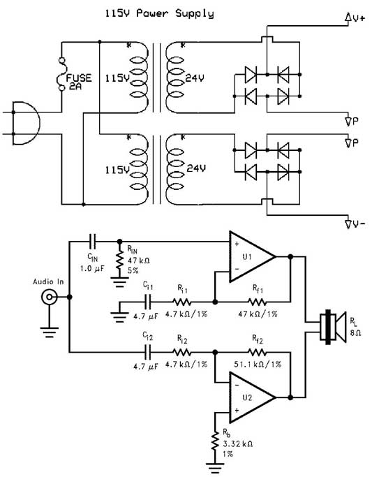

Thanks for the reply Nelson,
Attached is the configuration of the amp/PS I have plagiarized from various sources. The amp is directly from National's application sheet AN1192. I built the PS and amp last night and how should i put it..I solved the PS problem. The amp, which I built verbatim heats up the "smallish" heat sink in about 4 seconds. Toasty. It also has a serious oscillation (motorboating). Starts low hz and increases. I have 2x1000 uF caps for each chip. Anything that jumps out as a potential problem?
David
1000 uF for each rail seems a little too little according to most people. You loose some power if the ripple is too high.
