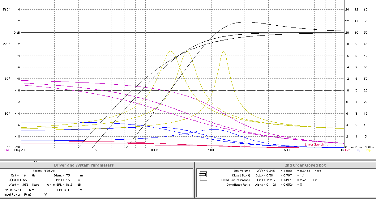

There will be a bandwidth gap between the subs and the sealed FF85wk. Subs usually go up to a max of about 120Hz (or a bit higher). The sealed FF85wk will roll off much higher, thus there's a gap.
So you either have to (a) put the FF85wk in ported cabs, near corners (or at least against the wall) in order to mate with the subs. It won't play really loud.
Or (b) use the FF85wk in sealed boxes, but use woofers (not subs and plate amps) so that you can run up to wherever the FF85wk's bass rolls off (for crossover, you can use a simple first-order series crossover which is just a cap and coil). This will play louder than (a) but because of the nature of sealed cabs, it will roll off gently in the bass, which some people love.
If you don't like those options, and you want "the simplest possible setup" then I would say use a 4-6" driver in a BiB, in corners. No crossover, no plate amps, plentiful bass depending on your room and positioning. There's no perfect solution, but there are many good options.
In a sealed box, Q=0.7 FF85wk rolls off naturally at 150 Hz. Due to the big resonance hump any passive XO will be next to useless. A woofer could be brought in to fill below the natural roll-off. You will be exceursion limited.
We typically XO FF85wk higher than that. They worked bi-amped at 160 Hz 1st order, but were better at 240. Passive XOs usually end up higher.
With the plate amp, you are bi-amping, just now a question of what XOs you are going to use, the plate amp will have one built-in, a cap in front of the tube amp will allow you to get more level out of the FF85.
