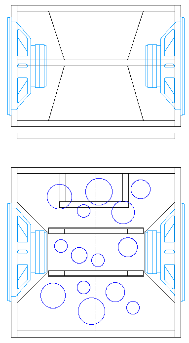

7V said:An advantage of using two bass drivers in one enclosure is that you can mount them push-push to partially cancel the vibrations of the drivers so this is something to bear in mind (Dave, are you out there?).
Yea i was thinkin' bout that before i even read your post... you really need 4 drivers to do it right -- stereo push-push.
Whether a single push-push box or 2 separate units works better is very context sensitive, particularily if the source is the 0.1 output from your HT unit... although you could use the push-push box (assuming drivers acoustically isolated from one another) as L & R subs if you put it in-between and aimed the drivers to the sides.
dave
I thought about doing somthing like this a long time ago, as the base of a coffee table. It never materialized though🙁planet10 said:... although you could use the push-push box (assuming drivers acoustically isolated from one another) as L & R subs if you put it in-between and aimed the drivers to the sides.
dave
Dave, What are the champagne bubbles for in your top view?
To strengthen the inside of the cabinet?
Btw Dave, are the circles spread out in any particular way to let the air flow though more efficiently or are the randomly placed?
roddyama said:Dave, What are the champagne bubbles for in your top view?
Random holes in the push-push brace.
dave

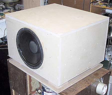

not quite push-push, but 6 ft long:
