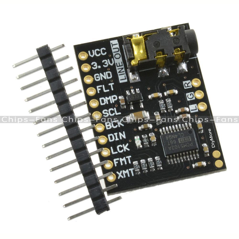

PCM5102A DAC board that has i2S input and runs off 3.3v, no on-board regulation:

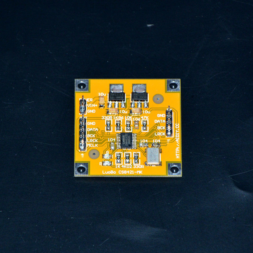

CS8421 sample rate converter board that runs off 5v wth an on-board AMS1117:

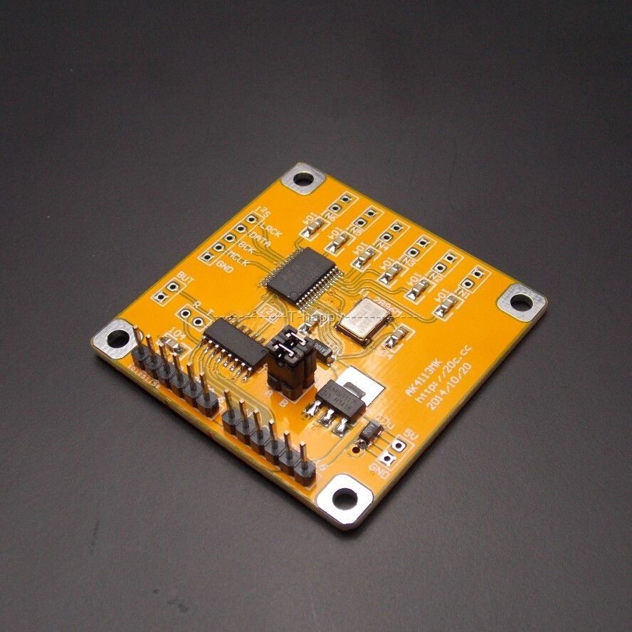

AK4113 SPDIF to I2S board that also runs off 5v and has an on-board AMS1117:

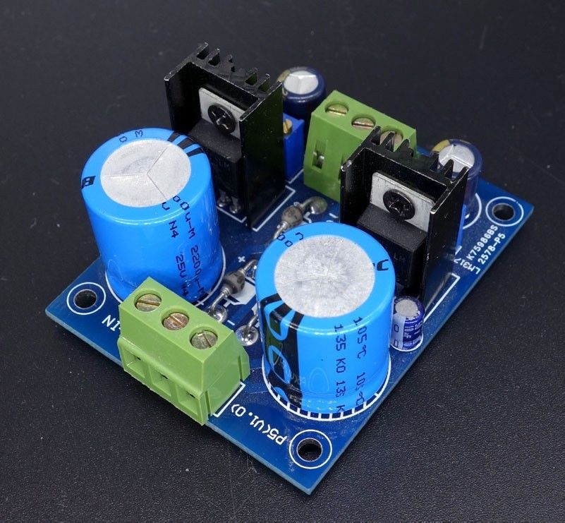

The transformer I have been using has a 9v-0-9v output and I'm running that into a rectifier then a LM317/LM337 regulator board, then a bank of smoothing caps, this gives a 5v supply to the CS4344 board.
I have another, identical transformer so I was thinking of replicating the existing setup with rectifier then LM317/LM337 board and banks of smoothing caps, I already have all the parts to do this.

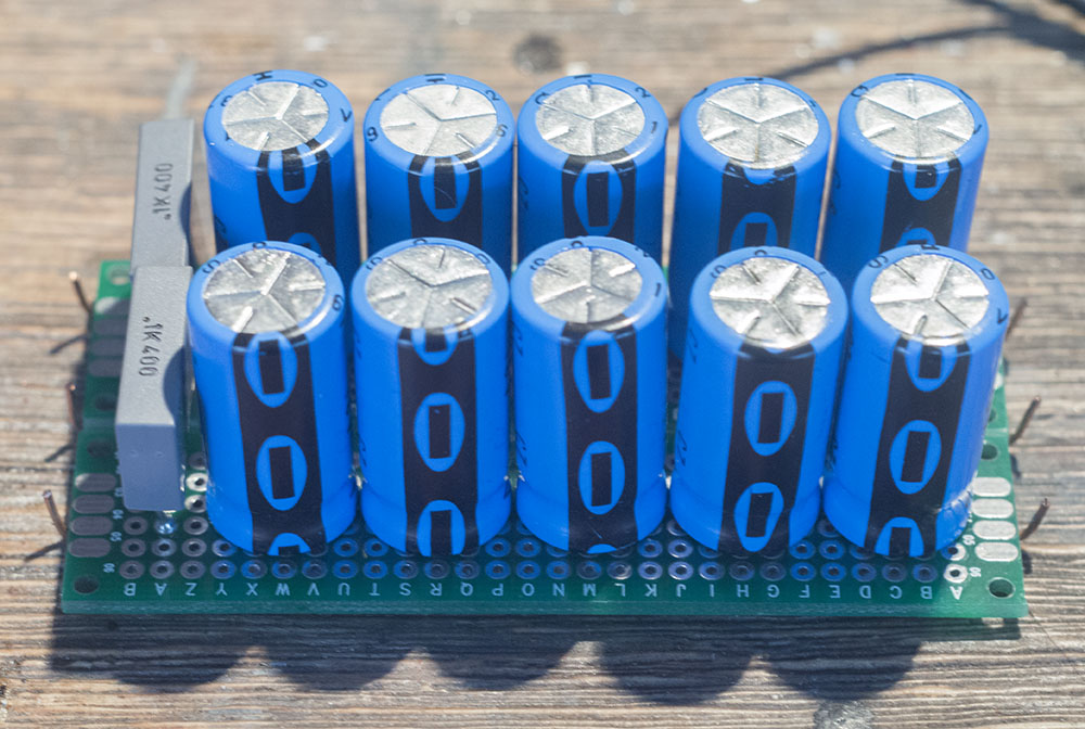

dual cap bank I made from 10 Phillips 16v 2200uF and 2 Epcos 400v 1000pF:
LM317/LM337 regulator with on-board diode bridge rectifier:

Even the PCM5102A DAC board seems to have a "Vcc" terminal, could that be 5V?

The more capacitance you use, the more stress will be on rectifiers and regulators during power on because of inrush current. Maybe the regulators will switch into protection immediately - nothing to win here. Personally I wouldn't use LM317/LM337 for such an application either, but that's kind of taste.

For your needs, the LM317 should do fine. Your caps are probably fine as well. China does not “fake everything”. Most consumer electronics today is made in Asia, often China. It does not mean that such apparatuses are constructed solely from fakes and do not work well. China has got a lot of less known component brands and manufacturers – some quite good, other less good. It is rare, the product pretends to be from a brand known in the western world but is actually a poorly performing copy. The brands in the western world produce a large part of their components in Asia and this is one reason why that market is flooded with components at attractive prices. Also, brands known in the western world sometimes have components made by manufacturers that also supply local brands. Some components may not have been intended to be sold in the western world at least not under that brand, or may have failed in some test, that is another matter. Occasionally, you may run into a regular “scam” as mentioned in a posting, but the big trading sites do what they can to stop such because they do not want to have a doubious reputation.
Use 2x2200uF after the rectifier and one 2200uF at the +5V output, before the 5V-to-3.3V converter. That should be more than enough.
