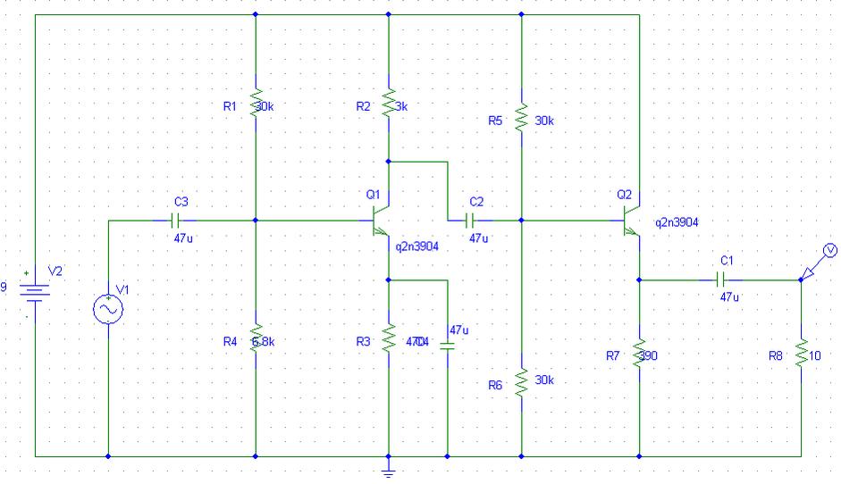

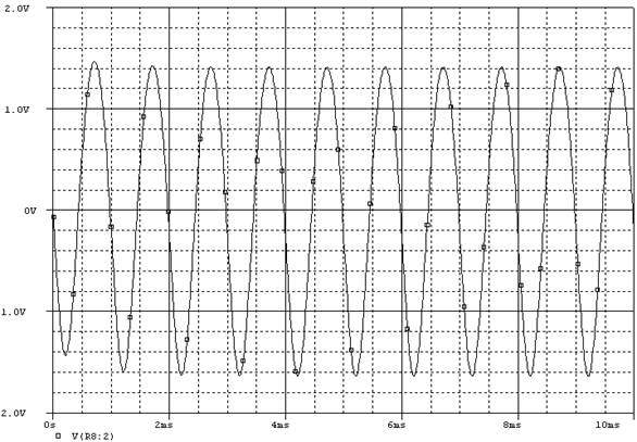

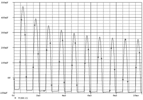

I am building a simple two stage amp that consists of a CE stage followed by a CC state. When the load is sufficiently high i.e. 1k, the output it a clean sine wave. However, for a 10 ohm load or a speaker load of 8 ohms, the output gets clipped off at the bottom. I have attached a schematic and plot of the simulation. The simulation matches what is actually happening on my breadboard testing.
Notice in the simulation plot, the bottom of the sine wave gets clippped for a 10 ohm load. However, at the input to the CC stage, the wave looks clean. So the CC stage is distorting the output. Anyone know why this is happening and any suggestion of how to fix it?

It is happening because a common collector stage that is called an emitter follower may be viewed as a diode linearized by feedback. For the upper half-period your transistor delivers current to the load; but for the lower half-period of the sine the resistor in it's emitter delivers the current to the load.
Now, what do you need to change to get higher negative current delivered to the load?

The output of your amp is grossly mismatched to the load.
You need to lower the output impedance of the final stage.
Ok so when the current through the 10 ohm resistor into the emitter equals the dc bias current, the transistor cuts off right, thereby clipping the negative half cycle?
Is this why people go with a push-pull output stage instead of the single-ended design?
Clearly said Anatoliy.
How about this: this output stage (emitter follower) is a class A stage. Therefore, it can only deliver non-clipped signal at 2*quiescent current, which I think is about 3.9V/390ohms *2 is about 20mA into 10 ohms which in turn is about .2V peak-peak. So any signal above that causes clipping because even if the transistor completely closes up, the emitter resistor cannot sink more current.
Solution: increase the standing current by decreasing Re. But watch the heat in that emitter follower!
Or go to a push-pull stage in class AB/B as mentioned. Then you have two transistors that can take turns in sourcing and sinking to arbitrary amounts of current (within reason).

I have noticed another problem as well. When the Rload is 1k, the output for the positive half cycle is much higher than it is for the 10 ohm load. Why is this? For example, for the 1k load, I get a positive peak of just over 1v but for the 10 ohm load, I get only like 200mV peak. It drops to 1/5th of the voltage of the larger load.

I think it also has to do with the gain on the CC stage dropping also right? For the 10ohm load the gain A=10/(10+rm+R looking through emitter). rm and the resistance looking through the emitter are small compared to 1k so the gain is about 1(i.e. 1000/(1000 + small) is 1). But for 10 ohms, they are substancial right?

The issue is that the 10 Ohm load represents a burden on the output. For a particular signal (voltage) level the current draw from the amplifier will be much higher for a low resistance load. This current has to flow through the internal resistances of the amplifier output stage. If this internal resistance is high, there will be a voltage drop across it and your signal will be diminished.
Have a look at this: http://en.wikipedia.org/wiki/Maximum_power_theorem
The design you have is a good learning tool, but it's not optimal as an amplifier. A resistive load for a single ended Class A amplifier is the worse possible option in terms of power efficiency. You would be better to 'invest' in an additional transistor configured as a current source in place of the load resistor. There is much you can read on this topic.
Your original design is basically useless.
You need to start again with yoru design specification and work from there.
Your taking the wrong circuit and tyring to make it fit and that is the wrong approach to design.
