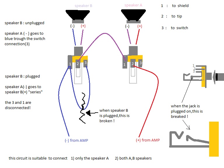

hello to all...i have a big trouble with two 8 ohm speaker that i lined in series
in a parallel way, they play !
in series one play ,the other does not play...

Check your wiring, or post photos if you like. Something has gone wrong.
Impossible?
In parallel they play, and in series they do not? Sounds like one of them is open. In parallel the good one makes all the sound, in series the open one breaks the circuit so neither sounds.
test each speaker individually.
if it is burned, how can it play when in parallel?

As defined in the OP, its impossible, so some mistake, like a short.
rgds, sreten.
rgds, sreten.
If both play when in one connection style, then that proves that neither driver is faulty.
If one becomes silent in the other connection style, then that proves the builder has made a connection error !!!!!!!!!!!!!!!!!!!!!!!!
Ah, the missing piece of information. You don't simply have two speakers wired in series or parallel, you have a jack switching arrangement that is intended to do that.
