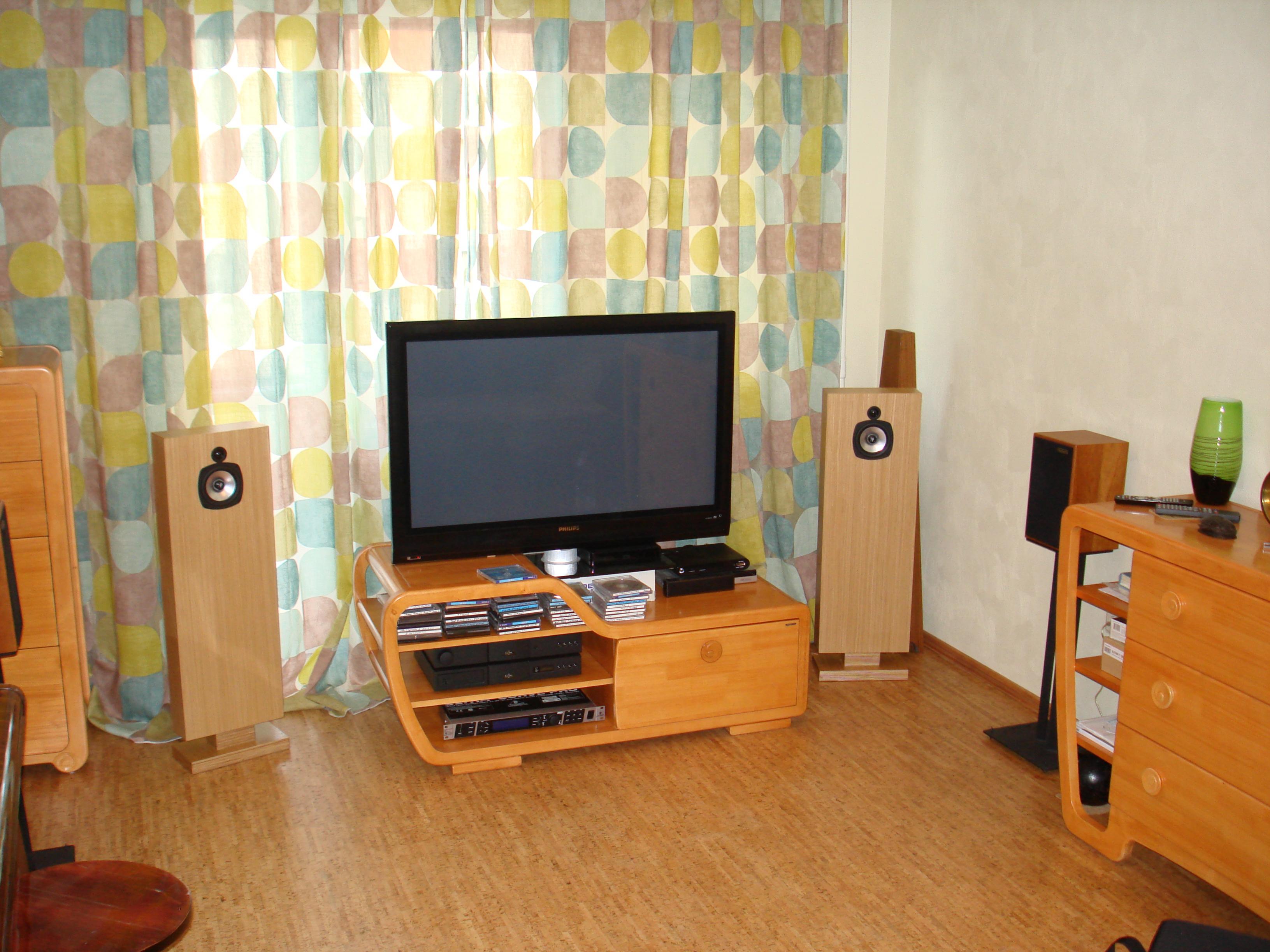

I bought the EIKONA's drivers as soon as they become available in Europe (hifisound.de). As soon as they arrived, put them in 6L closed boxes and get not bad first impressions. Now they look's like this. How do they sound? Comparing with what? They have a natural sound balance - very similar to my Harbeth P3ESR. The bass is not so fast as with FH3 Alpair7, but they nicely fills this 100=500Hz hole which I alwais feel missing with other driver/enclosure combination (FH3, MarKen7, Metronome Fostex FE108Sigma, BR Alpair10.2). The high's - as you see, I add a helper tweeter with 2 order crossover at 9 kHz. May be it just because of my hearing which drops rapidly somwhere after 13 kHz. 3D - not the best which I heard (the king of 3D were my MarKen with Alpair7, IMO), but good enought. The sound is reproduced like a large oval filling the space between the speakers and rarely goes to the left or right side from the speakers. Microdinamic - everythig is there, but details do not grab your attention - speakers just allow you to listen the main event - the music. Sibilance region - very soft and natural - better then Alpair7 IMO. Concluding, these speakers invite you listen to the music, not the sounds. In my case (I mainly listen to jazz, instrumentals, some classics, girl and guitar...) they are good enought to stay at least a couple of years. Thak You for reading.

Hi Colin, sure You will get a good result. My first impression with 6L closed box was that I do not need more hi-freq content. But in VTL the things changes - may be because of the VTL wide baffle which radically affects the overall tonal balance. Are Yours P3 enclosures made of mdf, like mine, or from plywood?
