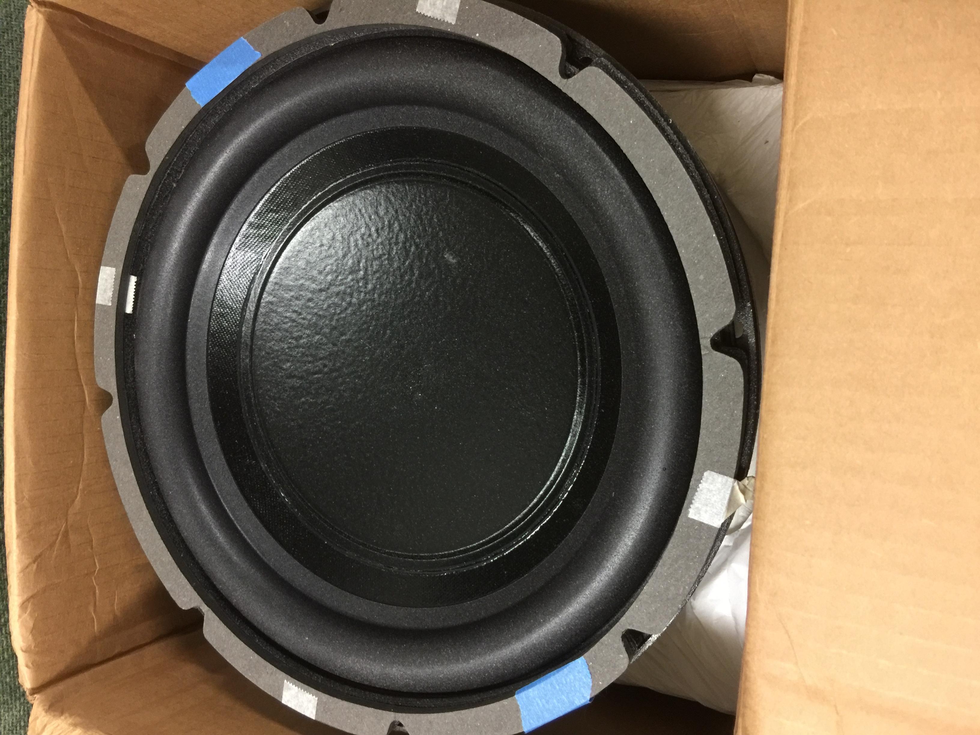

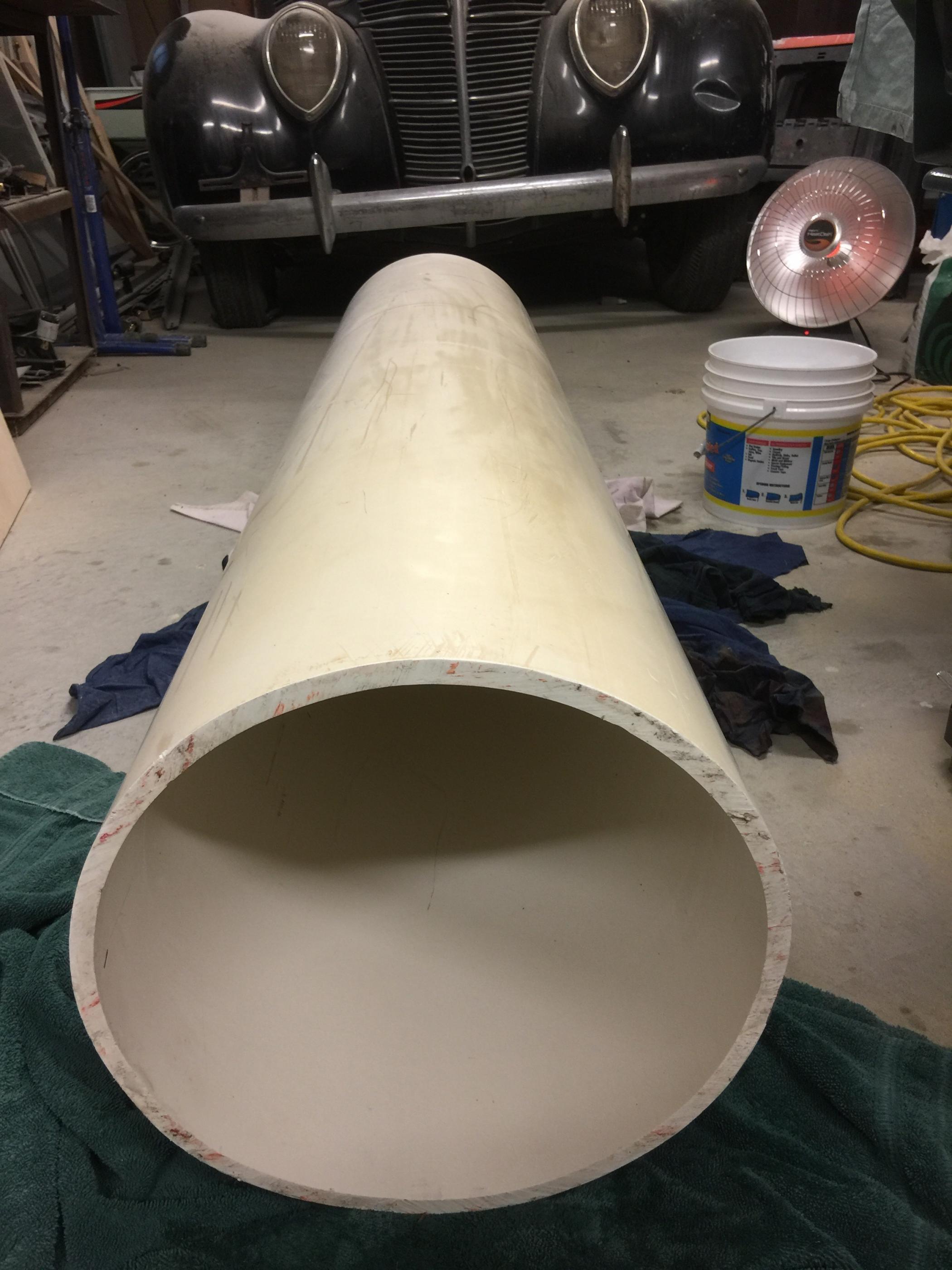

A while back I purchased 2 LAB12s, because they seemed to be versatile and well made. They could be used in closed box, bass reflex, T-line, horns and more. I didn't really have a direction for this project, until I picked up this piece of PVC pipe that was being thrown away. Can't beat free!

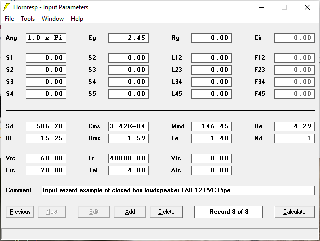

The PVC pipe is 13 inch diameter x 5 feet. First I simulated a closed box then a bass reflex using Hornresp. The closed box with a driver mounted on each end looked pretty good. I think the Qtc=.69. I'm not sure how to add pictures in the middle of my post, so I will attach them at the bottom. I will post the BR images later.

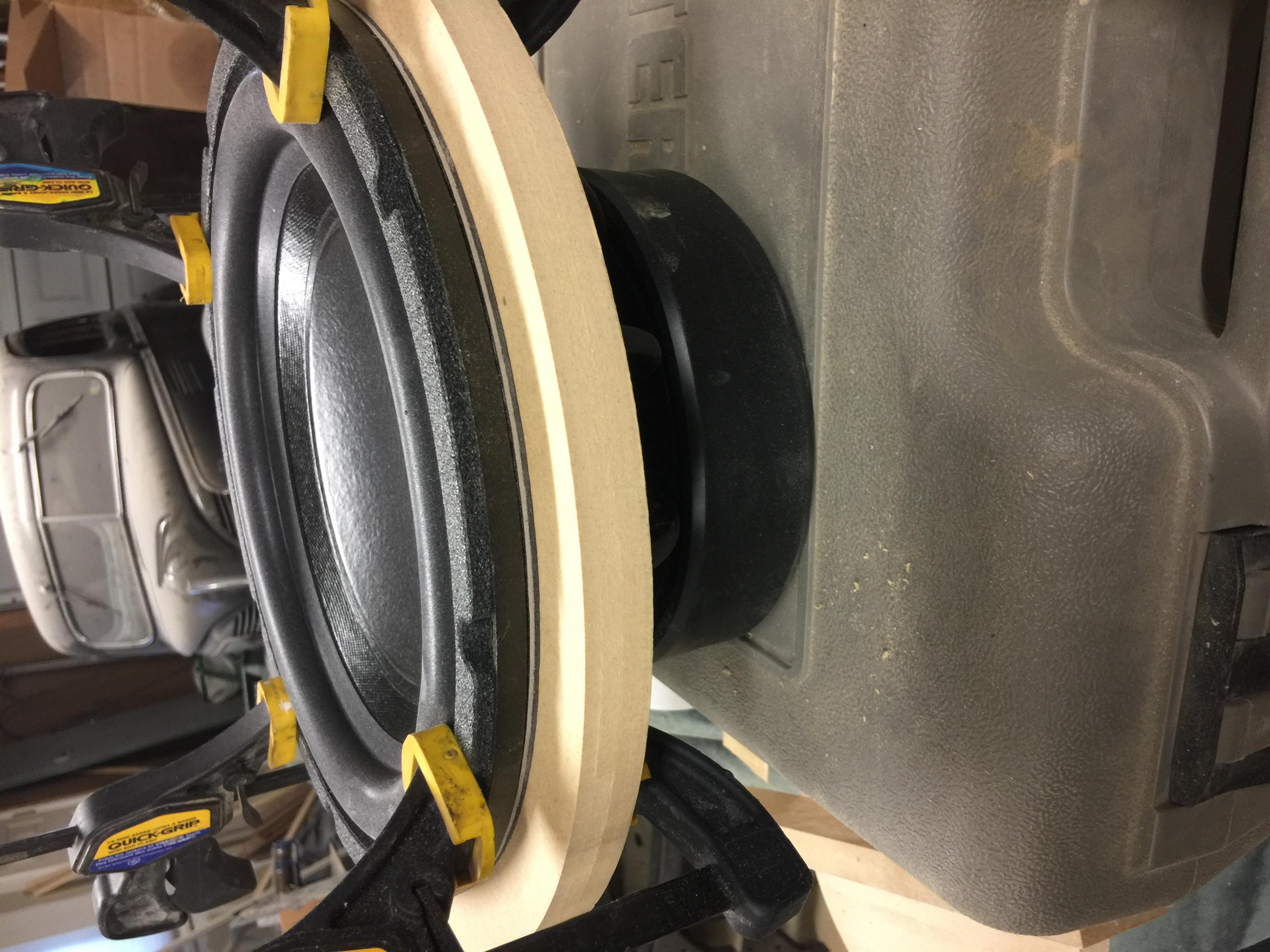

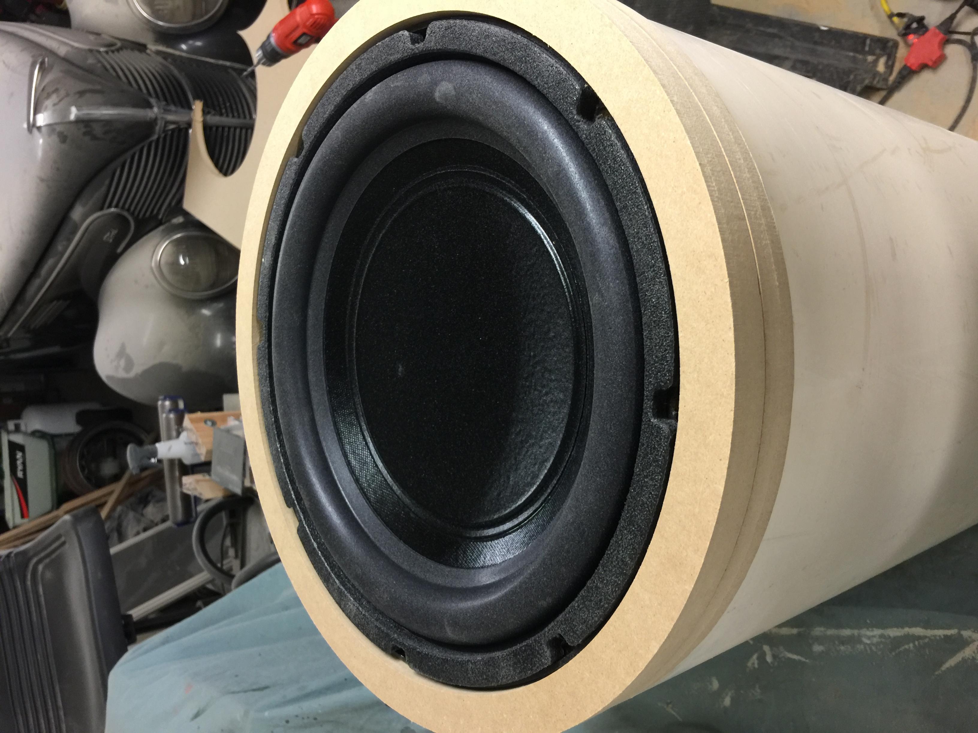

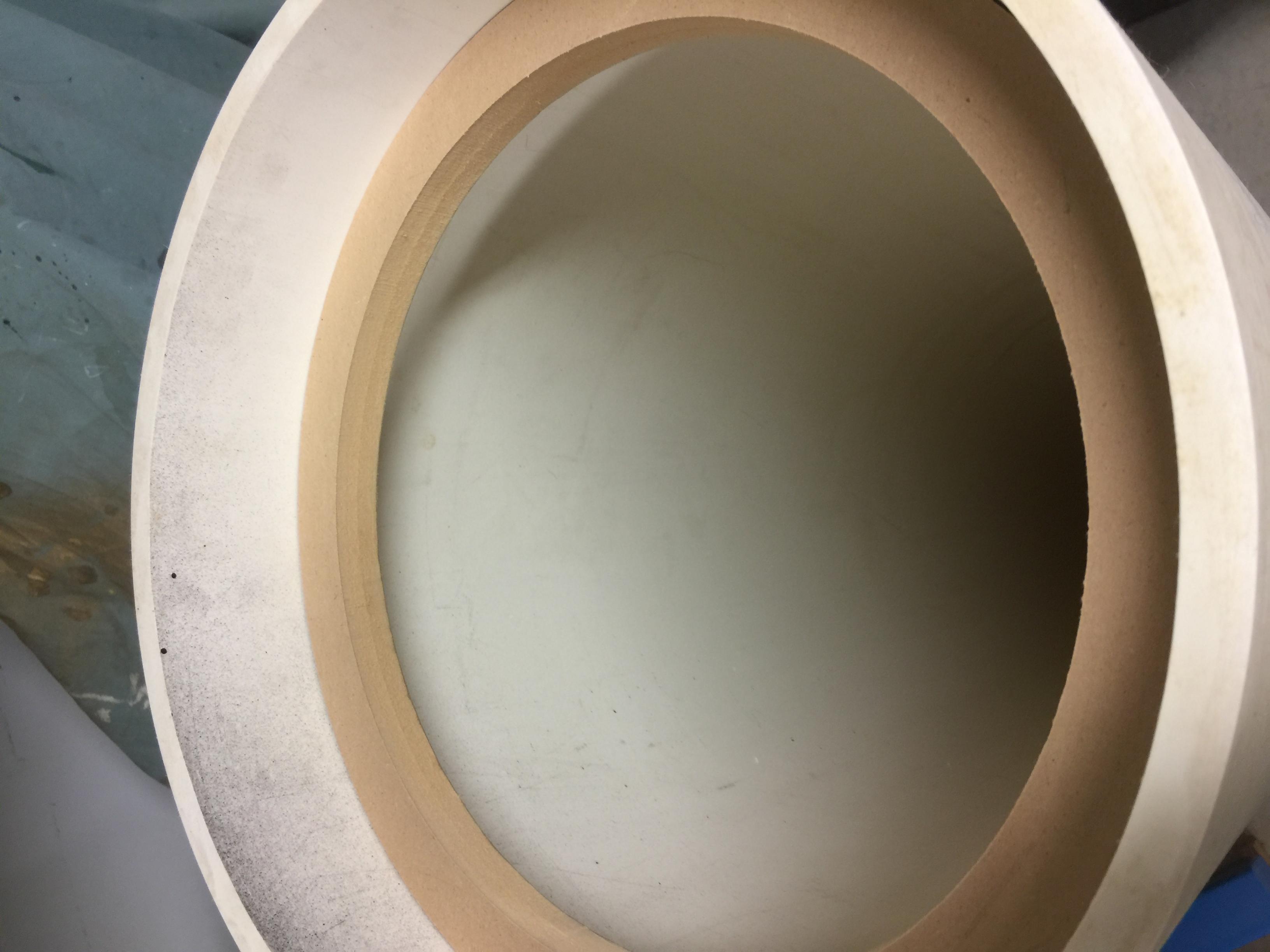

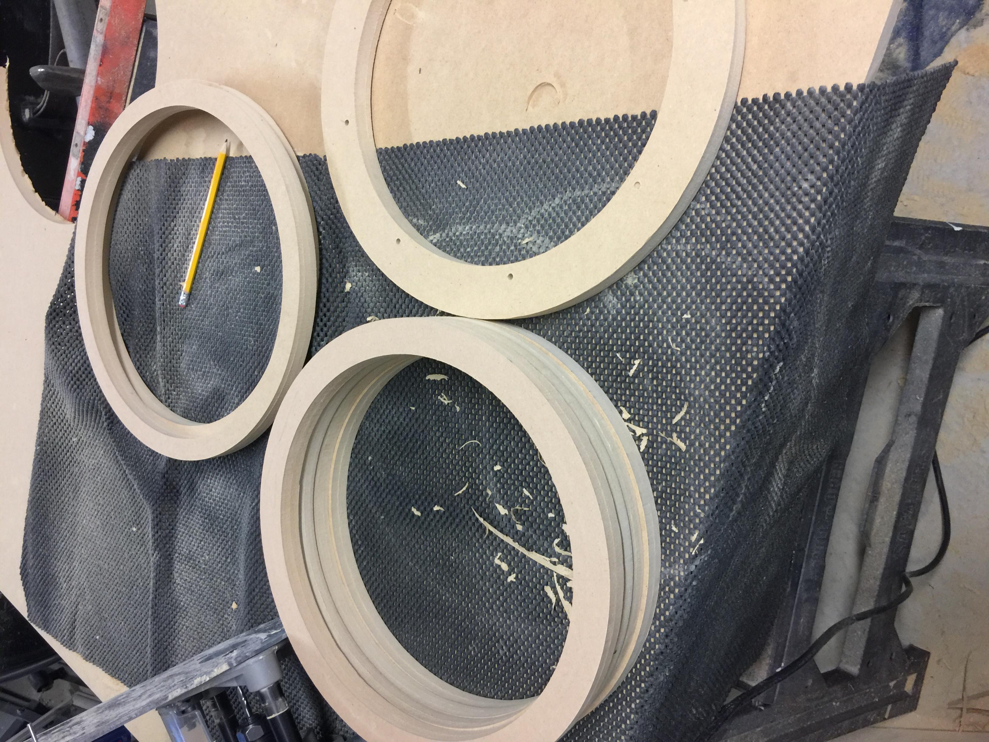

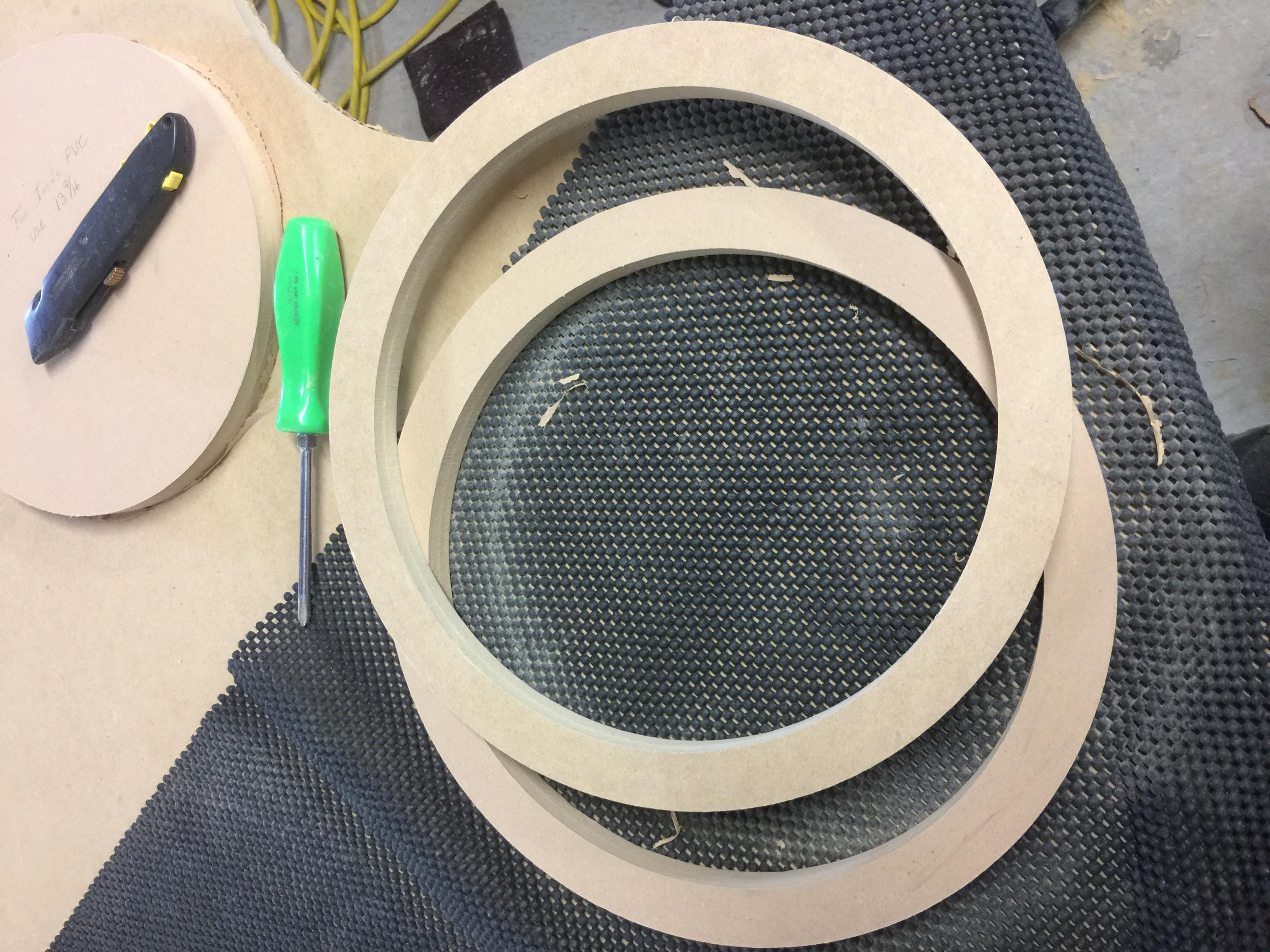

I figured I would build it sealed first and listen to it for awhile before going ported. So I started cutting rings out of some MDF that I had on hand. I used a router and a Jasper jig to cut them out. I cut two rings for each side that fits inside the pipe, one ring that overlaps the end, and one ring to give the driver a flush mounted look. I used 10-24 hex head screws and T-nuts. Glued the T-nuts using gorilla glue, then chased the threads with a tap. Glued the rings together using wood glue. Then glued the rings to each end using gorilla glue.
I will split the post up so maybe it will make more sense with the pictures.

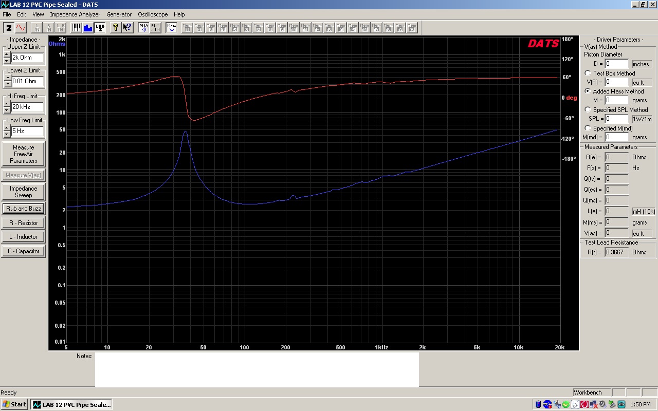

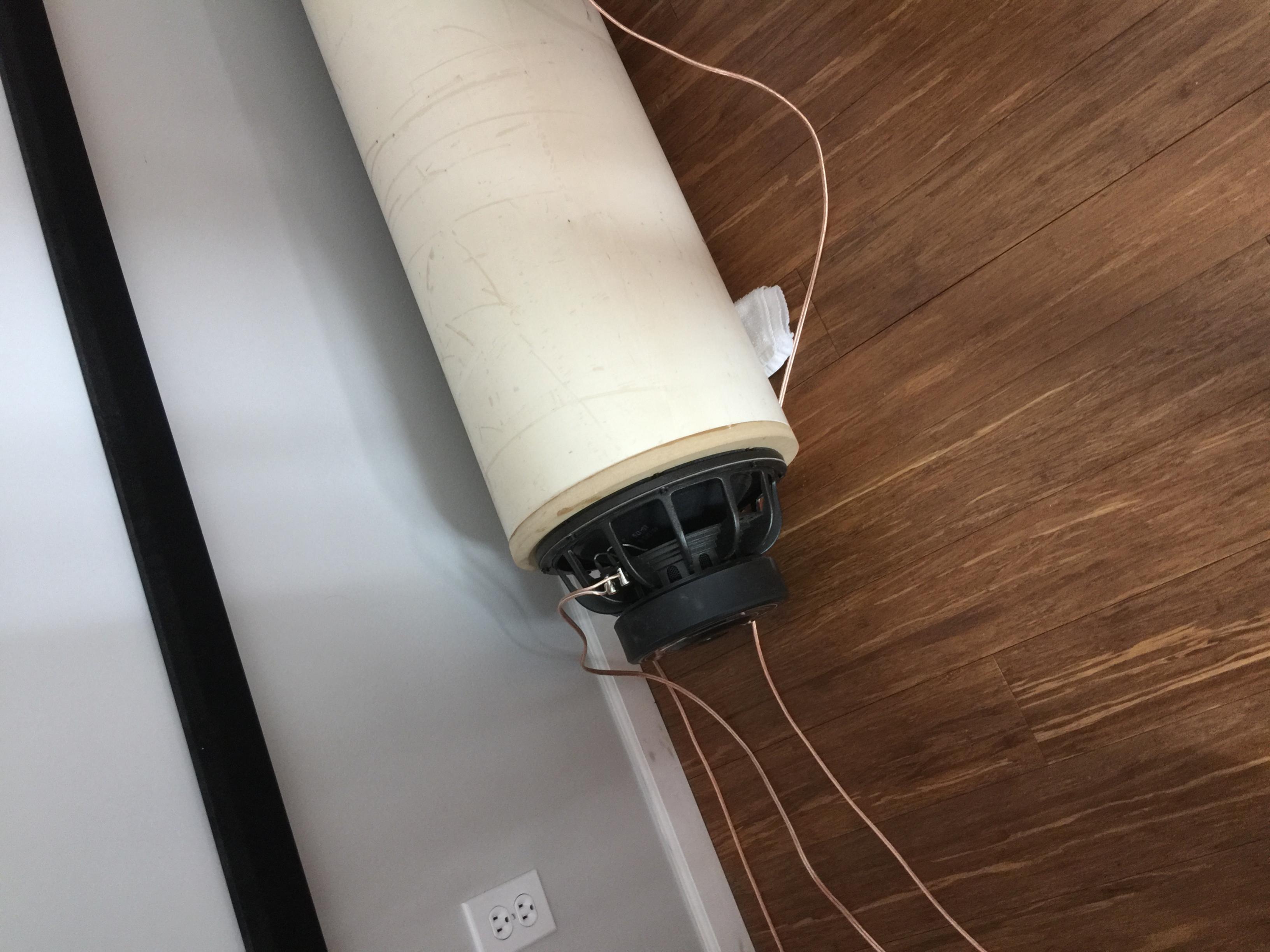

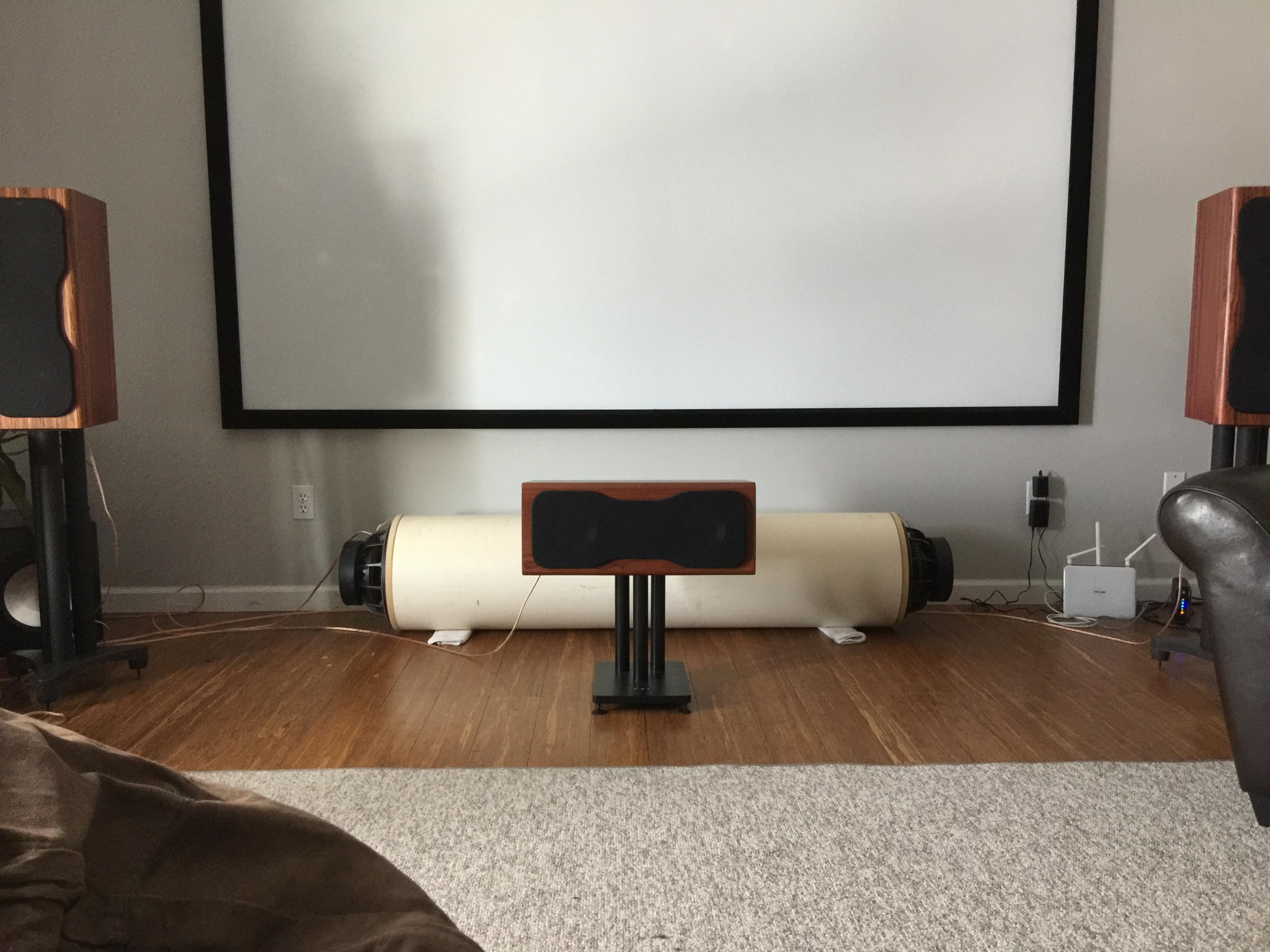

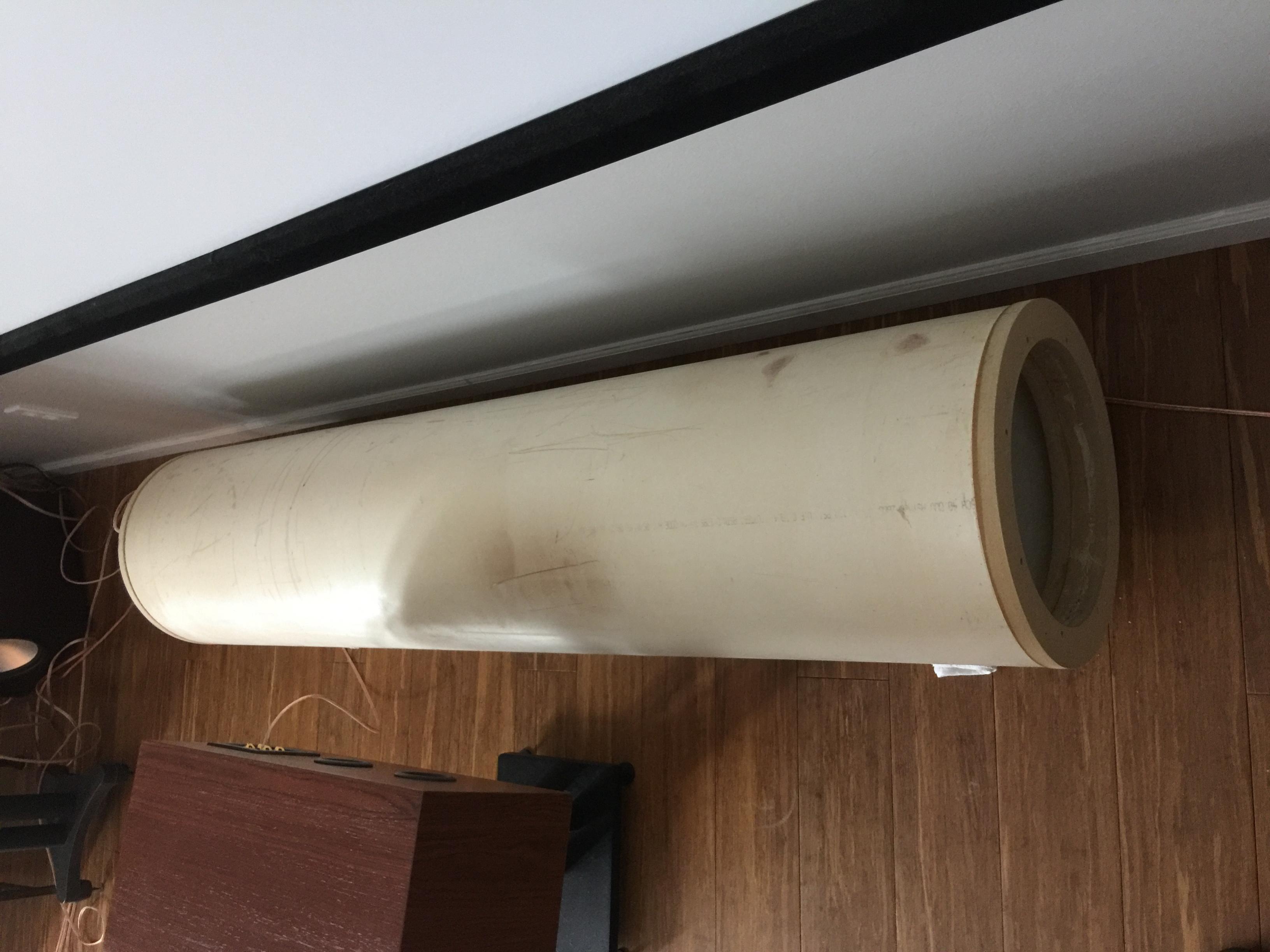

So I asked my wife for some help getting this thing in the house, and she did, so I think she is okay with it.🙂 I put it at the front of the room, where I intend it to go when I'm finished. I was able to do impedance and frequency sweeps using DATS and REW. And here are some more pictures.
Matt

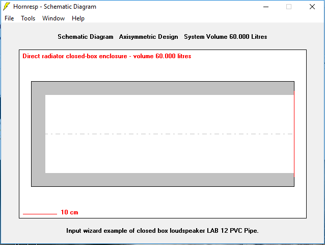

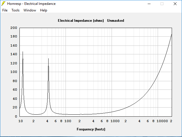

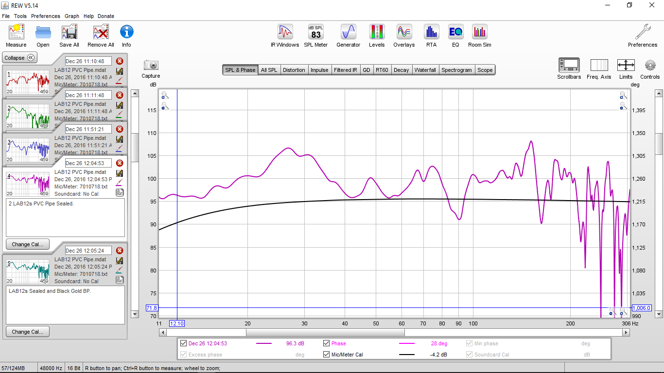

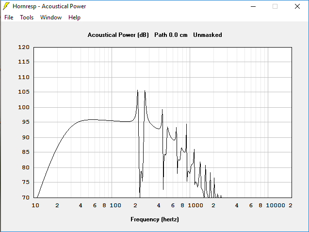

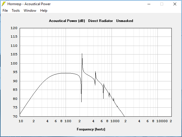

Here are the Hornresp, DATS, and REW images. Hornresp is pretty amazing it even shows the increase in impedance at about 225hz same as what the DATS measured.
I only simed one driver so the enclosure volume is halved. Hornresp is new to me, so if anyone has any comments or questions please don't hesitate to let me know.
The REW image is with the mic at my seated position and the sub at the front of the room. No other subs are on and no EQ.
Matt

Really cool sub build,
Even cooler wife--a keeper for sure. Plan on wrapping something around the tube, the greatness of tubes is they are so easy to finish!
Nice job and am looking forward to your readings.
Thanks. And yes she is a keeper. I plan on painting it. I have access to a spray both at a auto body shop. As far as color, I'm leaning toward white pearl, but that changes daily.
Matt

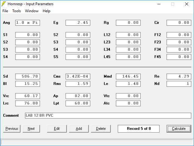

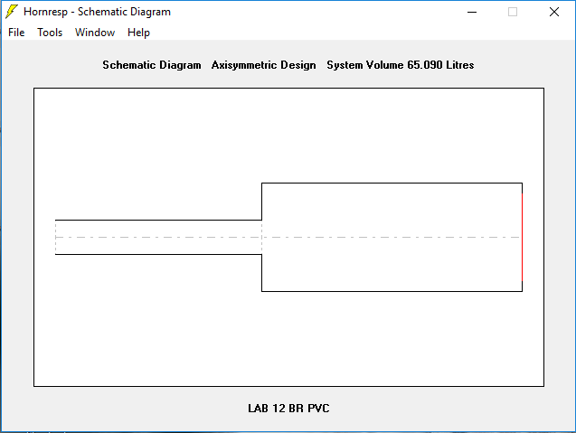

I have been listening to the LAB12s sealed for about a week and I like the way they sound, but I think its time to try them in a bass reflex. I am running 2 other bass reflex subwoofers and a large sealed rear chamber bandpass subwoofer in the room currently.
In the sim I used only one driver and one 4" port. In reality two drivers and two 4" ports will be used. I should mention that when I'm done the drivers will be mounted with the cones out.
I picked up the 4" PVC pipe and 90s for the ports, so I guess it's time for the sub to go back out to the garage. I hope my helper is ready for more lifting.😀
Matt

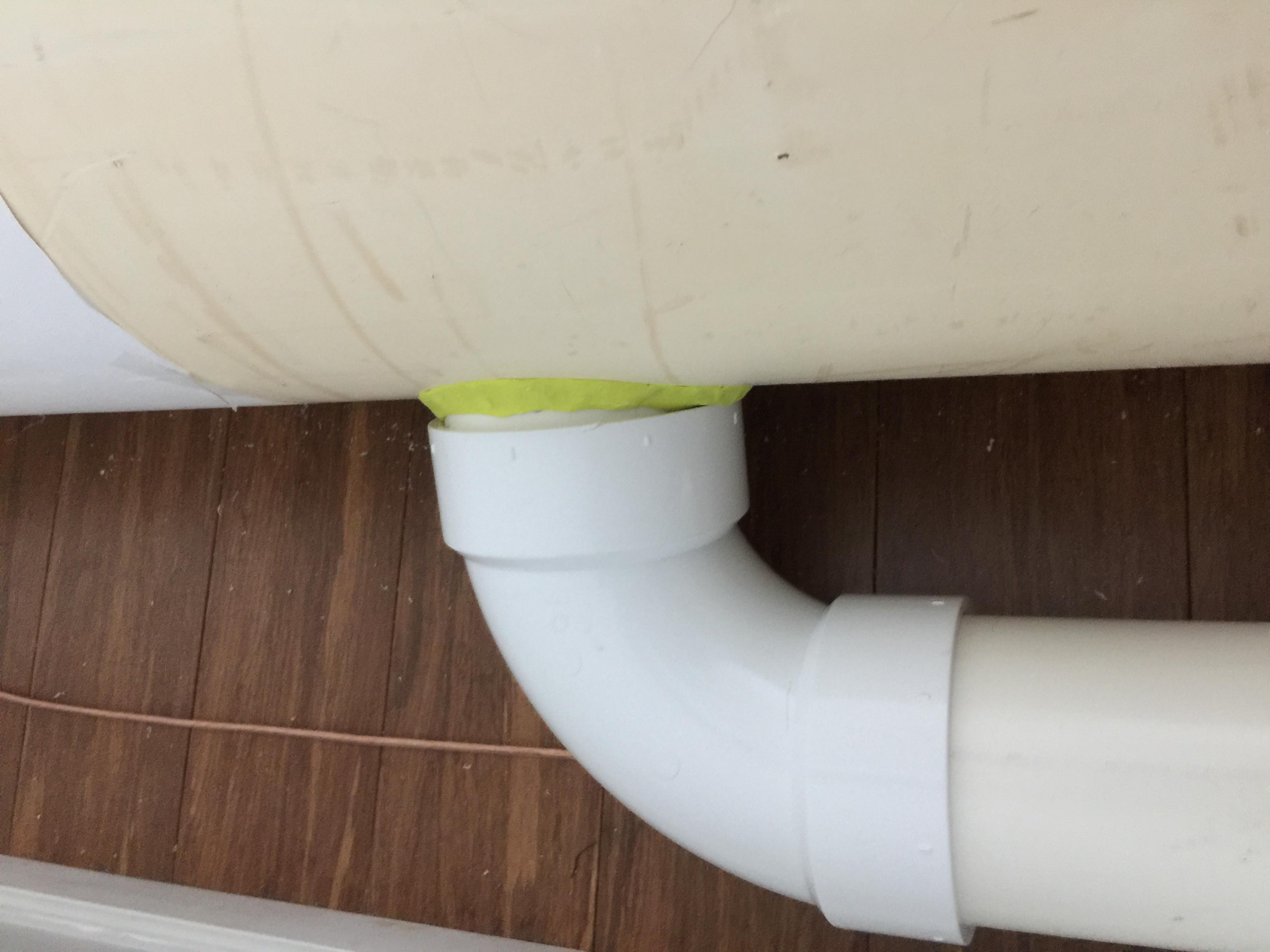

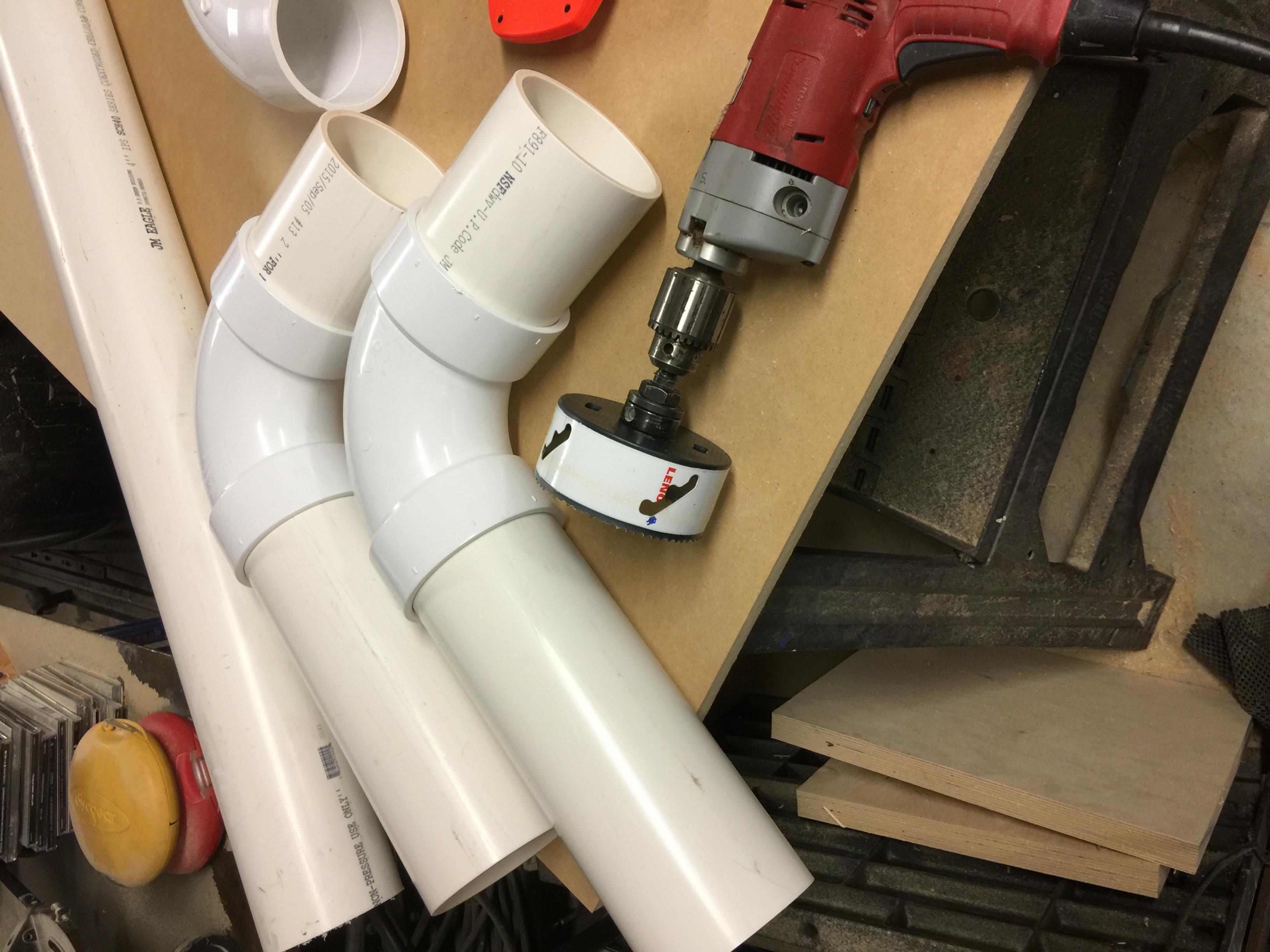

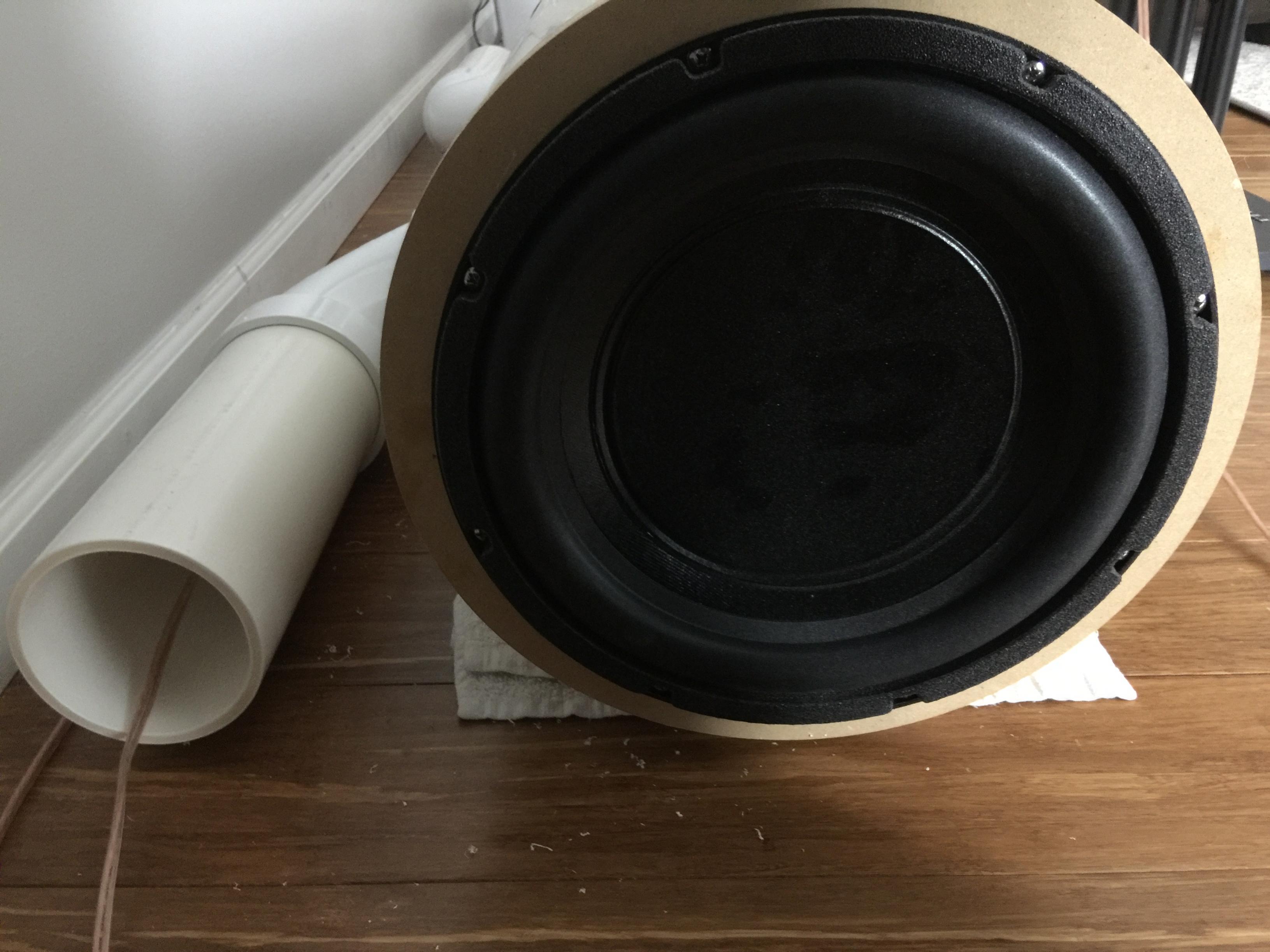

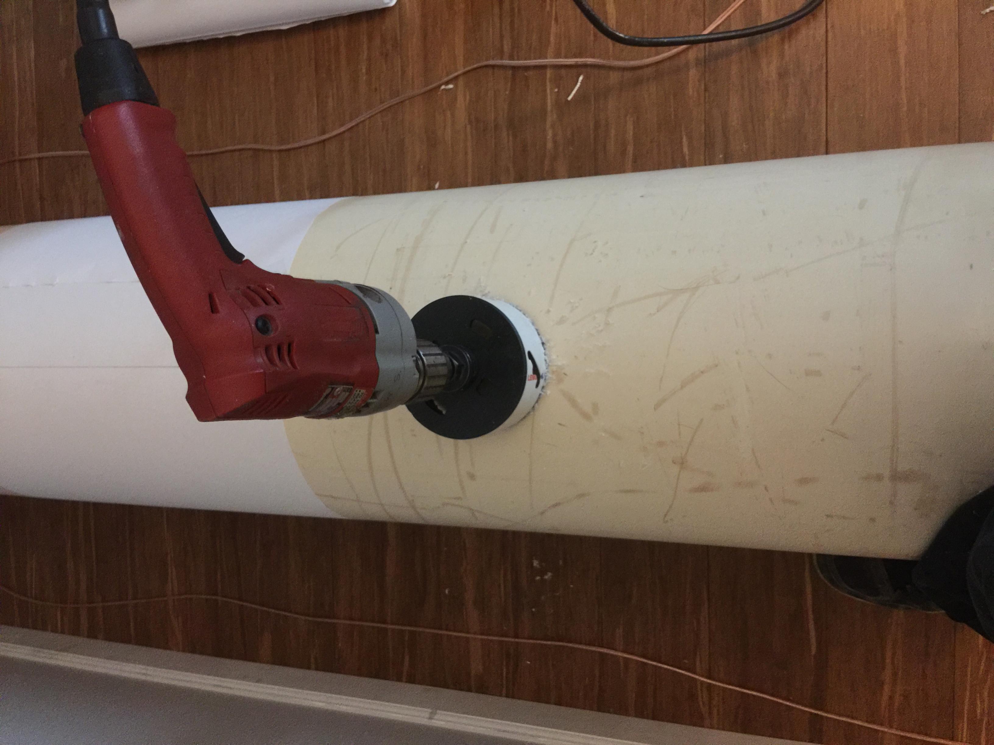

A little more progress has been made with this project, so thought I would post more pictures. This week I cut the holes for the ports, added some stuffing in the middle of the pipe, and cut the ports to length.
It was too cold in the garage, so I decided to cut the holes in place. The outside diameter of the 4" pvc is 4.5", so I picked up a 4.5" hole saw to cut the holes. Cutting the holes was much harder than I anticipated, what a pain. I used a 12" mitre saw to cut the pvc to length. I started with a longer port length, then cut 1" off at a time, then checking each time with an impedance sweep. I used some modeling clay to temporarily seal the port to the pipe for testing. There is a little more fine tuning needed before I start on the finish. So far I am happy with results.
Matt

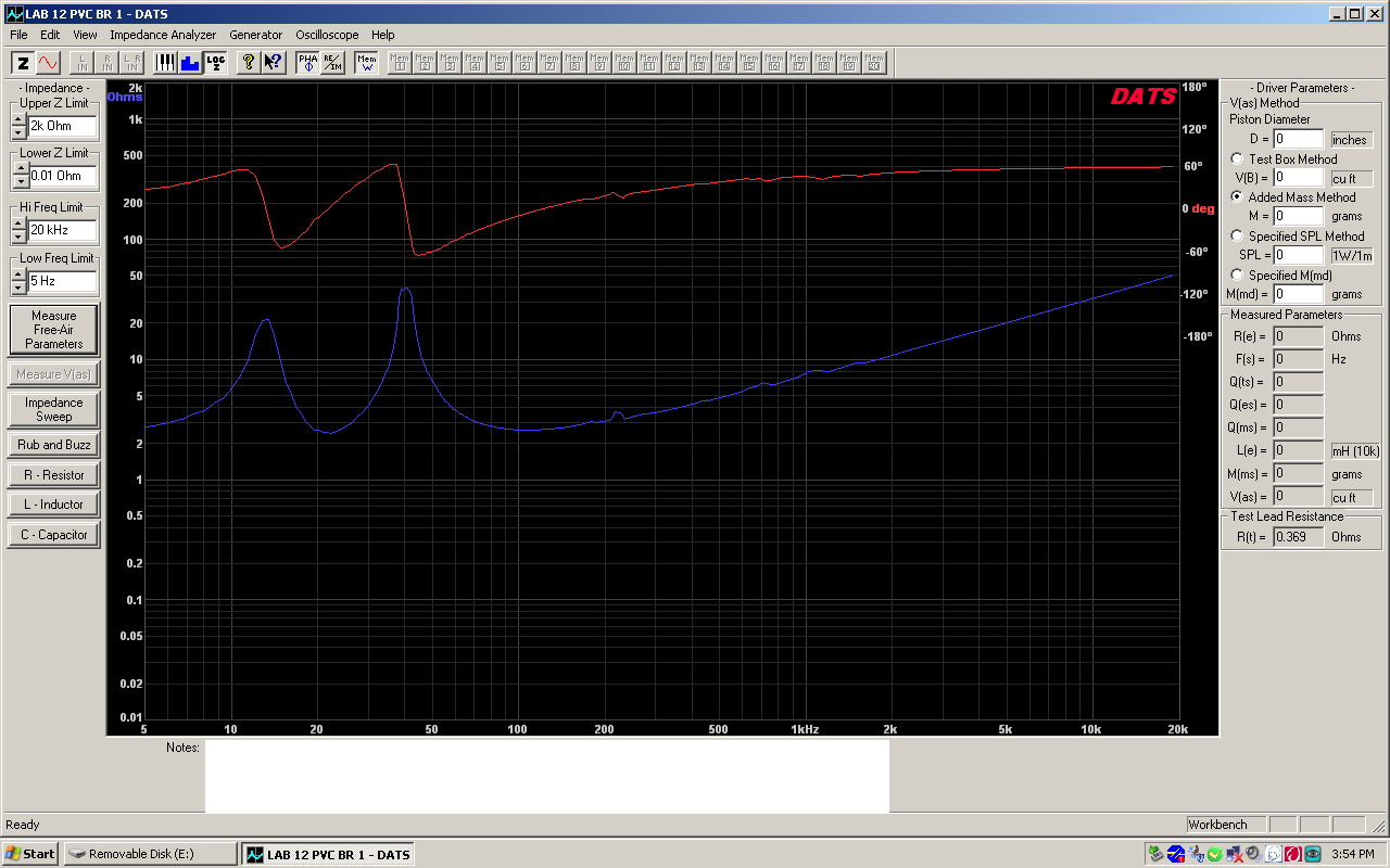

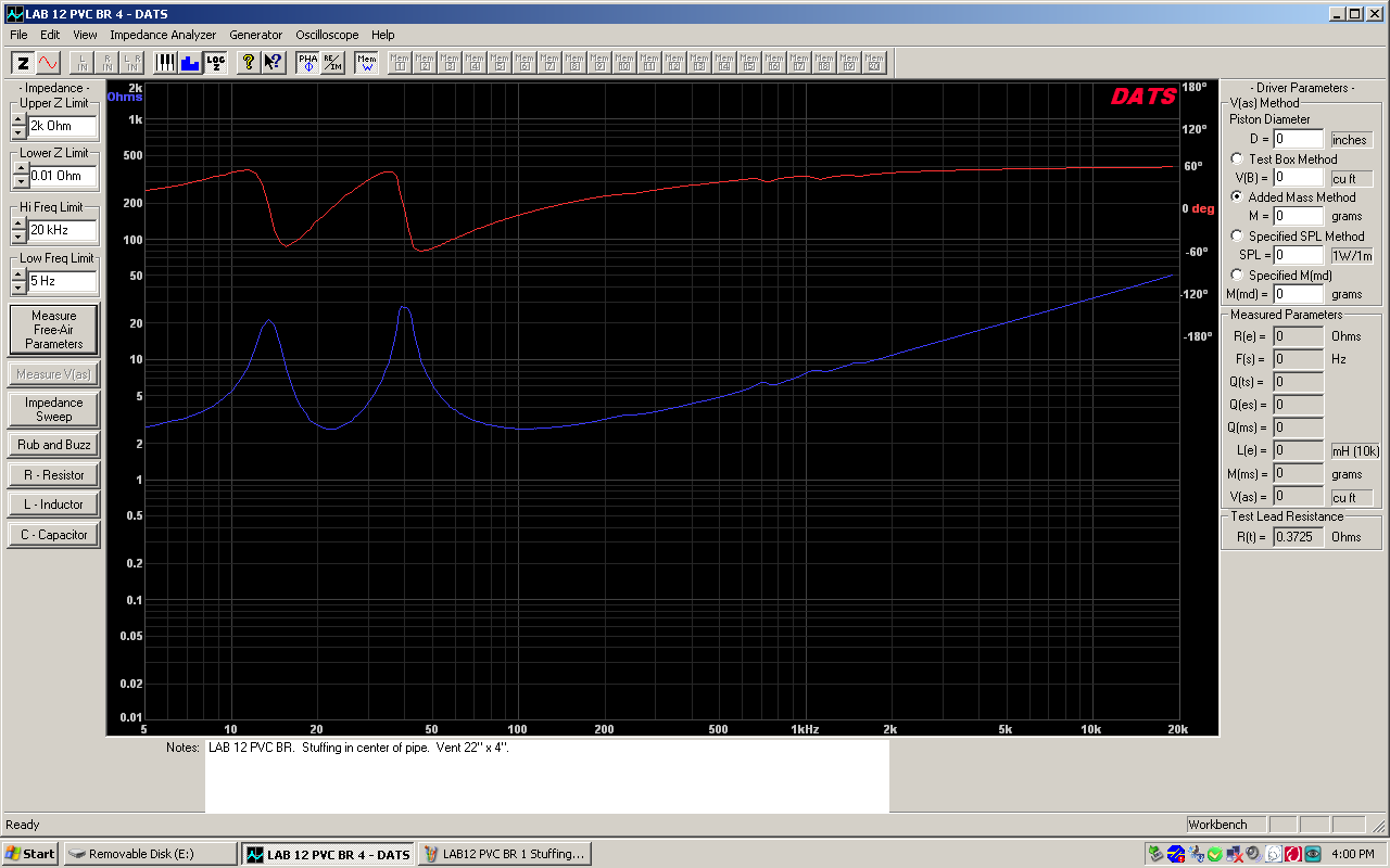

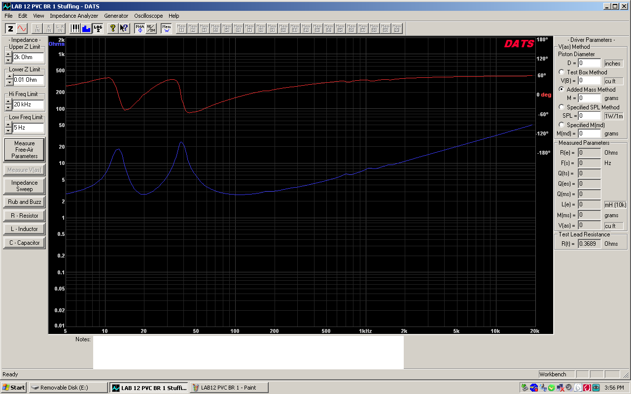

Here are some of the impedance sweeps.
The first image is a sweep with the port length of 25" and no stuffing.
The second image has the same port length, but with about 1.5 pounds of poly fill in the middle of the pipe away from the ports. Notice the tuning and the impedance peaks are lower.
The third image is after cutting 3" off of each port and 1.5 pounds of poly fill. There is still a little more tuning to do. I may cut 1 more inch off of each port to raise the tuning a little.
Matt

Nice. If you finally mount the ports inside the tube, remember to allow for the amount of volume they take up. The tuning will change. Looking at your photos, you could probably leave the ports mounted outside the tube. They'll be hidden behind it.
Thanks for your comments Don. Yes I will leave the ports as shown, on the outside and up against the wall. It's not the prettiest subwoofer, but it sounds good. I'm kind of glad it's too cold to work on it in the garage, because I'm enjoying listening to it.
Matt
