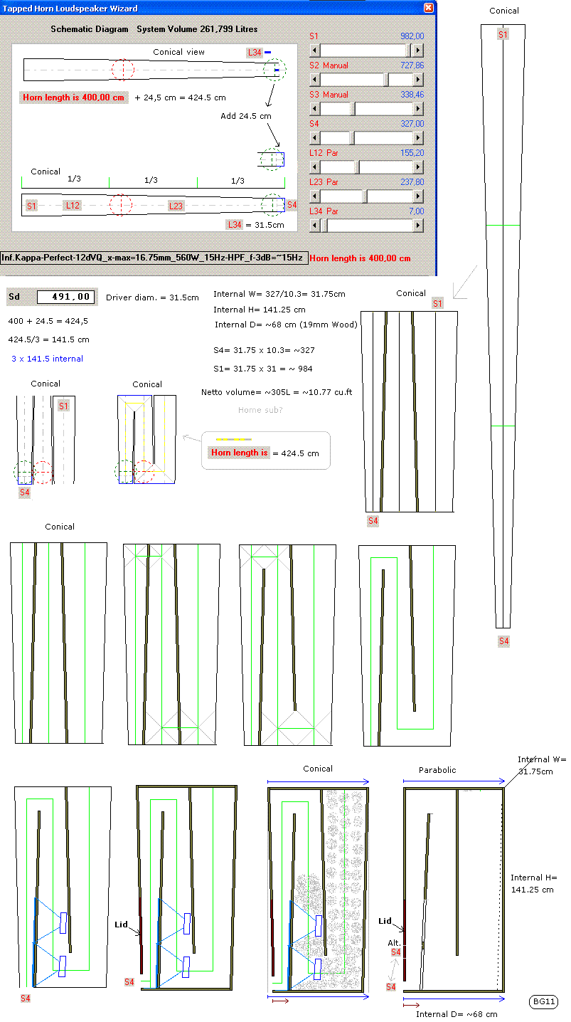

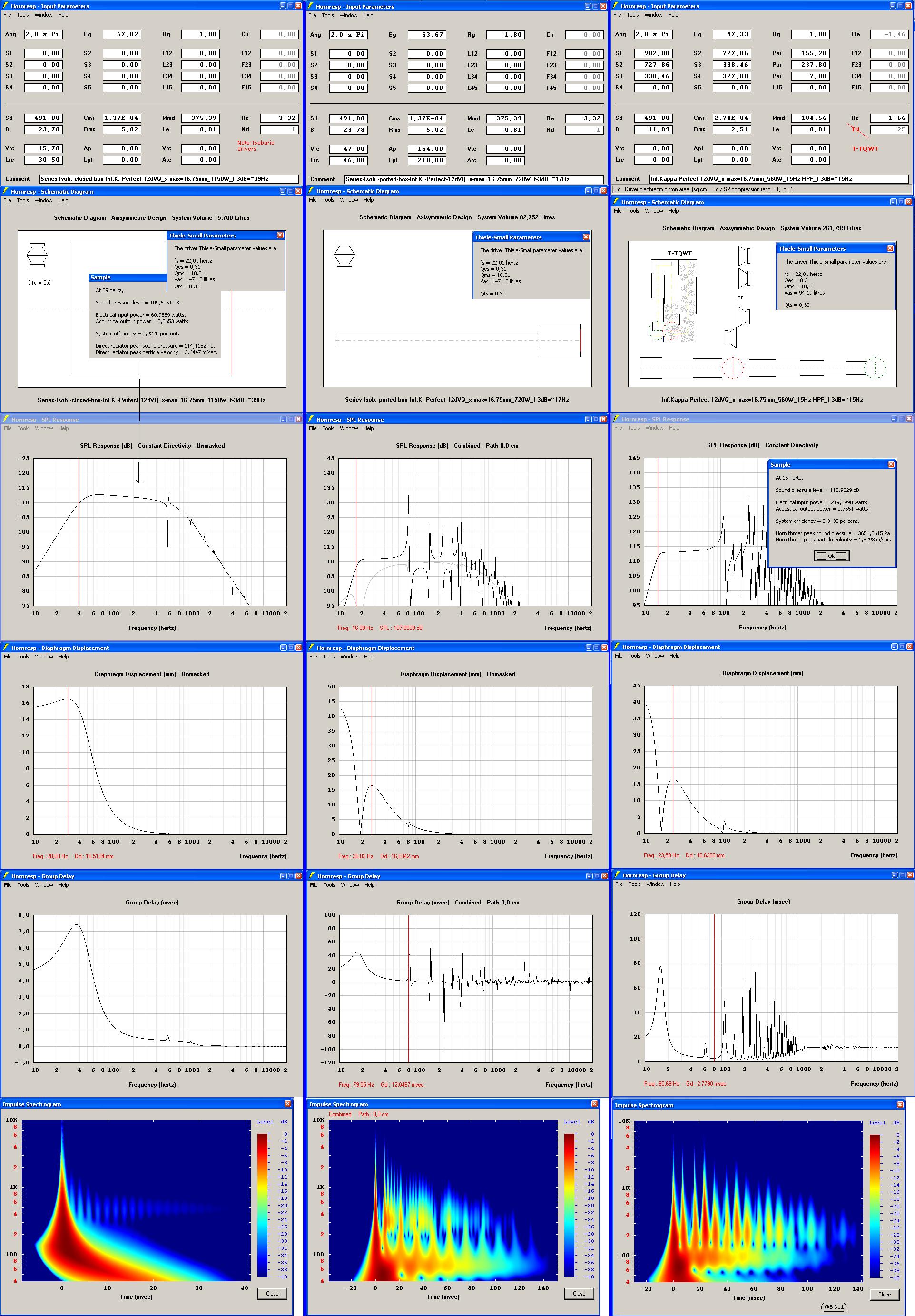

Infinity-Kappa-Perfect-12dVQ suggestions:
The closed box seems IMO to be best choice for your van unless you can house a T-TQWT.
b🙂
Thanks for the feedback! Any idea how long of a line I would need to do a T-TQWT? How about the volume? I found a useful article on it that had some useful CAD drawings that I could replicate for my application in my car (Infiniti QX56). The room is there and I guess I could part with it.
T-line dual 8" subwoofer build! - Home Theater Forum and Systems - HomeTheaterShack.com
Otherwise, I can just throw them in sealed boxes that are 1.25' which isn't nearly enough work/fun. 🙂
:irked: in the link above the guy just made a pretty picture without doing the math. danger danger, stay away from that design. you'd be better off just making a BR with a long low slot port.
Ha, when I first saw his first post, I was impressed with his CAD skills but was worried that more time went into the drawing than ensuring that the angles and dimensions were calculated correctly.
Thanks bjorno - I'm thinking that may be out of my comfort level! Eek. Appreciate your insight.
