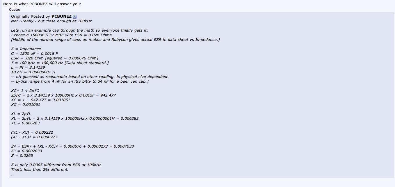

it would seem it's two different was of saying the same thing. Take a look at the Z and ESR numbers in the exercise. in this math exercise, Z almost equals ESR. Kind of like say how hot is something vs how cold is something.

The impedance of a capacitor depends on the capacitance value, the equivalent series inductance (ESL) and the equivalent series resistance (ESR). The ESL is generally quite small and can be neglected at frequencies below a few hundred kilohertz.
Thus "ESR" and "Impedance" at audio frequencies are essentially equivalent - and lower is better for either term.
