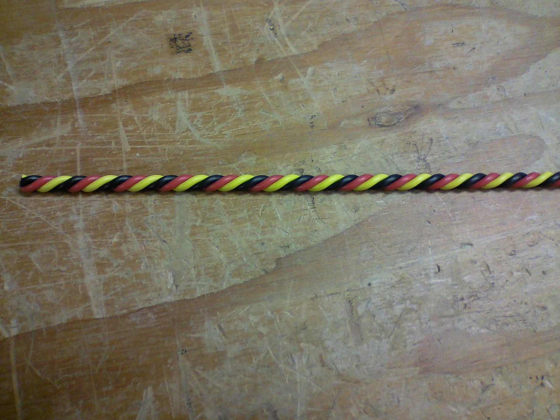

If you twist by your described method then you have strained both the insulator sleeves and the conductor cores. The strains will be much higher than if the wires were twisted using the contra-rotating method.Here is the twist I use for three wires.

so by contra rotating you mean twisting the to clock wise and the third counter clock wise?
If you are twisting the whole set/group of wires in a clockwise direction, then each individual wire of the group gets twisted anticlockwise.
