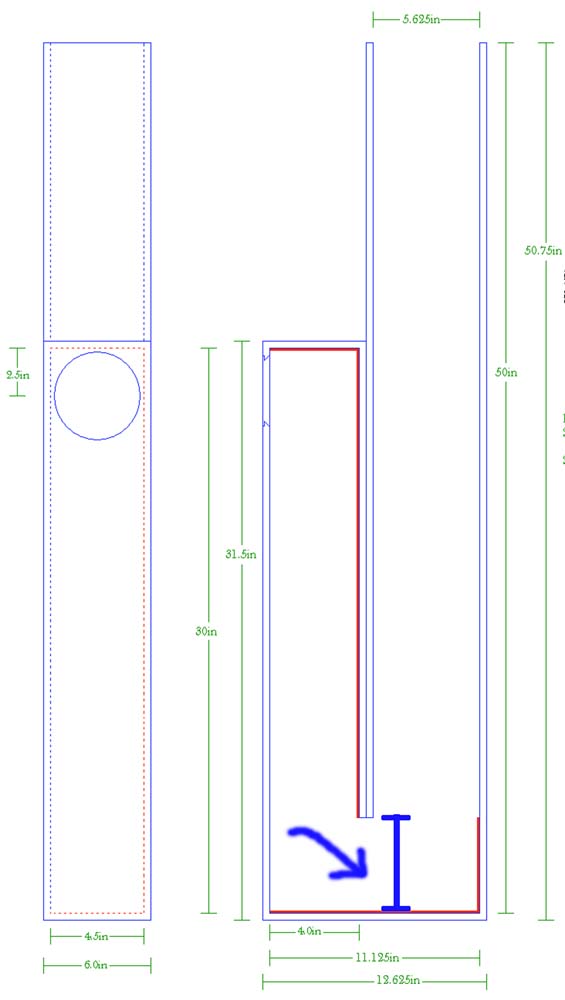

For East Moor, What would be the measurement of the gap pointed out in the picture attached?
Thanks,
Zia
Eastmoor? We've never released an eastmoor (althou a surprising number of boxes have "applied" for the priviledge).
If you are talking about Aln for the A12 it is 4.5" (as per the plans)
http://p10hifi.net/tlinespeakers/Woden/downloads/Aln-0v82-map-281209.pdf
dave

zman01. The email to me came in as a query about a "Twin pipe resonant air coupler and i assumed it referred to my Windermere build with 2 X EL70 in each side. However, the diagram on your site shows just one speaker unit, so the gap might be different. Hope I haven't confused you. Robert.Scott, Dave,

Dave,
As far as I remember, got the East Moor plans from the CHR-70 application thread. Designed and drawn by Scott Lindgren. 🙂
Here you go:
http://www.diyaudio.com/forums/full-range/141496-mark-audio-chr-70-application-thread.html
-Zia
You'll have to be more specific, what post in that thread.
