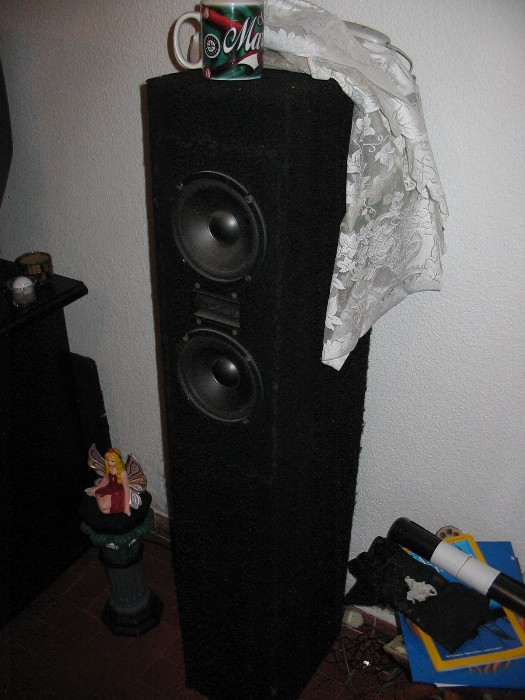

Actually nowadays it is a very common arrangement. A side benefit (Amongst others) is locating a 'tweeter' between the woofers.
This arrangement "corrects" what's called lobing errors.
Kinda like my DIY speakers...two 6 1/2 " drivers, and a tweeter between the two.
