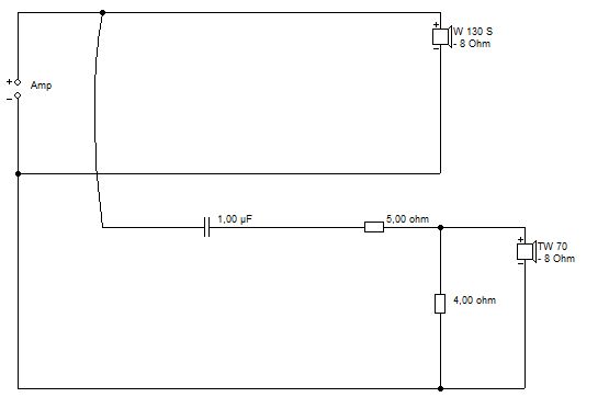

I need to reduce the tweeter output by 9dB, so I calculated the resistance of both the parallel and series resistors by use of the formula on this page: L-Pad Driver Attenuation Circuit) Designer / Calculator Help
The series resistor calculated out to be 3 ohms and the parallel resistor calculated out to be 4.5 ohms. After I wired them in, no change.
I'm not using any crossover. The 12LTA runs full range from my amp and the tweeter used a 1.0uF cap to which I added the parallel and series resistance I posted above.

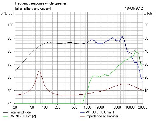

Below seems to be the right way to do the parallel filter as described.
Seems OK. The series version becomes a sort of midrange filter. If you foolishly put the 1uF AFTER the attenuator, it peaks up into the upper midrange, then falls away to nothing. 😱

Let me take a look at your drawings...thanks for the help.

System7's diagram will but you on the right path. You can replace the resistors with your L-Pads when they arrive - that will allow some tuning.
