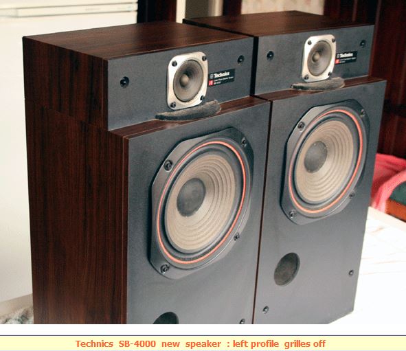

There may be something to be said for a time-aligned array like this Technics design. You can certainly line phase up better on second order filters. Which is a good thing. TBH I favour negative polarity on a flat baffle with steeper slopes, possibly exploiting some asymettry on slopes.
I suspect these allpass networks are fools gold though. I redid the B&W Matrix 1 third order plus allpass flat baffle crossover with a straightforward 4th order filter, flipping tweeter polarity. It ended up in the same place! Not surprising since each section stores energy and hence introduces time delay by nature.
