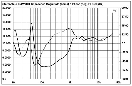

The only other thing I could do was to measure the DC resistances
of the original tweeters, which read 4.55Ohms and 4.75Ohms.

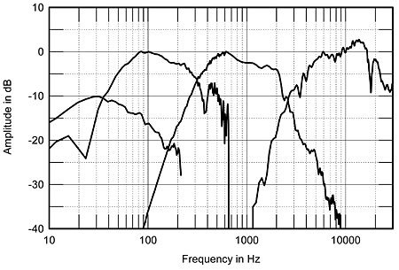

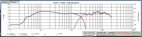

  • FrequencyResponse(Drivers).jpg : Driver Frequency Response Measurement by Stereophile Magazine.

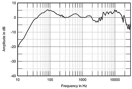

  • FrequencyResponse(Overall).jpg : Overall Frequency Measurement by Stereophile Magazine.
  • Impedance.jpg: Impedance Measurement by Stereophile Magazine.

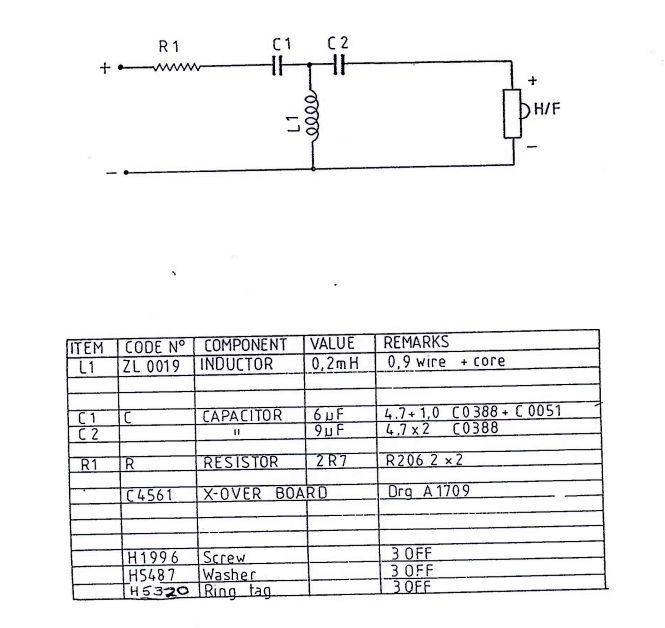

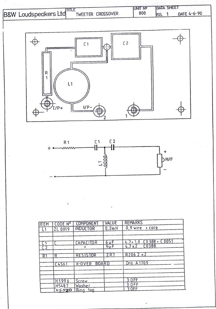

  • TweeterCrossOver.jpg : Tweeter Crossover contained in B&W Service Manual

Have you tried EQ to determine the frequency that is off?
-> No. I don't use EQ. By the way, if you see one of the attached frequency response measurement made by stereophile magazine, you will be able to see the frequency response. But, regardless of the loudness at a certain high frequency, the sound itself is not that pleasant.

There are x-over tweaks that could help. A notch filter is like EQ, but better. It can be tuned to specific frequencies. You could run wires out to try several frequencies with the parts outside the box. Measuring would confirm what you are changing. It might be as small as a 2dB change to get a better sound. Just looking at the response, I'd probably add a notch at 10k. The parts to do this are less expensive than a good tweeter. Everything above 4k could be brought closer to the 0dB line. It would be a gradual notch.

First of all, regarding your suggestion for notch filter,
I will try. If you watch the first two attached photos,
you will notice that the gain is low between 2-4kHz
and high between 5-10kHz. I am not sure if I can
increase the gain between 2-4kHz considering
the tweeter and the midrange response shown
in the first photo. In any case, I will try some
further crossover tweak according to your suggestion.
