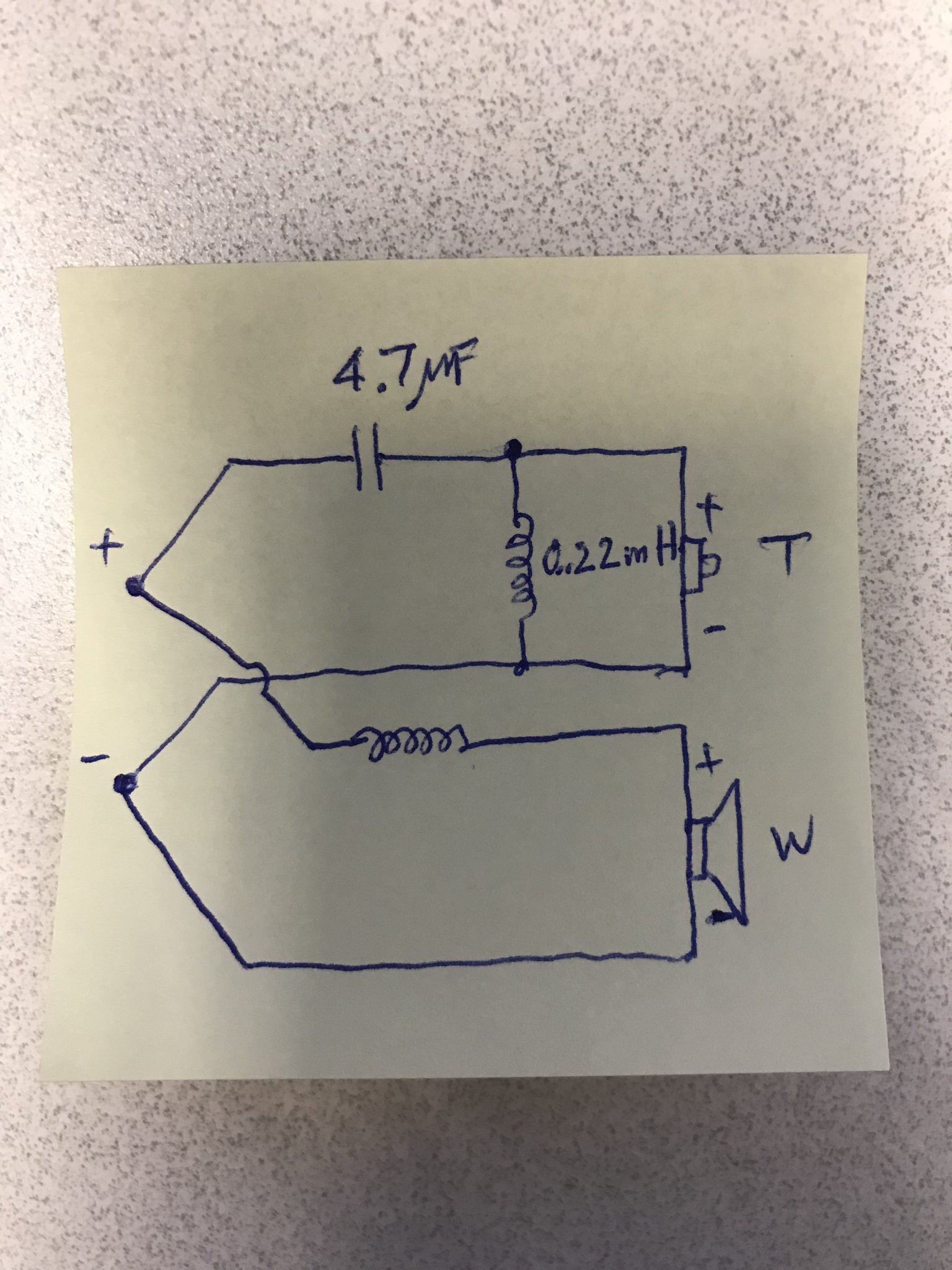

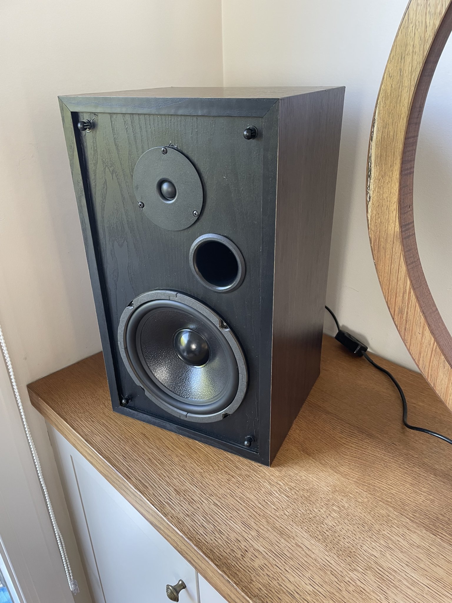

I am working on some speakers that have had the bass driver swapped out and sound like they are lacking in mid range.
The tweeter is a Vifa D19SD which seems to be a higher power version of the D19TD that I understand is usually crossed over at around 5kHz.
The crossover has a series 3.3uF cap and inductor (unknown value) across the tweeter, and a series inductor (unknown value) for the woofer. So a combination first order and second order.
I don’t know what the original woofer was, so am only guessing re what the crossover frequency is.
The replacement woofer looks designed more as a subwoofer and has a stated range to 4KHz, 91dB efficiency (vs 89 for the tweeter).
So….I wanted to confirm that for this crossover design, swapping the tweeter phase is not going to make any difference?
If the previous statement is true, then the only way to recover some midrange is to drop the crossover frequency, so I was going to try a 6.8uF cap to start, and adjust by ear. Potentially lose some power handling capacity.

This is what I was asking. Say I take out the series inductor from the woofer, a second order filter on the tweeter would then best be connected with the correct polarity, right?
Try some measurement. Because no one can tell you straight away what and how. By removing the series inductance on the midbass, both the phase and the impedance will change. Also, without changing the crossover, just turning the phase on the tweeters will maybe add and maybe take away some of the midrange frequencies. That's why you should try it first.
Swapping the tweeter phase is going to make the difference. Speaker crossover is a network so that every component in a crossover will effect the sound from all the drivers in that network.

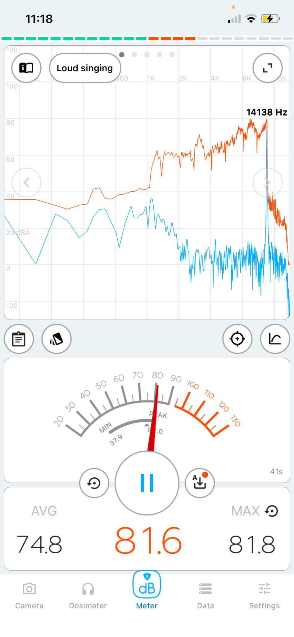

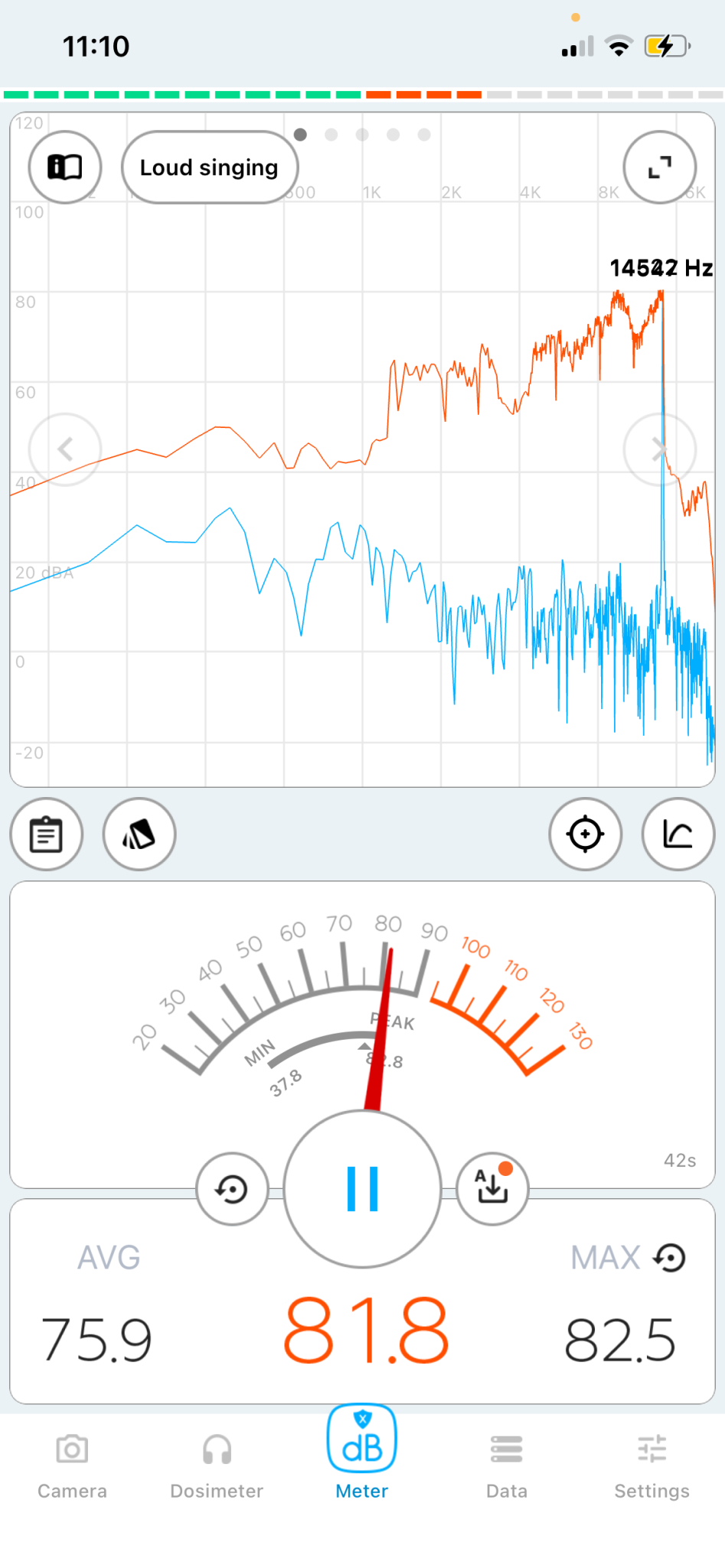

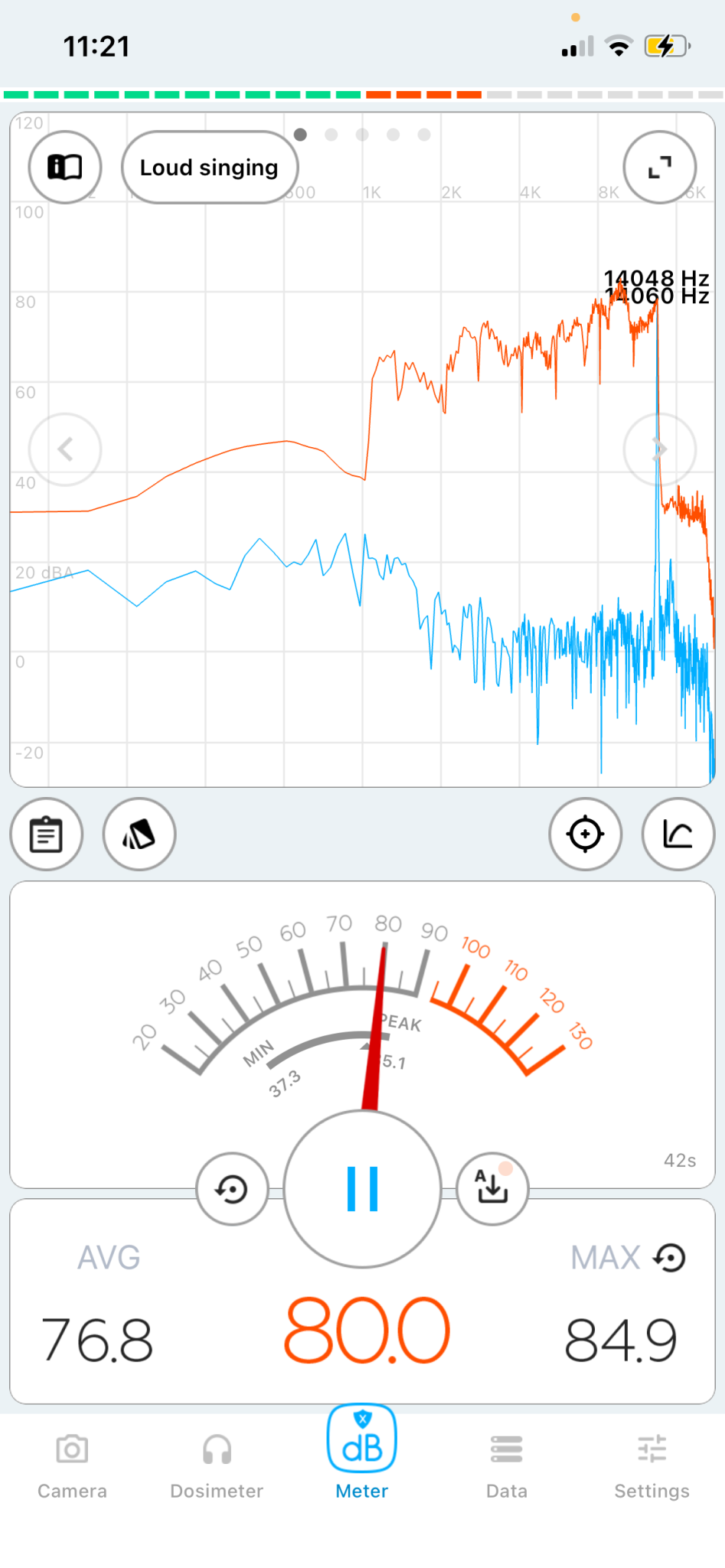

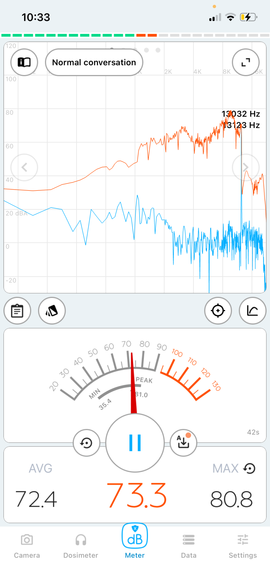

Well, that was a learning exercise.
I tried shorting the inductor on the woofer, putting in a different capacitor, and also swapping the polarity of the tweeter.
I ran a couple of frequency plots and they were consistent in each scenario, even though I suspect there’s some factors that influenced them overall. (The regular dropouts were from the generator, not sure why but it kept pausing)
There seems to be a large peak in the tweeter around 13kHz. That also appears to be the limit of my hearing range, so it’s not apparent when listening. There’s also a dip between 4-5kHz in the starting setup.
- Shorting out the inductor actually created a larger dip around 4kHz. Makes no sense to me.
- Changing the cap to 6.8uF (only value I had at hand) created the smoothest response but added a peak around 3-4k
- Swapping the polarity of the tweeter also improved things, with a smaller peak at 3kHz. I think I’ll run with this, and test an increase in the cap to 4.7k.
