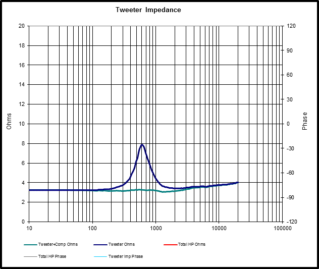

The notch in question is a series LCR Zobel shunted across the driver tuned to the tweeter's F0 impedance peak with the object of flattening it, improving power handling & ensuring the high pass transfer function isn't fouled up.

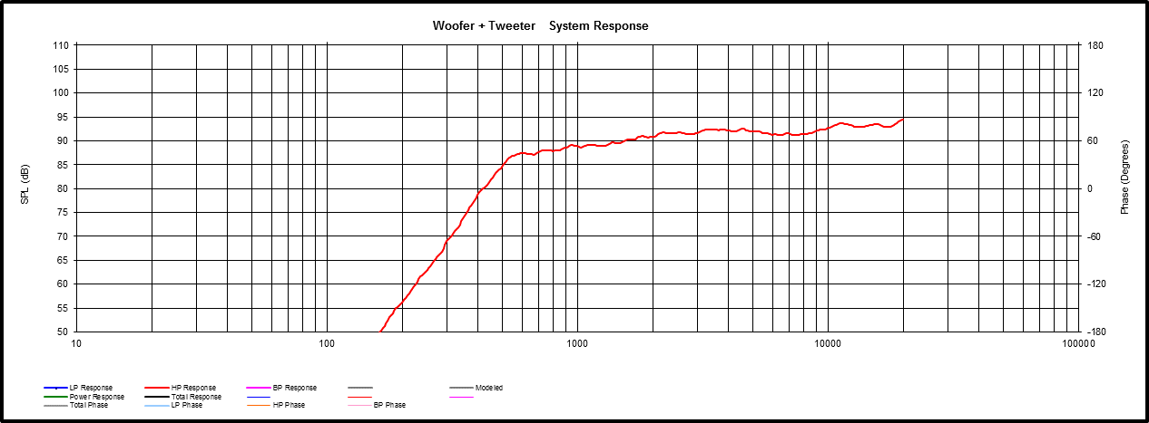

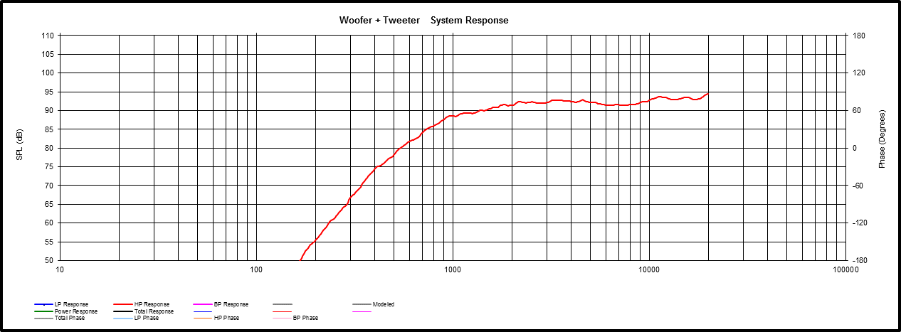

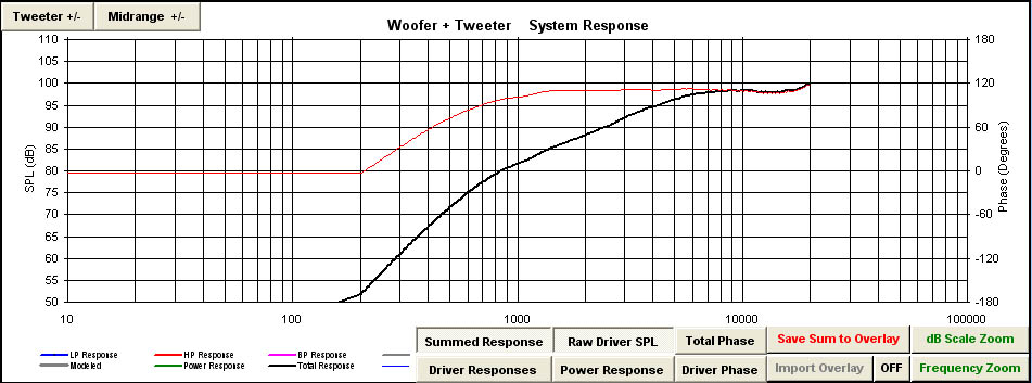

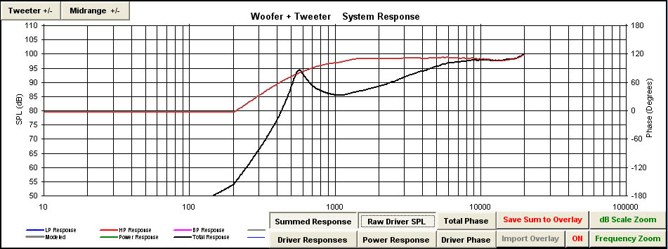

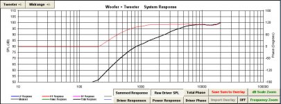

As attached example; this is a 3ohm tweeter with an F0 of ~600Hz. 1.2mH, 56uF + 5.6ohms across it. Dark blue as-is, pale blue with the LCR notch on it.
2nd graph shows the FR of the tweeter assuming a 1st order filter at 1.5KHz with the LCR notch in place. The 3rd shows the FR of the tweeter assuming the same, but without the F0 impedance flattening notch. I should stress that I don't recommend 1st order at 1.5KHz, it's just an example. 😉

Both a notch at tweeter resonance or a generally steeper filter would both serve to keep lower frequency energy out of the tweeter. The real problem comes if a low order, say first order slope is desired. The impedance bump at tweeter resonance will interact with a simple network and give a peak in input voltage. Either a conjugate to flatten the impedance or some other form of tank circuit to "de-peak" the voltage to the tweeter will let you achieve your target curve. As you go to higher slope networks this becomes less of an issue and some adjusting of values can get you around any peaking at resonance.

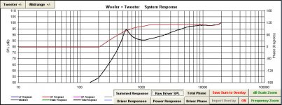

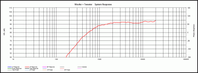

To show what speaker dave meant by interaction between
tweeter impedance peak and a 1st order filter.
Black graph on the left = 1st order filter only
Black graph on the right= 1st order filter + series RLC in parallel with the tweeter
