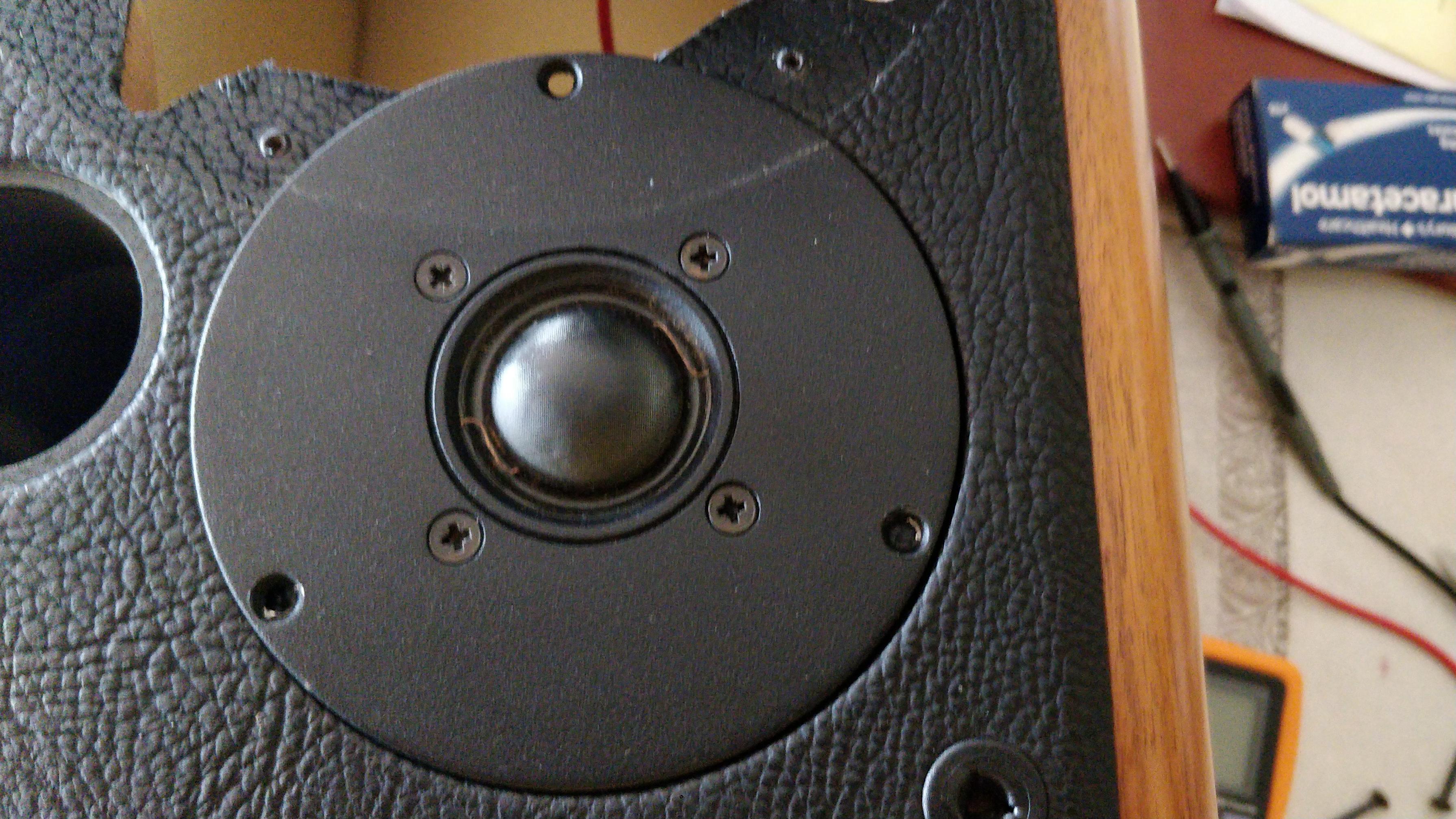

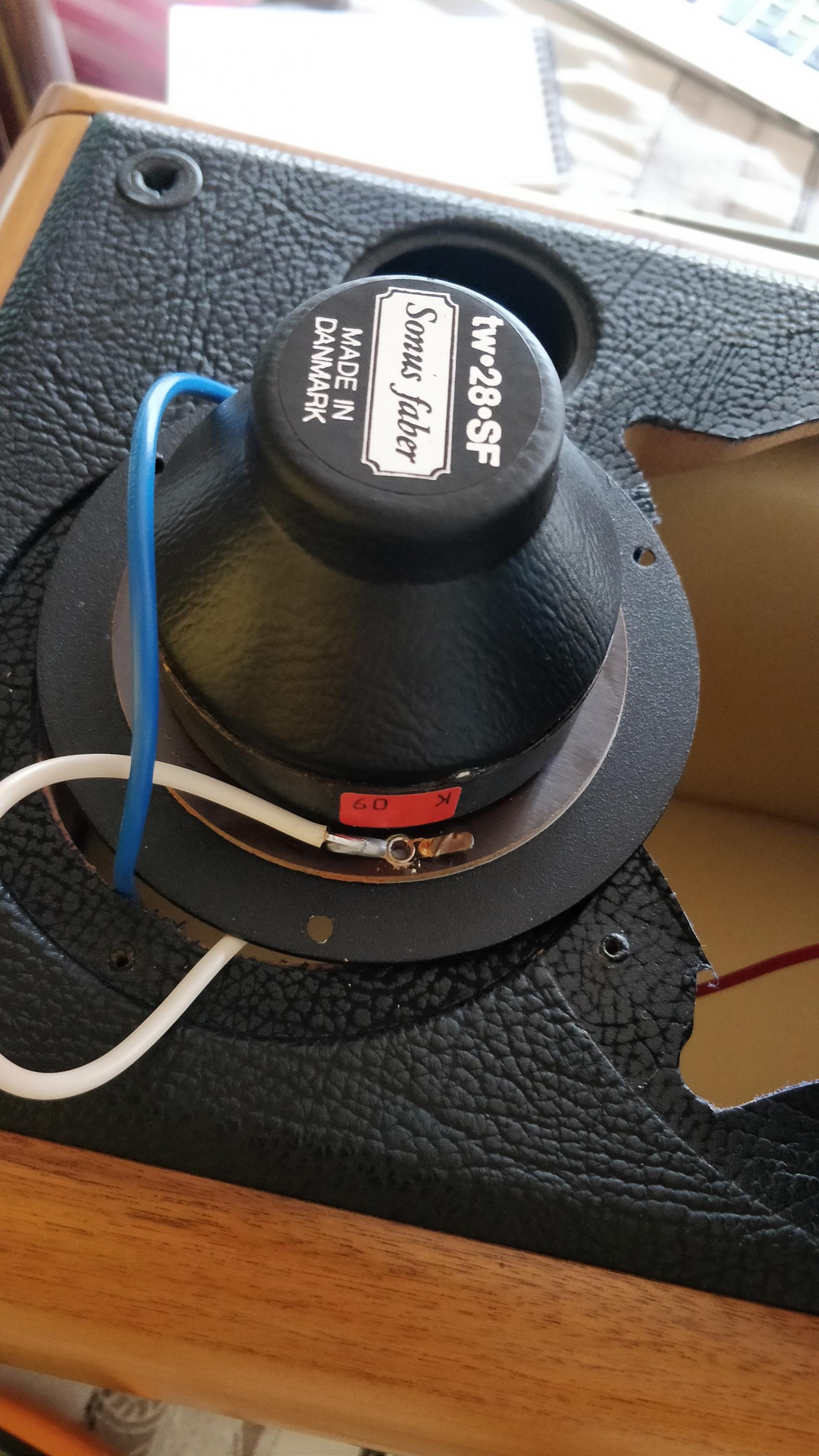

Sad day - one of the tweeters in my venerable Sonus Faber Electas has just died. It is identified on the back as "tw.28.SF" MADE IN DANMARK. Odd misspelling of Denmark, possibly a rebadged Dynaudio D-28? I'm guessing that original units are unlikely to be available, anyone know of a viable replacement?

P.S. Have you tested the tweeter to see if it is, in fact, dead and it is not a fault with the internal wiring?
I may be teaching my grannie to suck eggs, but a simple way of doing this would be to swap the tweeters between the cabinets.
Yes, a wise suggestion to first be confident it's the unit itself that is defective. Otherwise this Dynaudio look-alike tweeter should be reasonably close relative to Morel units, such as CAT 308, or Scan Speak D2905-930000; D2905-950000. I am not saying these are exact replacements, rather likely to perform well without major modifications needed, so I figure. Personally I don't do anything without consulting measurements.
As you can see from the pictures, I have the unit out of the cabinet, and I have tested it with a meter - unfortunately it is open circuit. Since there is nothing to loose I may try some investigative surgery.
It was a while ago when I bought them, but I think my Electas would be late 1980s or maybe very early 1990s - serial number 1087A/B. They are the original type, not the later Amators. I have contacted the UK distributer to see if there is any chance of spare parts - not holding my breath.
Try contacting Dynaudio as well, might be more affordable than through SF. While investigating faults, see if you can get a dc reading from the wire visible just next to the dome or somewhere near. Lightly scraping the enamel off would be necessary. I had once repaired a SS midrange cone like that, broken connection being right at the point of voice coil wire meeting flexible braid. These older SF production loudspeakers are a treasure aesthetically and I would get these repaired one way or the other.

Disappointment on arrival of the replacement unit, not much like mine at all. From the historical docs I would guess they have sent a D28/2. Further research shows that my Sonus Faber unit is more than likely based on a D28AF. Mine has a different rear acoustic chamber - I guess that was one of the Sonus Faber mods.

After pulling apart the tweeter to check the coil, I figured out that the Sonus Faber modification to the D28AF was just a larger, acoustically padded, rear chamber. Something easily transferable from my tweeters to another pair of D28-AFs, but they are also NLA new. A S/H pair on eBay for €140 hmm... Go back to Dynaudio for a pair of those D28/2s and hope they are similar enough to the D28-AF at £175? The accepted replacement seemed to be the Morel MDT32S/CAT 328-110. In the UK about £140 a pair, sighs, reaches for wallet... and yet...
...looking again, through a 7x loupe, at that busted tweeter coil and prodding with my finest meter probes. It was just one side of the coil, at the junction between the coil and the fine feeder wire, that was open circuit. Barely 0.5mm of coil wire to try and attach to. But just enough to grab with fine tweezers, unwind a turn, steady nerves for the fiddliest of soldering jobs, attach coil end to feeder wire, meter out, measures within spec at 5.6 ohm, faceplate screwed to magnet, tweeter installed --- happiness ensues. Sorry, Celestion DL6s, a solid replacement in times of trouble, but back to the garage with you.
