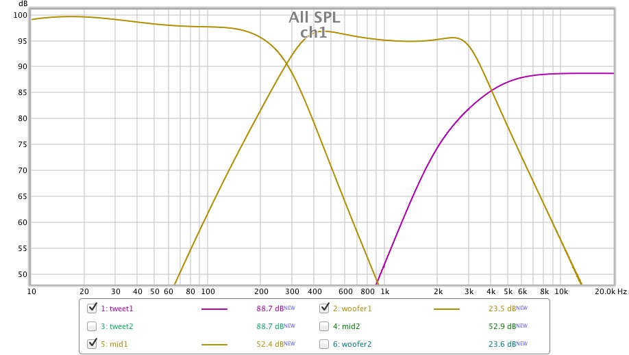

just wanna share with you the crossover circuit and its response. This circuit was designed with the leap software. The response curves are real and not circuit simulation. this crossover will be used for the seas excel w26fx001 - w15ch001- T29cf002 units. As for the tweeter capacitor i will use the audyn 47uf (i have it already so i don't have to buy new) and later i will probably take it out of the circuit. later i will post some photos of the completed crossover unit. all the opamp are opa2134.
Have you considered your listening axis and used a measurement axis that reflects this?
hi,
when i say that the measurements are real i mean that those curves have beed measured by sending a sweep to the crossover and measuring the crossover output not the speaker output if i understand your question right.
Of course if you mean if i used speakers measurement on axis as a data for the crossover calculation then yes, i have.
Ok. When you're ready to measure the speakers again a suggestion would be to compare your on axis measurement to say, 30 degrees off axis to see how different they are. This off axis measurement might be more indicative of the overall response as this axis is sometimes closer to this, although further measurements should remove doubt. This is mostly aimed at matching what you hear directly to the tone contributed by room reflections and may indicate a desire to listen to them at some other axis.
