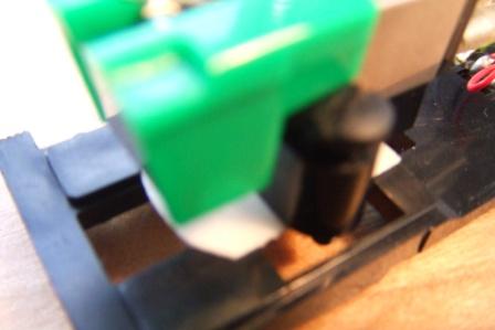

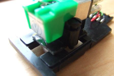

I decided to try mounting the cartridge on my TT using cork pads between the headshell and cart, this actually made quite a difference despite the fact I was still using the conventional nuts and bolts.

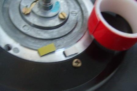

I then tried just the cork with double sided tape, this worked even better, but the tape let go after 24hrs or so.
Then I tried just a piece of thin double sided foam tape, now this truly is an amazing tweak, way way beyond what I thought possible.
First of all the tape is very secure, no indication after 3 days of letting go at all. The difference in sound is incredible, surface noise is reduced to very very low levels and suddenly old LPs that were too worn to listen to are quite fine. You may think this would kill the resolution but it is quite the opposite, high frequencies are utterly beautiful and I can hear details that I have not heard before. This is simply the most stunning tweak I have ever tried.
Downsides...none I can think of, other than readjusting the VTA.
I am not sure why it works so well but I think it is that the dust and rubbish rests in the bottom of the grooves not the wall so much so the dust will tiend to force the needle upwards, the foam absorbs this impact. The sideways motion in the grooves is unimpeded as laterally the foam is still in both horizontal direction, however it probably has just enough give to soften lateral impacts from nicks etc in worn recordings.
It might sound too good to be true, but all I can say is if you are battling with old worn LPs try it, it also makes good ones sound better on my system anyway.

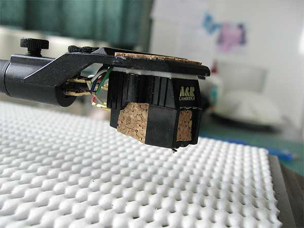

Finally adding thin cork to the cart body can stop some resonances and give improvements in resolution and imaging (in my case anyway).

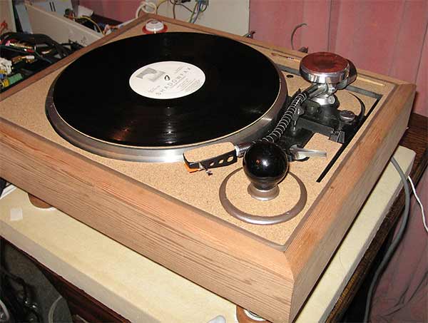

I have attached a pic of the modded TT, it started out as an old pioneer p513X
