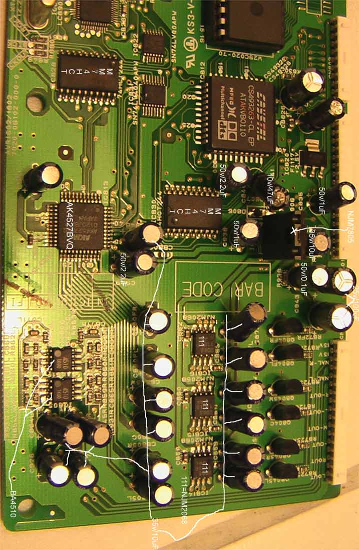

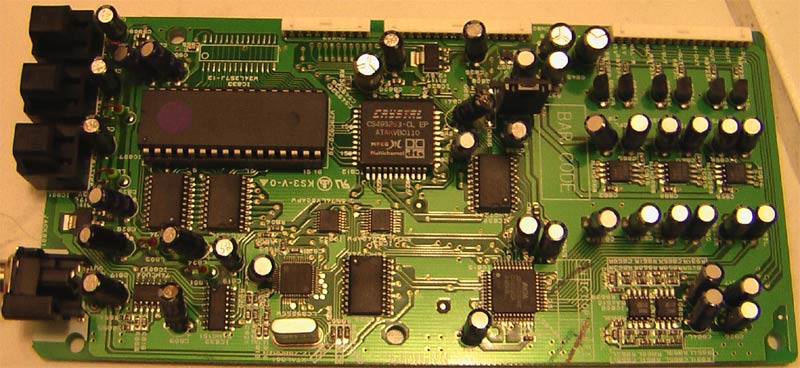

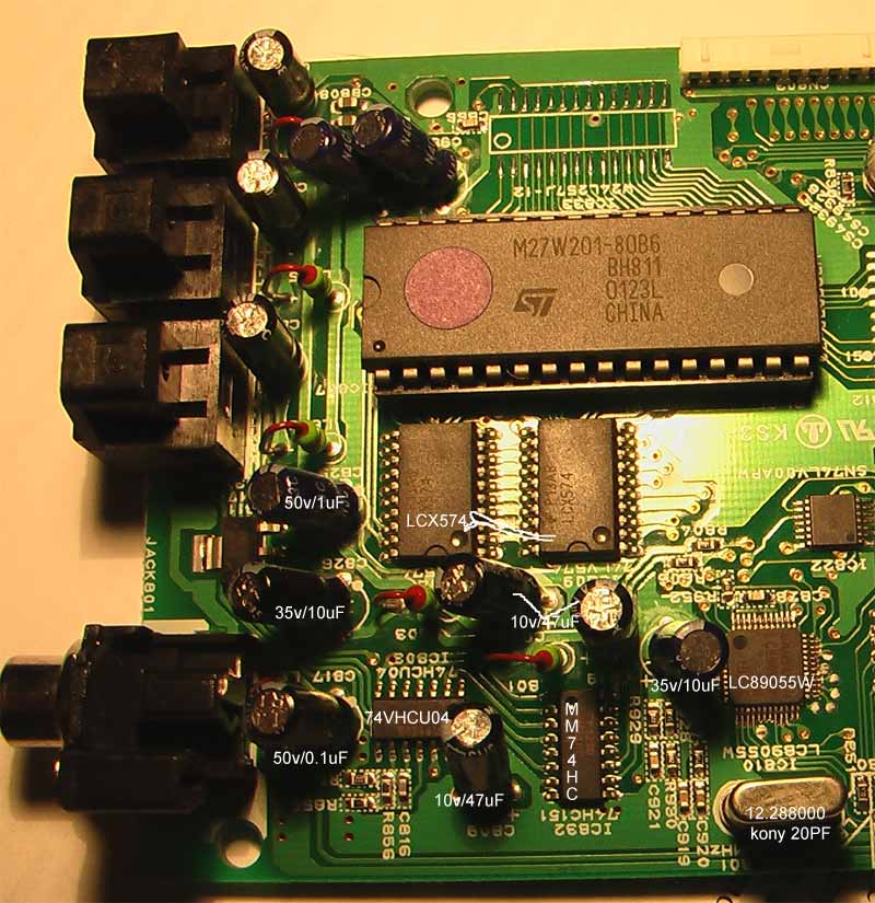

I would like to tweak the digital in of my receiver. First, from what I've seen the caps and the opamps are pretty very much crap. The voltage regulator is about the same as well. Of course, none of the components are really high end, but I can't afford high end right now, so I try to make the best from what I have, that's why I deceided to tweak it.
Could someone help me with directions, tips, anything would help.
I attach some pics with the digital in pcb.

I know there is no schematic posted on this, but that's because I don't have any, and Denon doesn't want to send me one.
Is there a way that you can tell what caps are the most important over there?

What I was hoping to get are not necessarily precise directions, a more gener approach would help as well(something like this: the caps next to the opamps must be for this, so it would be a good idea to change them for some better). This will help as well.
Other target might be the clock, as I can't differentiate(visually) between a good clock and the clock it uses...

First of all, search for the datasheet for the AKxxxx, i´ll guessthis is the CODEC wich performs ADC-DAC. This one will be happy if you´ll provide a seperate 5V line for it (you´ll get the unregulated volatge at the njm7805, look in the datasheet...)
A safe way would be to replace all the electrolytics with OSCONS(capacitance can be somewhat smaller then!)
This 8-pin chips are, I guess, opamps, wich can be replaced by somewhat better. try opa2134, they are cheap and do have a not so bad reputation...
