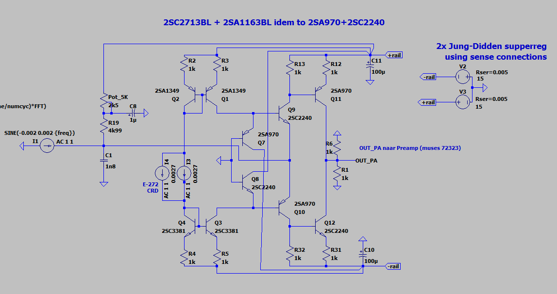

Hi all,
Planning to build the Pedja's DDNF as well.
I've added the CCS's in combination with CRD's.
Current throught all bjt's is between 4 and 5,5mA.
This IV stage will be used for a TDA1541A DAC: https://www.diyaudio.com/community/...ac-using-tda1541a.79452/page-411#post-7403416
PSU are pre-regulated Jung-Didden supperreg's. These will be put in the female 2x5 headers on the PCB.
What do you think? Any concern's or advice?

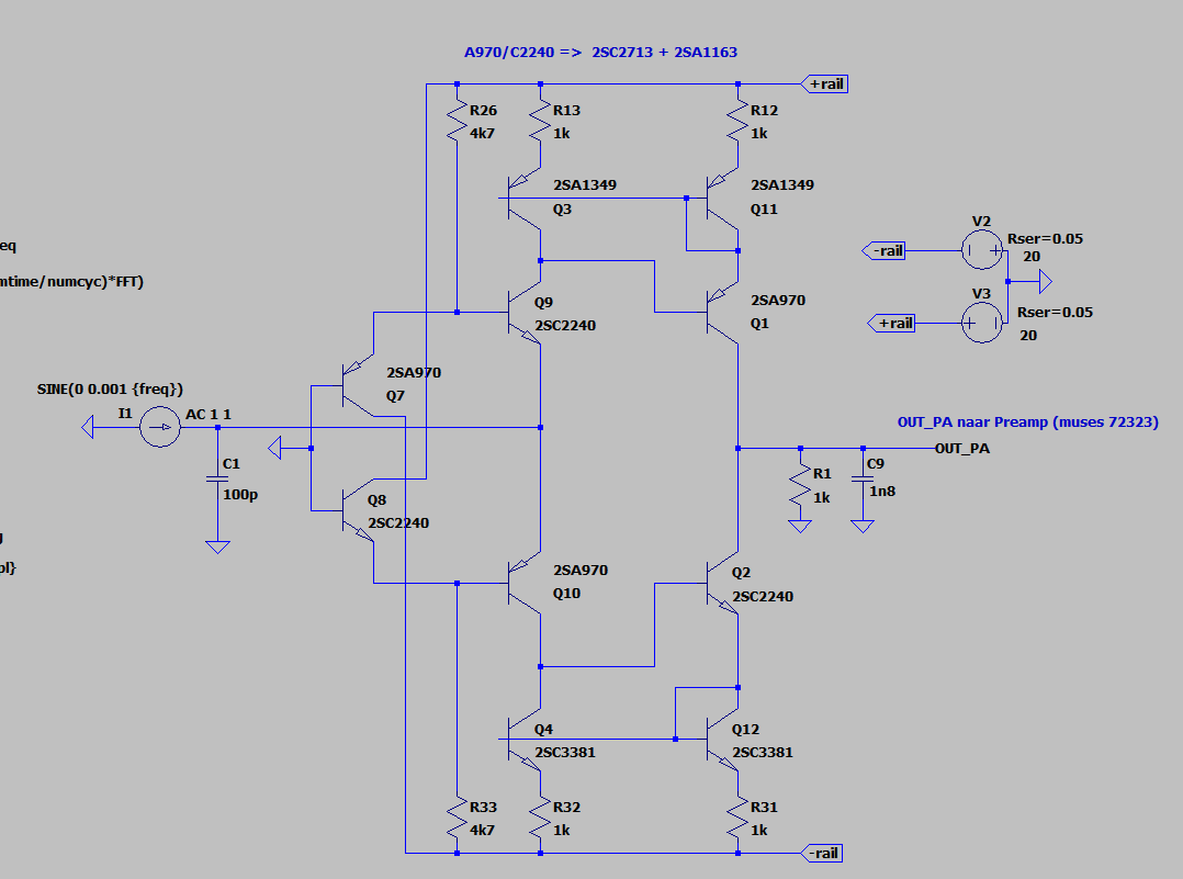

Hello,
Been playing in real life and spice with the standard Pedja Rogic DDNF, the one in the previous post and the one posted below. This one (below) seems most stable in bias drift during temperature changes and give nicest harmonic profile. Also, I can use some dual bipolars for the current mirror, have plenty in stock and never been able to use them with a good purpose.
Bias is about 2.5mA in the output stage. I'm wondering if an additional buffer stage running on higher bias is needed to drive my preamp, connected with 50cm shielded RCA cables. Input resistance of my preamp is +-20kOhm (input resistance of Muses 72323).
Now back to the drawing board, to design PCB's.

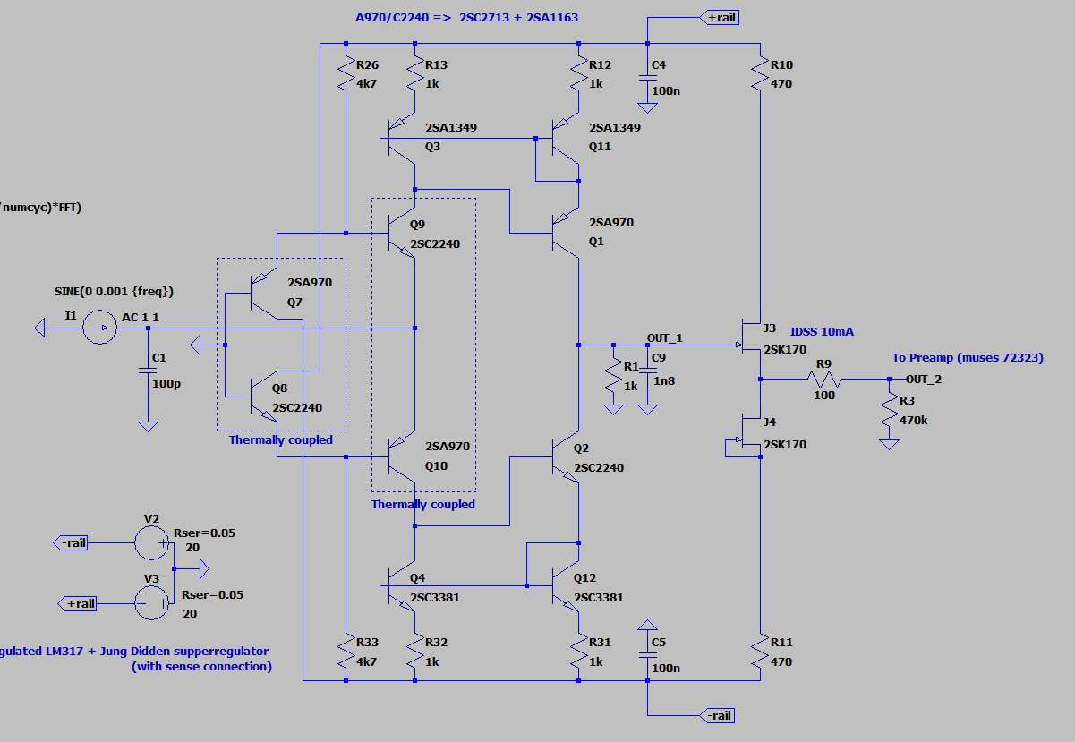

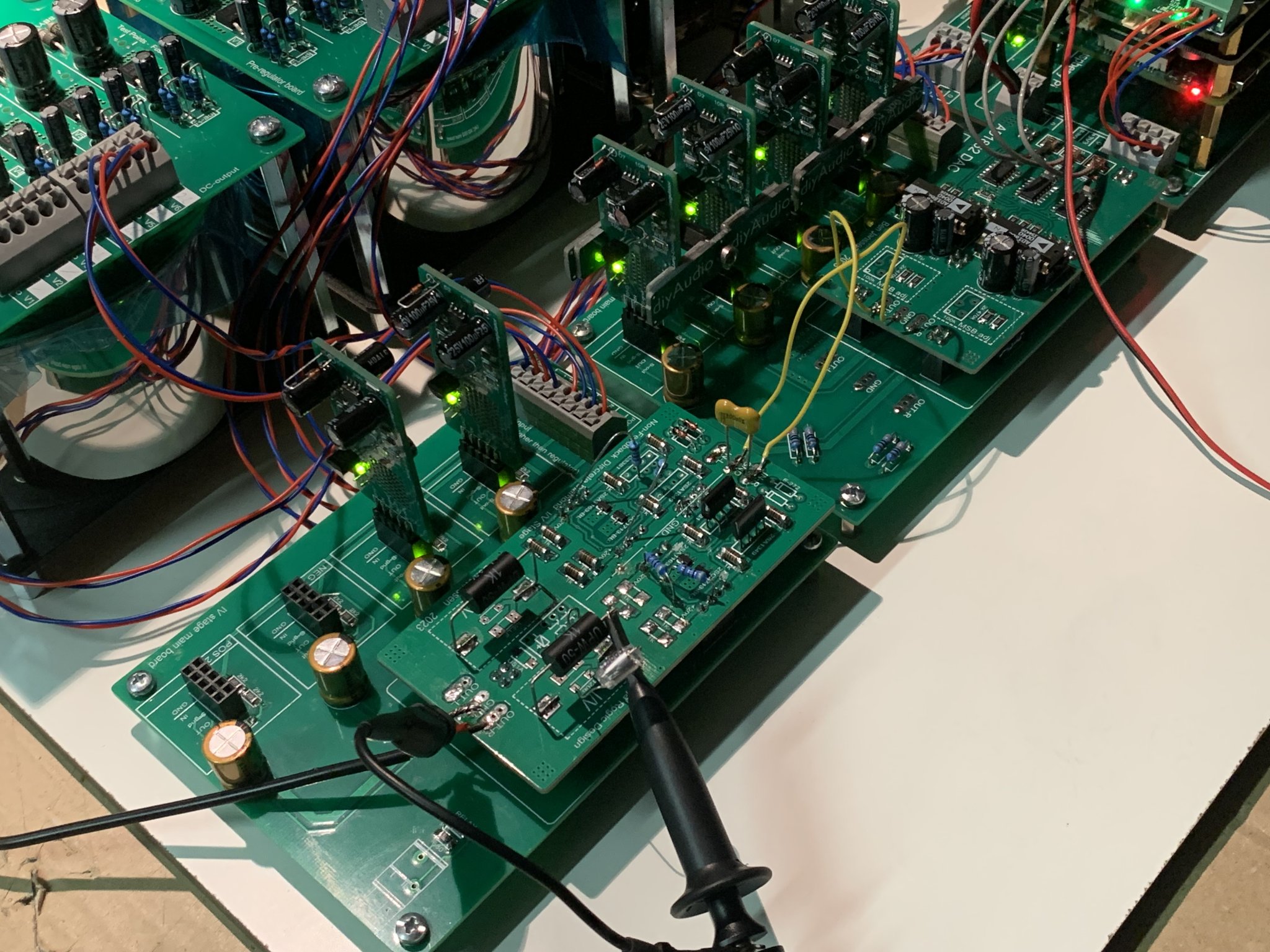

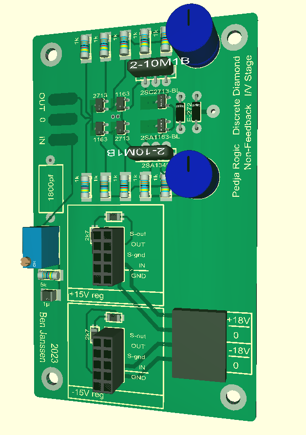

Finalized the design.
I added a single ended Jfet buffer using 10mA IDSS 2SK170BL's.
Prototype is running and output offset is less than 1mV.
Below circuit is the AS-BUILD circuit.
I noticed the 1,8nF cap on the output of the IV-stage and before the buffer is a MUST have when playing music and probing output with the scope.
PCB is ready to be send to manufacturer.
