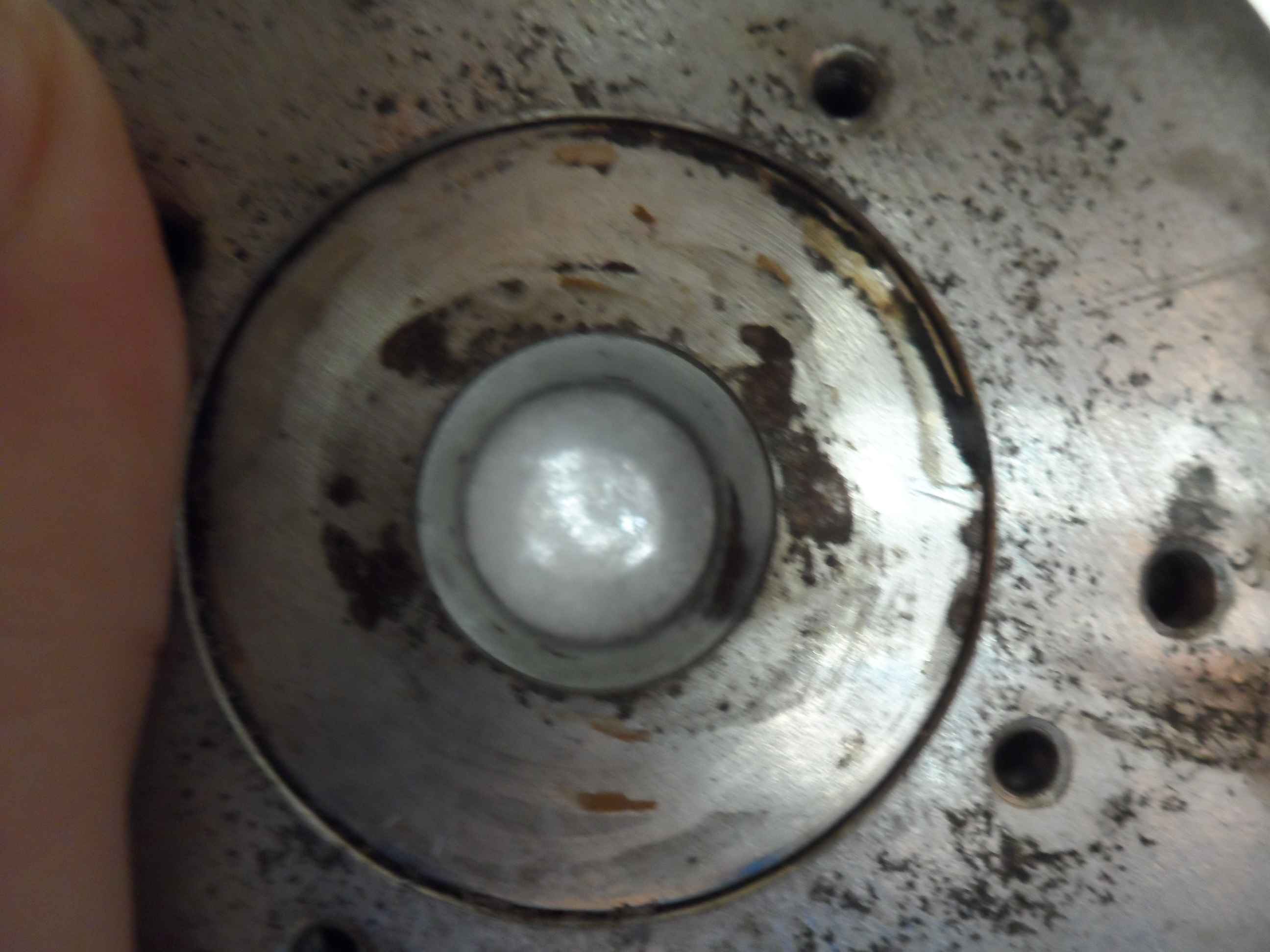

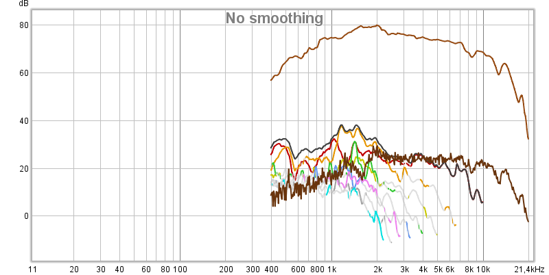

Case: both horn and compression driver are unknown model of unknown brand. These were found in 1980s Ecler TRO-120 Speakers. Re=10 ohm, 1.75" titanium diaphragm, dented suspension, axial slots and mixer, 1" exit. Oversized magnet. (fig.1, fig.2, fig.3)
(Measurement: Focusrite 2i2, Behringer ECM8000 on stand, SpecraPlus)
- Unmodified response: brown trace (fig.6): severe high Q dips in HF output (8Khz, 13Khz, 17Khz, 19Khz, 20Khz).
- What starts turbulent ends turbulent: Standing waves can ruin HF horn response (fig.7).
- Horn has sharp borders on cavity perimeter (fig.4). (I suppose the horn is an "eye copy" from another classic model, which includes a bullet piece. Precision in machining suggests China. In practice these borders are creating standing waves at HF.)
- Horn machined to remove borders (fig.5): orange trace (fig.6): 19Khz dip is removed, more low end output, less 14Khz peaking.

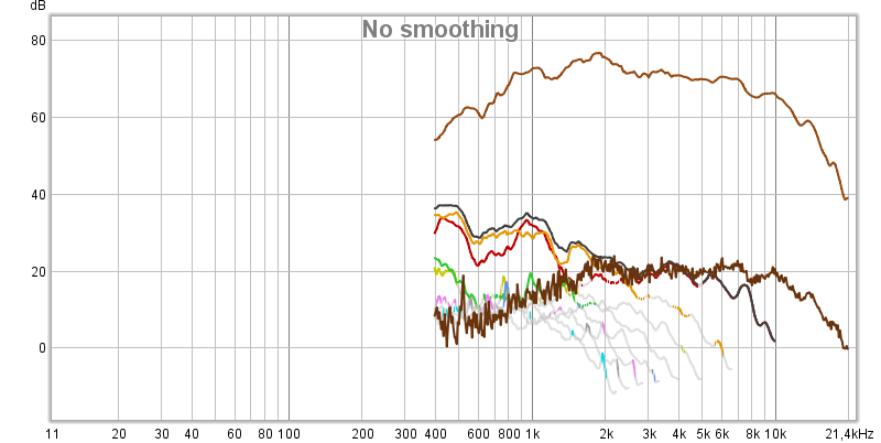

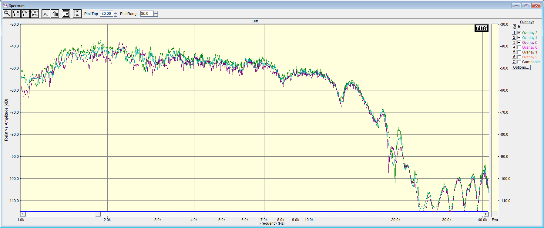

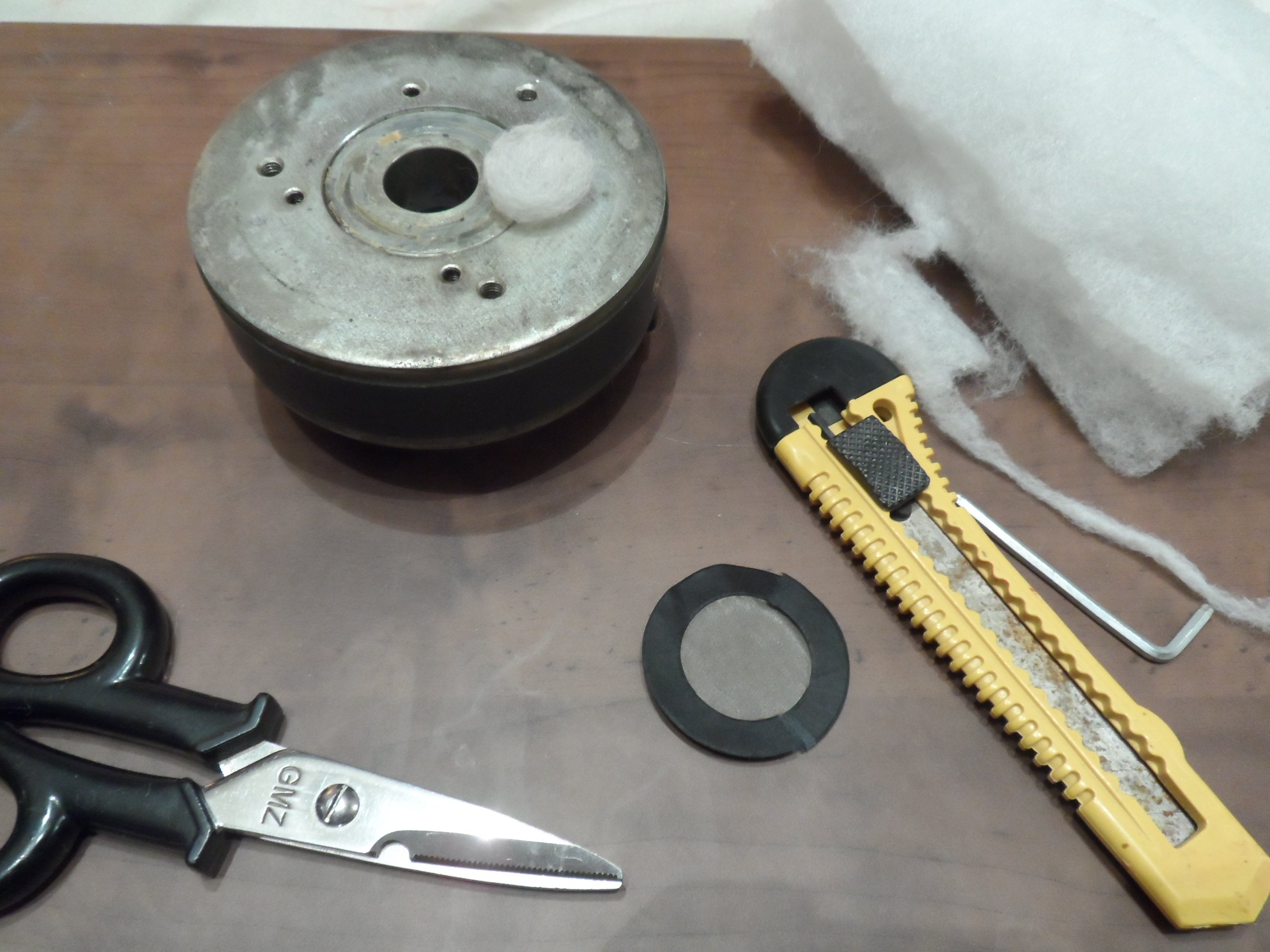

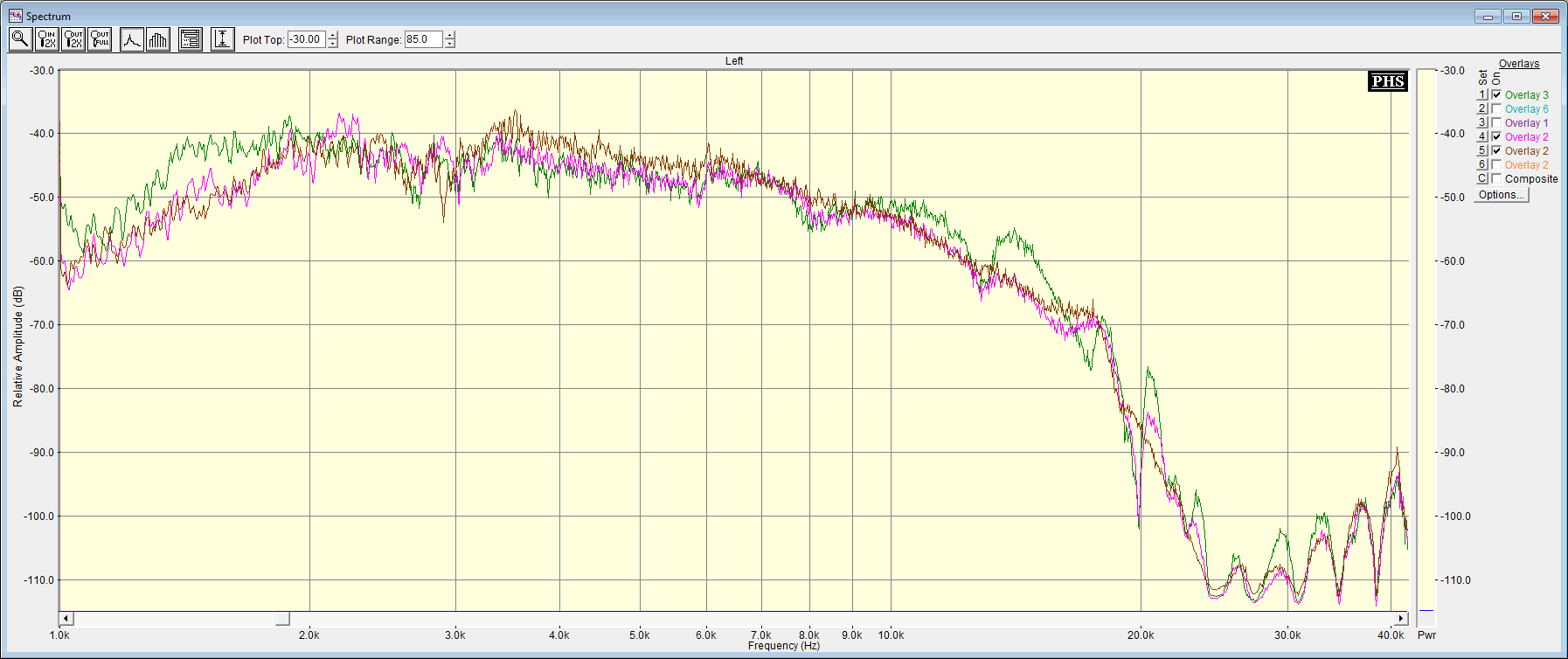

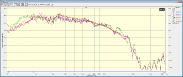

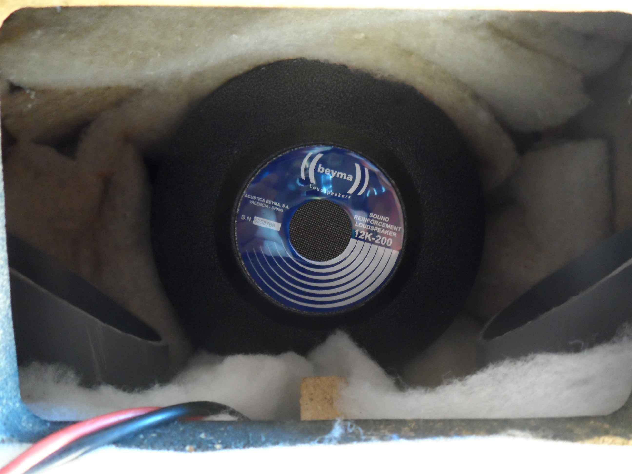

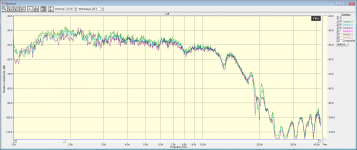

Increasing back chamber damping with poliester fiber lining (fig.1):
- Not lined: green trace (fig.2): Unmodified response
- Soft uniform lining: cyan trace (fig.2): reduces the 20Khz notches, but worsens the rest.
- Thick center lining: magenta trace (fig.2): splits the 20Khz notch in two.

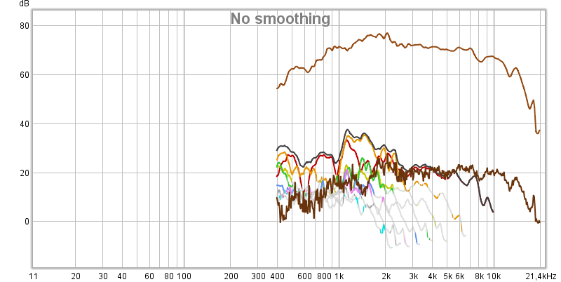

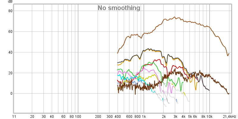

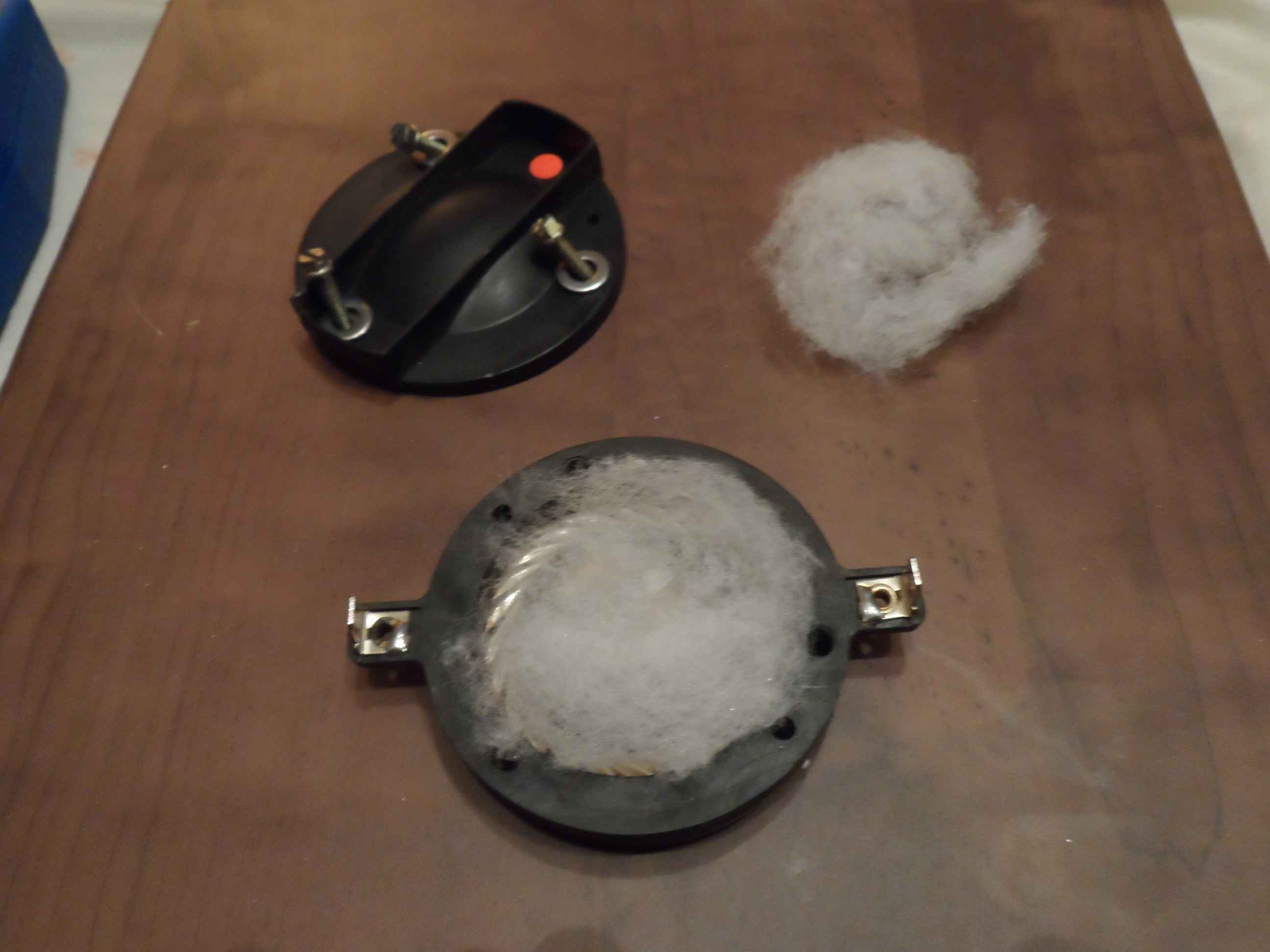

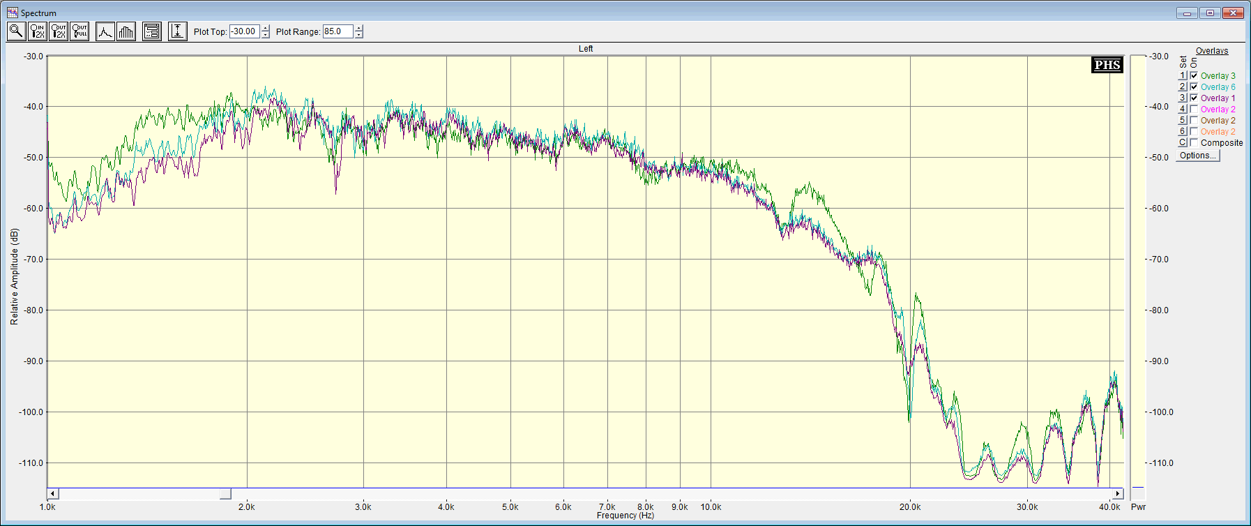

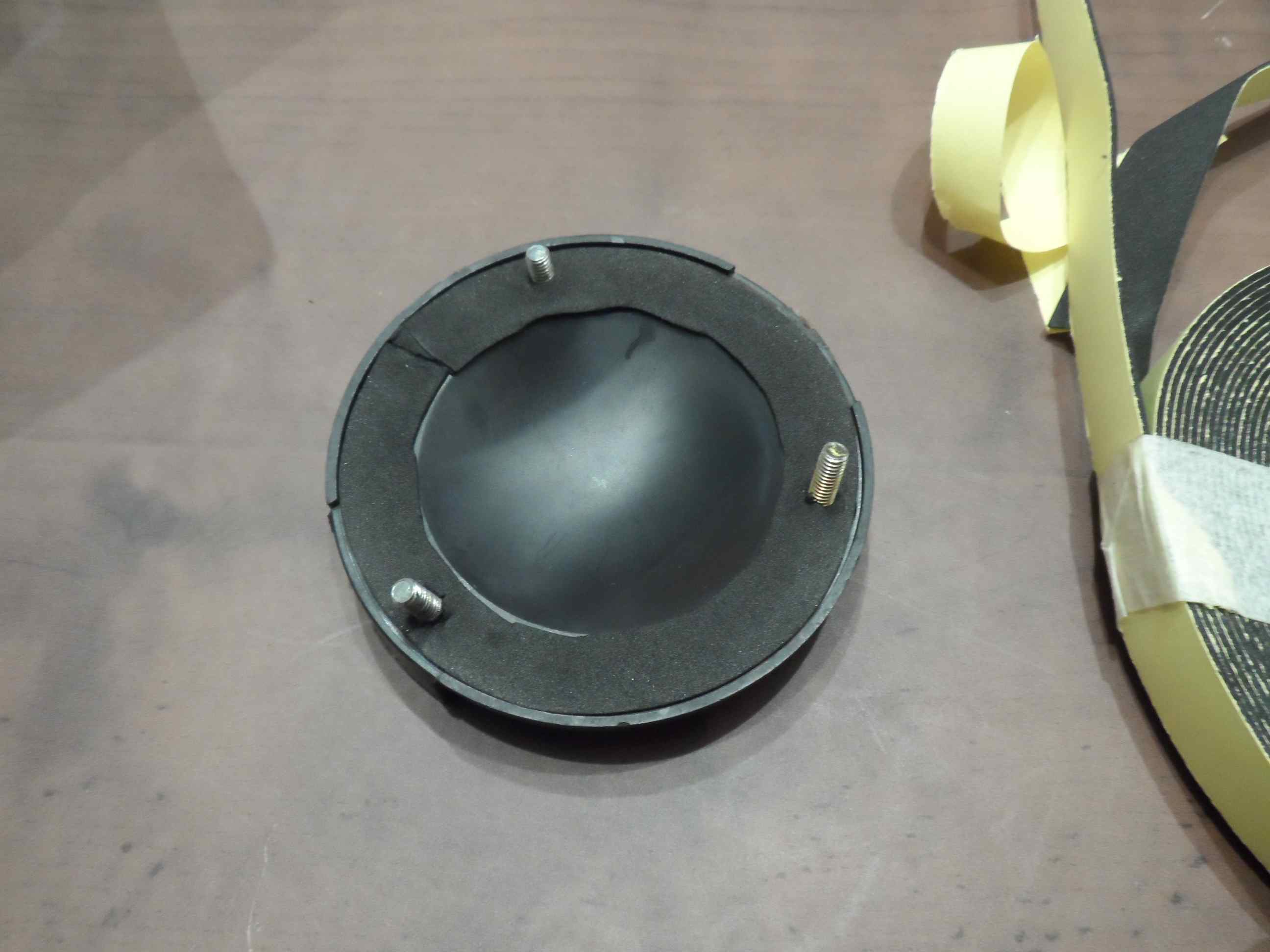

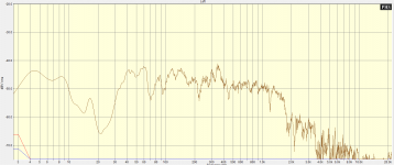

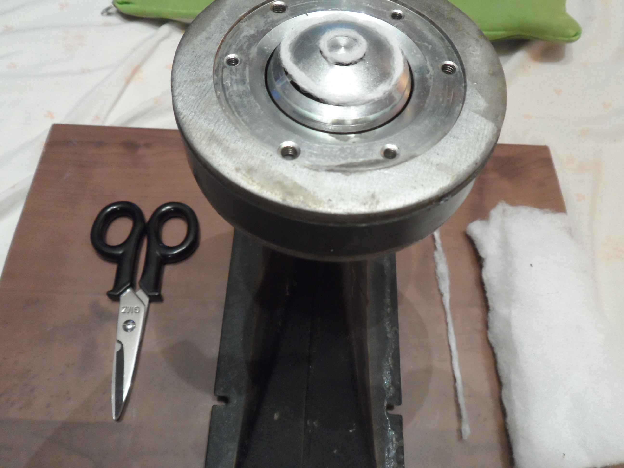

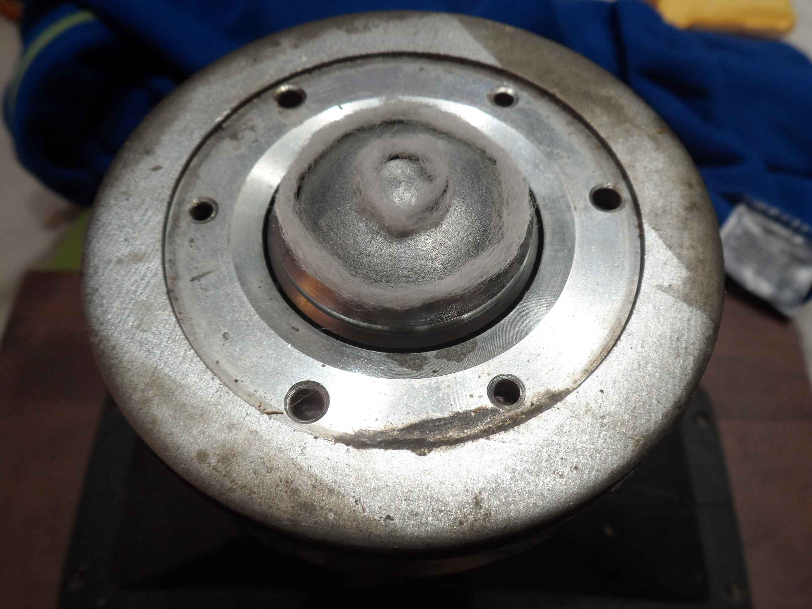

Adding damping material on throat slots and mixer cavity (stranded polyester fiber made from sheet):
- Fine lining of compression chamber (no back chamber lining): no picture: loss of 3dB efficiency at all frequencies, little improvement on dips.
- Lining on throat slots (no back chamber lining, fig.1,2): cyan trace (fig.4): lots of improvement at 13Khz and 17Khz.
- Lining on throat slots. Lining in back chamber, thick at center, soft around: magenta trace (fig.4): Less 20khz dip. Slightly less low end output.
- Lining on throat slots. Soft around lining in back chamber: pink trace (fig.5): more 20Khz dip.
- Lining on throat slots. Lining in back chamber, thick at center, soft around. Lining at transition in mixer cavity (moderate density, about 1/2 wave of 20khz length, fig.3,4): brown trace (fig.5): full improvement, no sharp 20Khz dip.
There is a sudden change of expansion law at the point where both slots are mixed. It is similar to a parabolic horn in shape (very reactive acoustical impedance), 1st half expands much faster than 2nd half. This already creates standing waves (turbulent pressure waves). The mechanism is very sensitive to phase mismatch between slots due to propagation delay of the dome. The acoustical output impedance of that thing is loaded with the relatively huge mass of air inside the horn.
But there is something else, there is a bend in the path of outer slot. The edges on the bend are all subject to diffraction. Unless all parts of wave arrive in phase, some energy of the wave is radiated in all directions, including backwards, standing waves are created.
Lining: It gradually turns pressure waves, following the laws of pressure propagation, into heat waves, following the laws of heat propagation, and back. Waves propagating in many directions transition to uniform direction as they pass lining material.

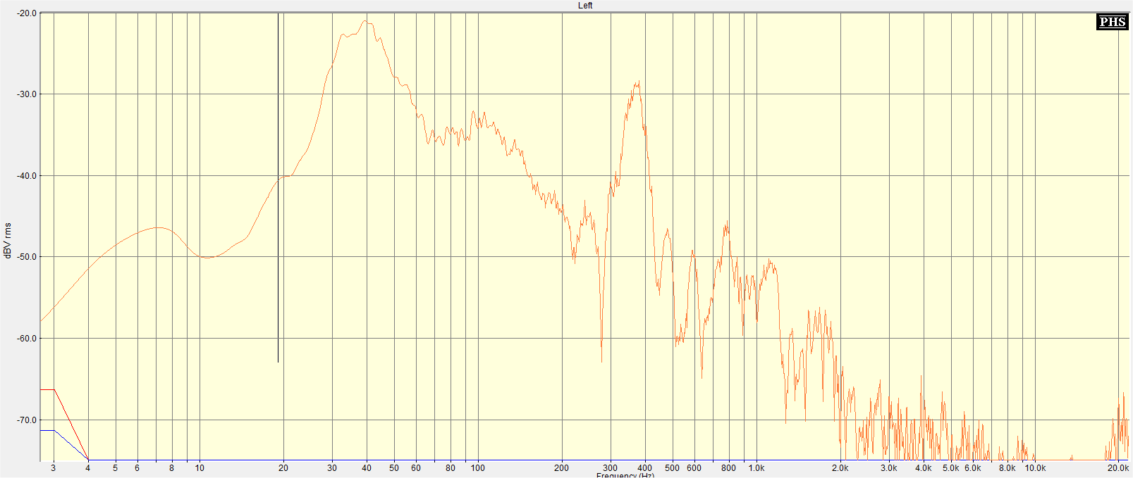

The whole design is low tech hehe
But the addition of elementary fiber technology on top of elementary metal technology produces quite reasonable audio performance, as for "now and forever" good sounding low cost models.
(I did not tell which brand was, however I can give one hint, it has been the supplier of loudspeakers to Television Española for many years.)
It really doesn't matter what brand is it. If it is renowned now, it is renowned for a reason. In PRO-audio world - if quality isn't there you go down very fast.

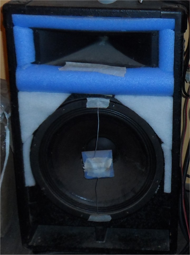

Cheapo:
- Diffraction control for HF shortened horns.
- Horn impedance peak control for HF shortened horns.
- Phase plug for HF in big diameter cone drivers with tendency to beaming (plus cone treating with latex and back side polyester foam for damping and keeping MF/HF away from reverberating inside enclosure).
Achieved empirically with soft materials.
(Plus "tline behaving" LF resonator, finding optimum place for port entry inside enclosure.)
(Dirt & cheap because I had to move my stuff 2 times in past 6 months.)
