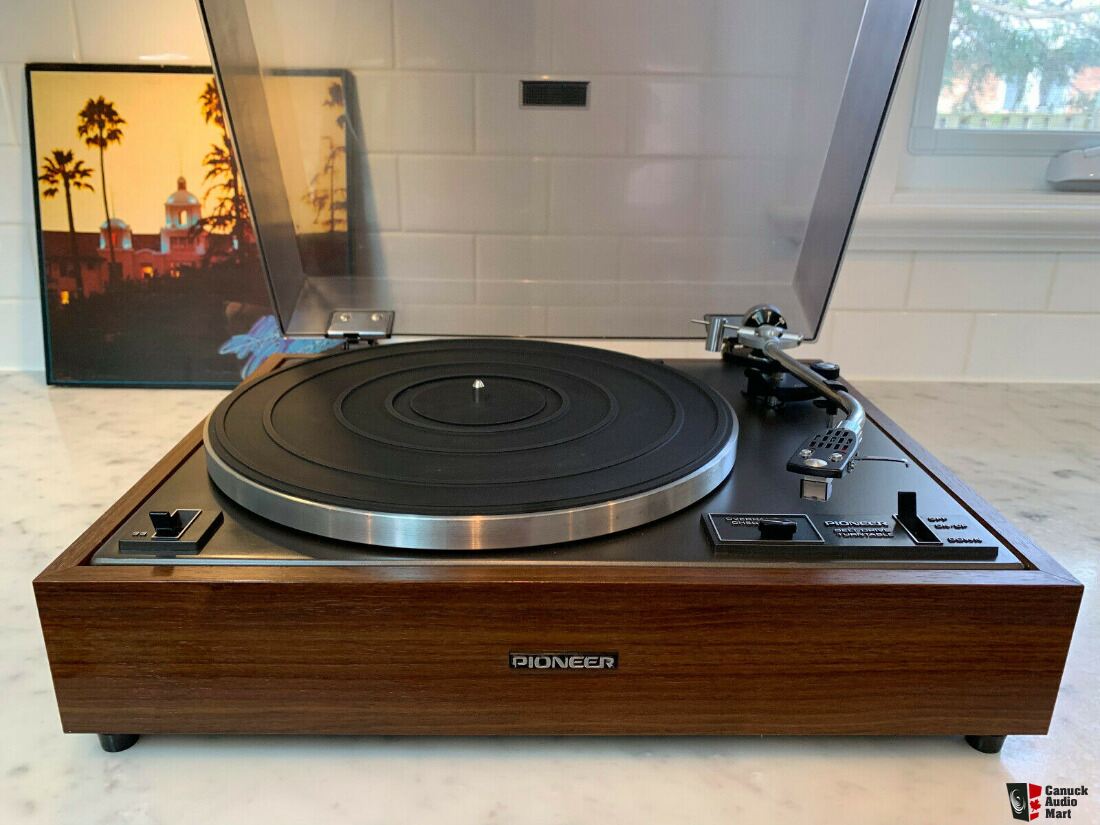

Please don't shoot me down, my audio knowledge is quite limited.
Just want to throw out an option and appreciate some feedback.
I have a PL12d that to my ears is pretty good and has been well tuned.
My question is, Any Merritt in acoustic foam in the plinth ( I have Dyno Matt, but loath to use it as it's messy)
My platter has gorilla tape underneath deadening it slightly and a leather Matt and then an acrylic at the top for further deadeing and VTA
Many thanks.

A reasonable very basic table. How fresh is the belt?
The plinth can be improved, but acoustic foam will do nothing.

I don't see that it can improve much by changing the plinth, too much work and when you finish it, you may feel disappointed. -
Do not change the position of the lateral weight (it should not be crooked as in the photo), it is calibrated at the factory, just drop it by loosening the screw ( the TT must be perfectly level) and adjust it again

Not change, just improve.
One thing that is important is to align the cartridge with a proper tool. The cartridge needs to be twisted in the headshell to get it into alignment.
Is this the semi-auto? (PL10 should be the manual, PL15 the full-auto. Might make a bit of a difference if you removed the auto feature.

Belt is correct and new, I've never suffered from a bad belt like others on the pl12d.A reasonable very basic table. How fresh is the belt?
dave
Like I mentioned it's well tuned and I've had it many years just trying to talk myself out of upgrading it I guess.
