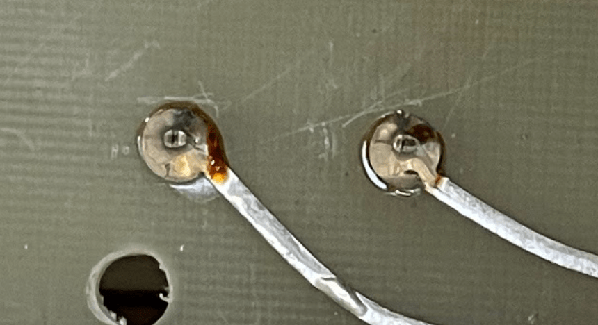

Also found out one of the transformers get pretty hot = 100 Deg C with lid on and right near one of the winding contacts/leads
I will re-solder the wire joint, but it 'looks' ok, good nudge as I have been wondering that. It's the one on the left that gets hot. This is where the winding joins the board, it just superficially looks ok.

Repair both joints, separate, mild abrasion to clean and make surfaces rough, solder again.
Do the wires as well with abrasive.
220 to 600 grit paper used gently, or a brass wire brush is enough.
Use flux, clean up later.

What amperage is the circuit pulling? I'm not seeing an issue with the solder joints, but can't hurt to clean and resolder to make sure.
Left side one has brown marks...heat, flux residue, whatever...

Oh, I forgot, do the joints on the back of the board as well, where the pin and track are joined.
