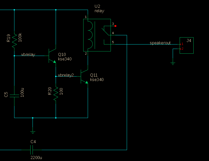

Turn on pop on speaker even when using relay
Even when hooking up a relay from the amp output to the relay and delaying the connection for a few seconds, there is a short pop on the speaker after the relay makes the connection. Attached is a pic of the relay part of the amp. How do I eliminate this pop?
