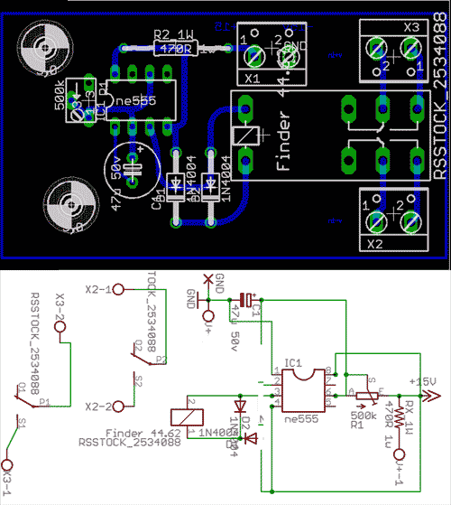

K, I don't see, why the realy board would not work for what you want... what exactly do you think prevents this?
To use it to switch something off insted of on, you only need to change it so you use the 2 legs on the relay that are not connected now... the other 2 legs are "switch on side"
Also it runs fine off one rail... as long as you have between 5V and 16V to drive the timer chip... (lower voltage than 12V as per my example would require 6V relay)
Nordic, as I said in previous post, I cannot open the files in relayboard.zip, so I just don´t know what the circuit is.
lineup: thanks for the relay idea, I just needed the kick in the right way, I was thinking about discharging the cap with some jfet, but this is much better and simpler!
But as I think about it, I need two switches for stereo amp, so I will probably use dpdt relay for output and one small DIP relay for discharging the cap.

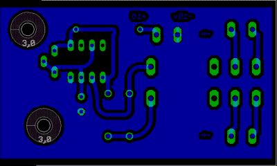

In eagle you need to click ratsnest to fill in the groundplane...
I made this PCB with a blackmarker by printing a mirror image from eagle. tapeing it to pcb, drilling the holes through the picture, remove paper and play connect the dots with the black marker...
I do my boards the same way, also in eagle.
I recently installed some spice program and it took the relation of .sch with eagle and made it to open .sch files in the spice, but it doesn´t accept eagle 🙂
I will take a look at the circuit later today.

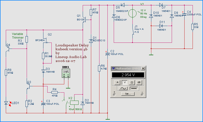

Adjustable Time Delay for Loudspeaker, with 12V regulator
Yes, my information in that post(one relay with 2-pole 2-way) is useful, but not the correct solution in this case.
You have figured out the correct setup yourself:
One relay:
1 switch, Normally closed(at no power), for discharging TIME CAP.
One second relay:
Should be triggered by the TIME CAP, when reaches certain voltage.
As you say, this could be DPDT ( double pole, double throw )
= 2-pole 2-way
for control of BOTH channels output terminals to Speakers.
Below is my circuit.
In upper right corner is the main circuit,
12 Volt AC secondary, bridge rectifier, and Amplifier taking ~500mA idle (33 Ohm load)
From this 12 VAC, is a separate AC rectifier, using two 1N4002 (100V 1A).
They feed a simple 12 VDC regulator, with TO126 transistor output.
To load TIME CAP, I use a JFET CCS (adjusted for 50uA).
To discharge CAP, the 470ohm resistor.
Voltage across CAP is sensed by a TO92 Darlington.
( gain 2.000 - 4.000, takes almost no current from TIME CAP)
When voltage reach a certain level, after 3-5 seconds, for example,
this darlington(Q3) turns on Q4, which is the
driver for 12 Volt Loudspeaker relay.
For testing in this circuit, I use a LED that starts to light,
instead of the Loudspeaker relay.
By using a separate rectifier, two 1N4002,
it does not matter if the Main Big Caps in amplifier supply
are fully charged after switch OFF or discharged to any degree.
What is sensed is if the secondary AC of the transformer is ON.
For testing I used the AC ON-OFF SWITCH, J1, next to the 12V AC source.
The resistor R3, should be a Trim Pot, to adjust the time you want.
Also for getting longer time delays, you can Increase C3.
Formula I used for this timer: t = (C x V) / I
t, time in seconds
C = value of C3, 100uF
V = 3 Volt, after t seconds CAP has reached 3.0 Volt
I = Constant loading current = 50uA, by BF245A JFET
t = (100uF x 3) / 50uA
t ~ 6 seconds
Enjoy!
lineup

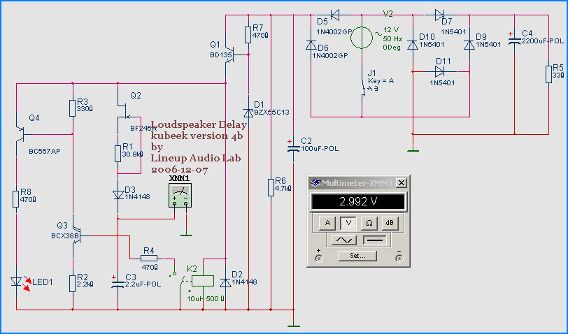

In my attached circuit, the LED was Turned ON
at about 2.992V across the TIME Cap, C3.
There are some smaller adjustments that might be needed for suit your needs.
But I think, in basic idea, this circuit is good,
has got very good precision, as well as
the feature with a 12 Volt regulator for relays is nice!

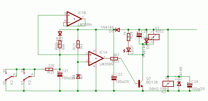

kubeek said:So here is what I made: supply is full-rectified AC, cca 12-15V.
Time delay ON for 15Vpp is 3s, resetting time is 10ms.

okay
here is a better image
with the correct value, 100uF for C3 = TIME CAP
for comments, see my previous post above

kubeek said:Nice circuit, but I will stay with my design.
What do you think about that one?
Your circuit. If it works every time.
Then No problem.
To be honest, I did not try to explore it very much.
It looked a bit more advanced, using Op-Amps and all ..
Not my style.
I would prefer my own more simple and discrete circuit.
And I hope somebody will have good use for
kubeek-delay_4b
... because it is good.
Good Luck with your delay, kubeek.
My mission and hours( half a day ) of work at this project
... is over now.
lineup 😎 moving on from here to new interesting challenges
