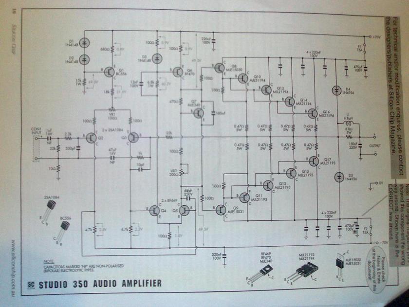

Hi guys,
I am looking at buying a couple of amp kits based on the MJL21193/94 - it is rated at 200W into 8R and 350w into 4R - The specs in class a/b mode are

Now I was wanting to know if it would be minor to bias this into class A to get around 60W into 8R - Im guessing the +-70 volt rails will need to be alot less and the bias changed but can anyone see any issues in doing this?
I have attached a schematic so you can see the design - thankyou for any input.

My thought:
you'd be better off getting an amp designed for class A rather than doing a mod like this.
Yep, totally feasible. Reduce the supply to about +-35V and turn the bias up to 3 amps total. You may have to change VR to 4K7 to reach required bias. Also you will need very beefed up heat sinks and a large power transformer with plenty of caps.

Not related to it's use as class A:
I'd have a real problem believing some of the quoted numbers, especially the THD.
