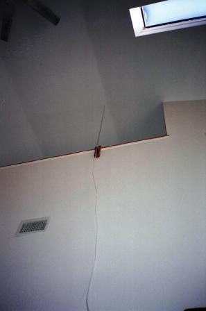

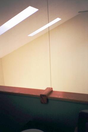

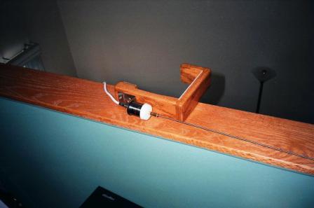

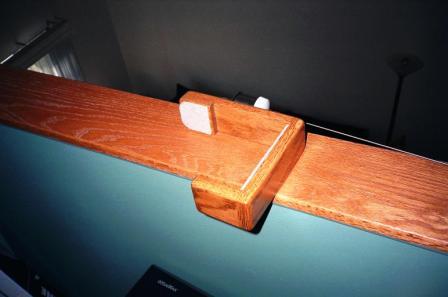

I promised some Pictures of what I did with my ST-2 for attractive indoor mounting. We live in a Townhouse that is on the second floor and we have a loft on the third floor so I put it up as high as possible for all to see. We can't mount it outside as per the Co-op Association.
Here are a few Pics:
Regards//Keith

Thanks for the pics Keith,
You should be able to pull in some stations with that set up, I may have to install mine outside
I have a 2 story home and the system will be on the main floor.
