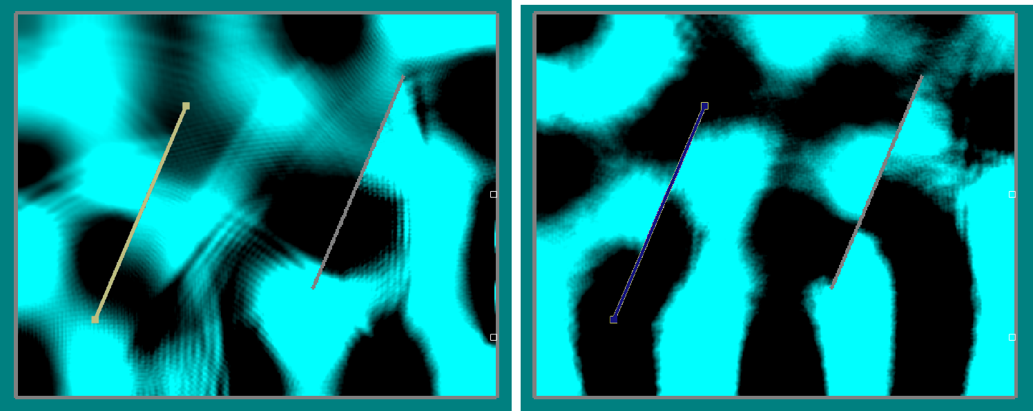

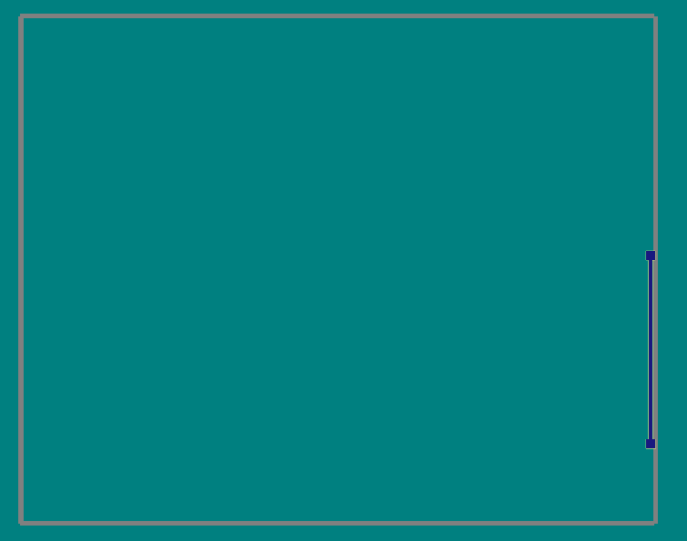

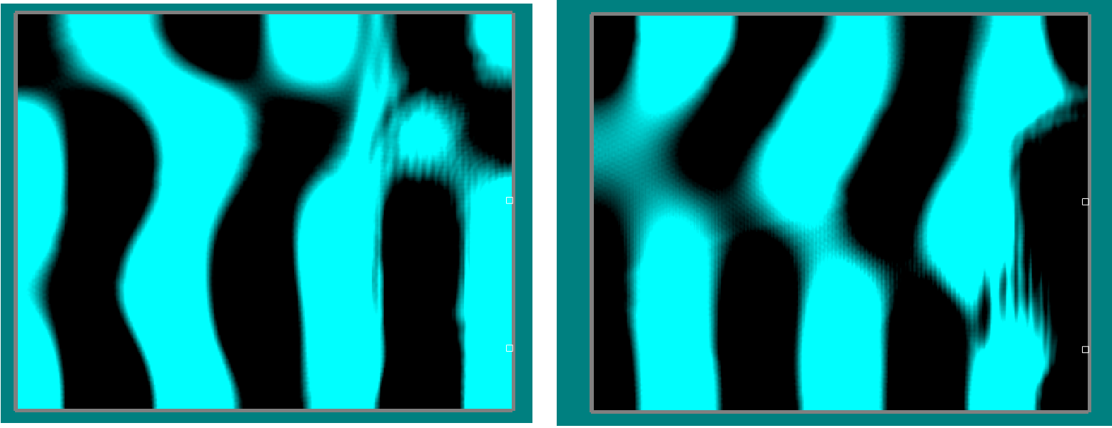

These sims show a couple of examples of the moving wave pattern each for with and without the reflectors. It's difficult to see much but the case with the reflectors has more fuzzy bits so perhaps a small reduction. I still wouldn't want to go without damping material unless I could measure an improvement.I wonder if this would do as good a job of dealing with back waves

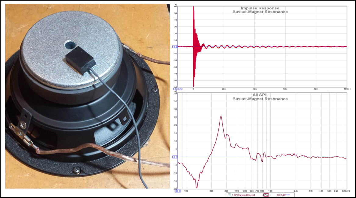

Also an interesting way to support the driver magnet, I wonder why they don't just use a stronger chassis.
It's not so much about supporting the driver magnet as it is about damping the high-Q resonance of the mass-spring system (mass=magnet, spring=basket). An example accelerometer measurement attached, as well as an animated gif of the resonance mode. Most stamped basket woofers will have resonance in the 200-300Hz range...cast baskets usually in the 600-900Hz range. When fed with a sine tone at the resonance frequency, pretty much the entire enclosure is excited by it...easy to feel with the finger tips. The back usually most of all. An easy way to differentiate it from panel resonance modes is to look at response with accel mounted to a back corner of the enclosure. Any resonance you see there is from the basket-magnet resonance, not a panel mode.
Attached also is the AVID patent application as well as an approved patent from Genelec for essentially the same thing. The Genelec patent does have a bit of technical details.
An animation of the general damping concept can be seen here:
The Dynamic Vibration Absorber
On some " magnet out " speakers I made, if I put a finger in the gap between the magnet and chassis, I could feel a vibration, I squashed some red cheese wax in the gap and in made a noticeable improvement to the sound, removing a " zing " it previously had. I think that soft cabinets ( like the BBC LS35a ) have the advantage of damping the magnet chassis baffle vibration, the Remlab sandwich is a good example of a baffle that can dampen such vibrations.
