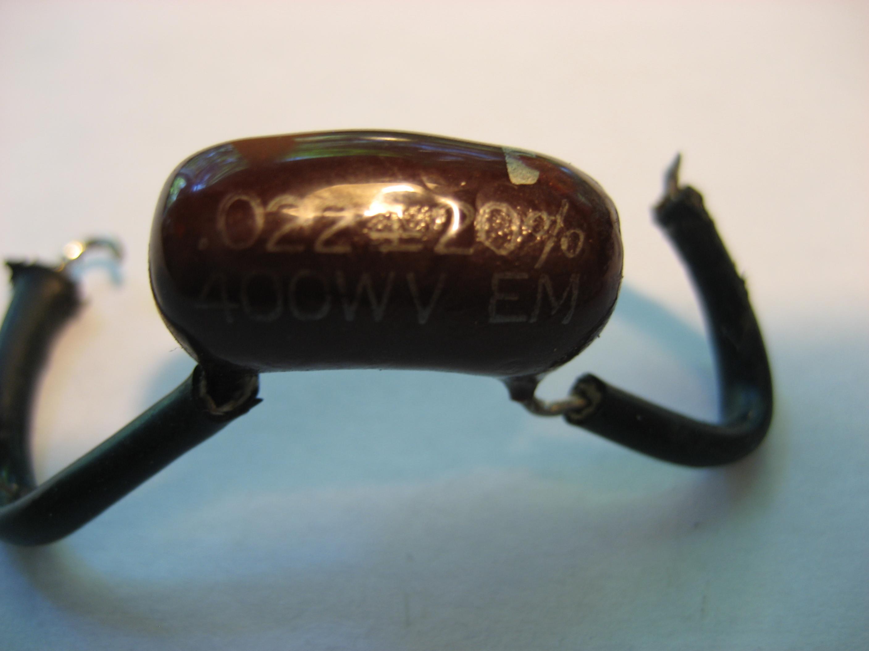

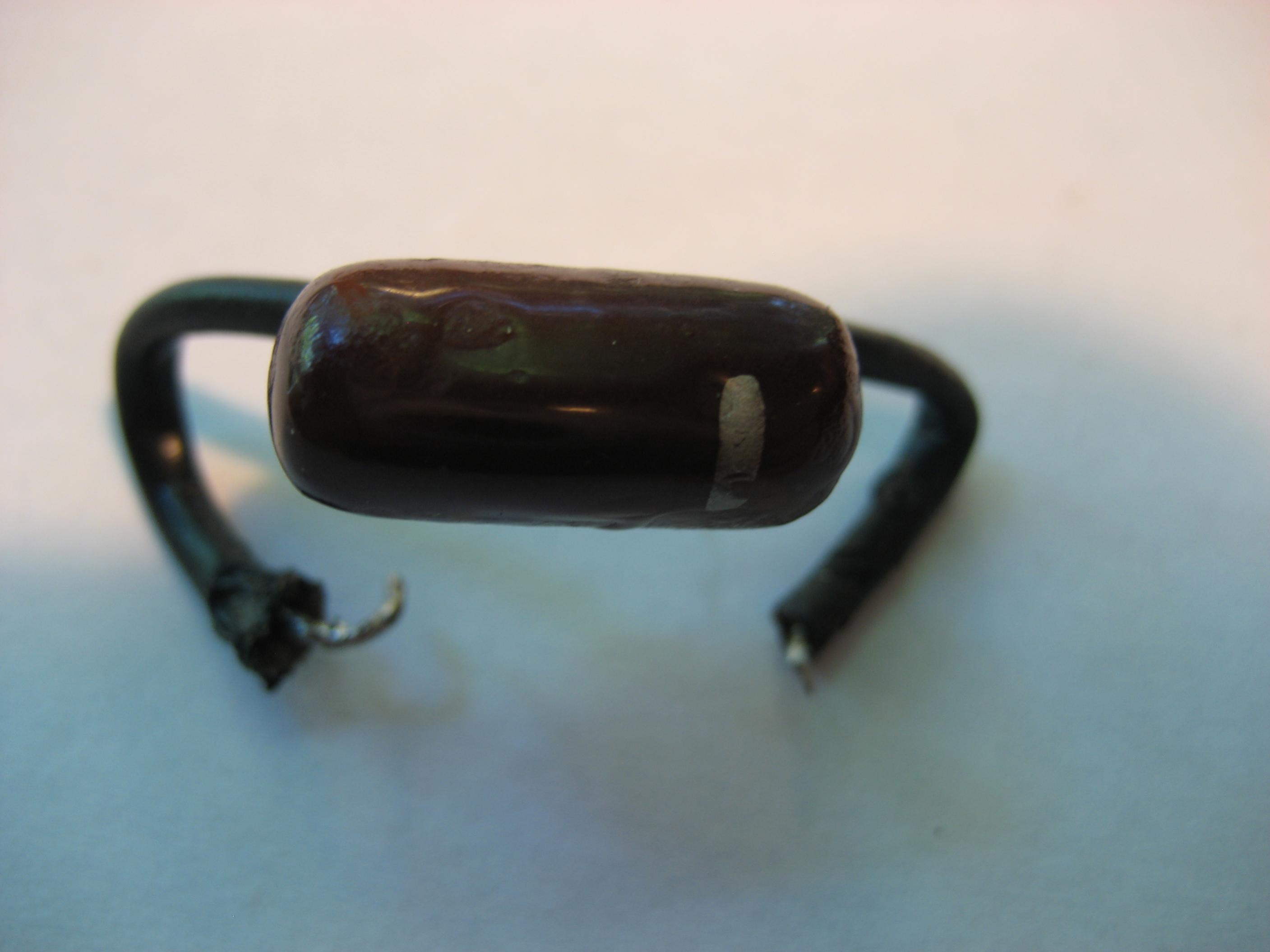

Something that puzzled me during the re-build was that the assembly manual stressed the importance of installing the "tubular capacitors" exactly as shown. That was in reference to those original caps having a "bar" on one end which to me indicates polarity. Unless I am mistaken, those "tubular capacitors" are a film type which are therefore, generally speaking, non-polarized. With that assumption, I installed the Orange Drops without heed to whether one side was PLUS and the other MINUS.
Attached are 2 photos of one of the original "tubular" caps to show what I meant about the "bar" at one end. Is it possible, that I should have tried sourcing a polarized mylar or some other film capacitor and does such a thing exist?

It isn't polarized. The stripe at one end indicates "outside foil".
A cap is two layers of a conductor - in this case a thin metal foil - with a dielectric insulator between. The that is rolled up to make a compact part. One leyer of foil will then wind up on the outside of the roll. The wire lead to that one is thus the outside foil.

Normally the outer foil should connect to the lower impedance node - could be ground if it is a decoupling or filter cap, or the anode if it is a coupling cap.
If, as seems to be the case here, the cap can pick up significant hum then it is not only necessary to get it the right way round but also in the right position - distance from nearby AC conductors matters. Keep it well away from heater wiring, for example. This sort of thing was routine in the 1950s, but modern audio enthusiast have forgotten these old skills.
To find the outer foil connect the cap to an amp input. Hold the cap in your fingers. Note the level of hum. Turn the cap around. Try again. Loudest hum means the outer foil is connected to the amp input. You can use a scope instead of an amp if you have one.

The degree to which there is a right way to hook up a cap depends on its role and its reactance as compared to other circuit parameters.
The shielding provided by the outside foil can be very significant with bypass caps, but is often far less significant for coupling caps since the cap's impedance at low audio frequencies should already be low. IOW both leads of the capacitor can be thought of as being shorted together for AC.

Let's assume a net anode impedance of 25k (i.e. anode with anode resistor in parallel). Grid resistor of next stage is 1M. A 22nF cap will give LF rolloff at 7Hz, so big enough for many purposes - people did not expect LF to go down to 1-2Hz in the 1950s and 60s. At 60Hz the cap will be -j120k in impedance.
If the outer foil is connected to the anode then an incoming hum current (via a small stray capacitance) would see an impedance of just below 25k, and little attenuation from there to the following grid.
If the outer foil is connected to the grid then the hum current would see an impedance of about 25k-j120k - about 122k in magnitude. The 1M in parallel will knock it down a bit but it will still be significantly greater than 25k - say 100k.
So we have a hum difference of about 12dB just by reversing the coupling cap. This is because for coupling purposes the cap reactance merely has to be small when compared with the grid leak resistor - but may still be large compared with the anode impedance.
