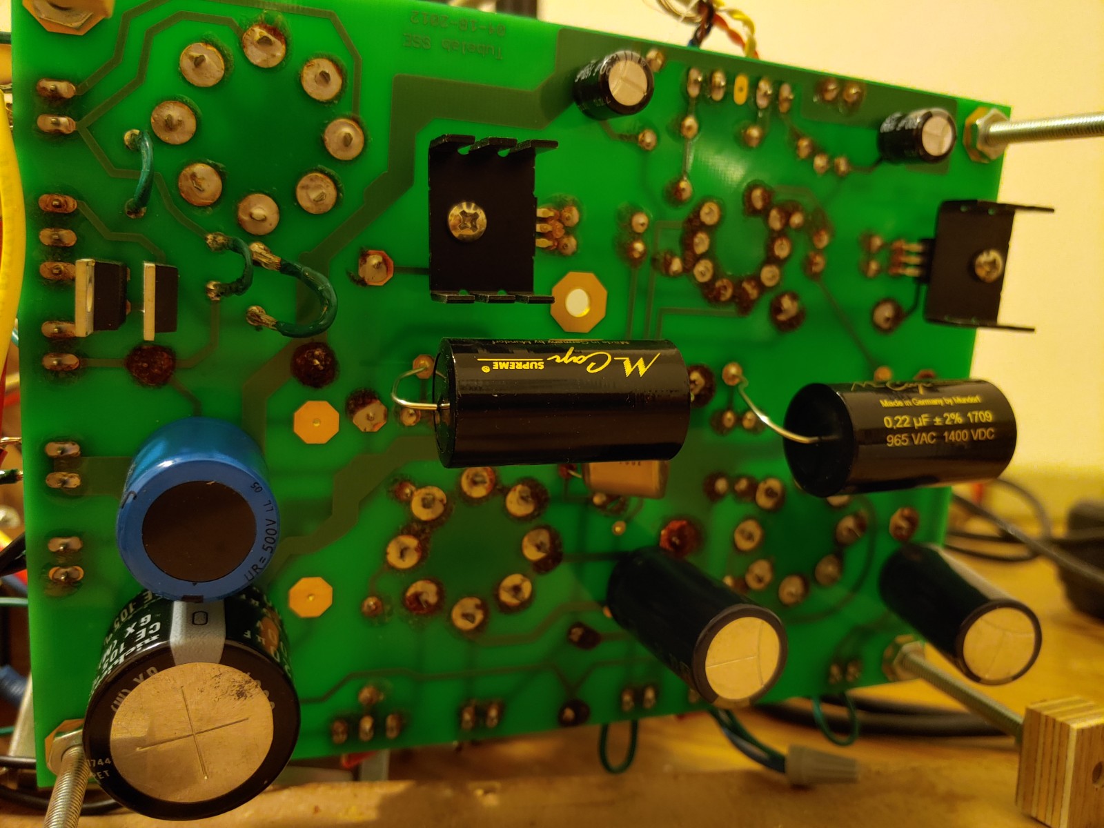

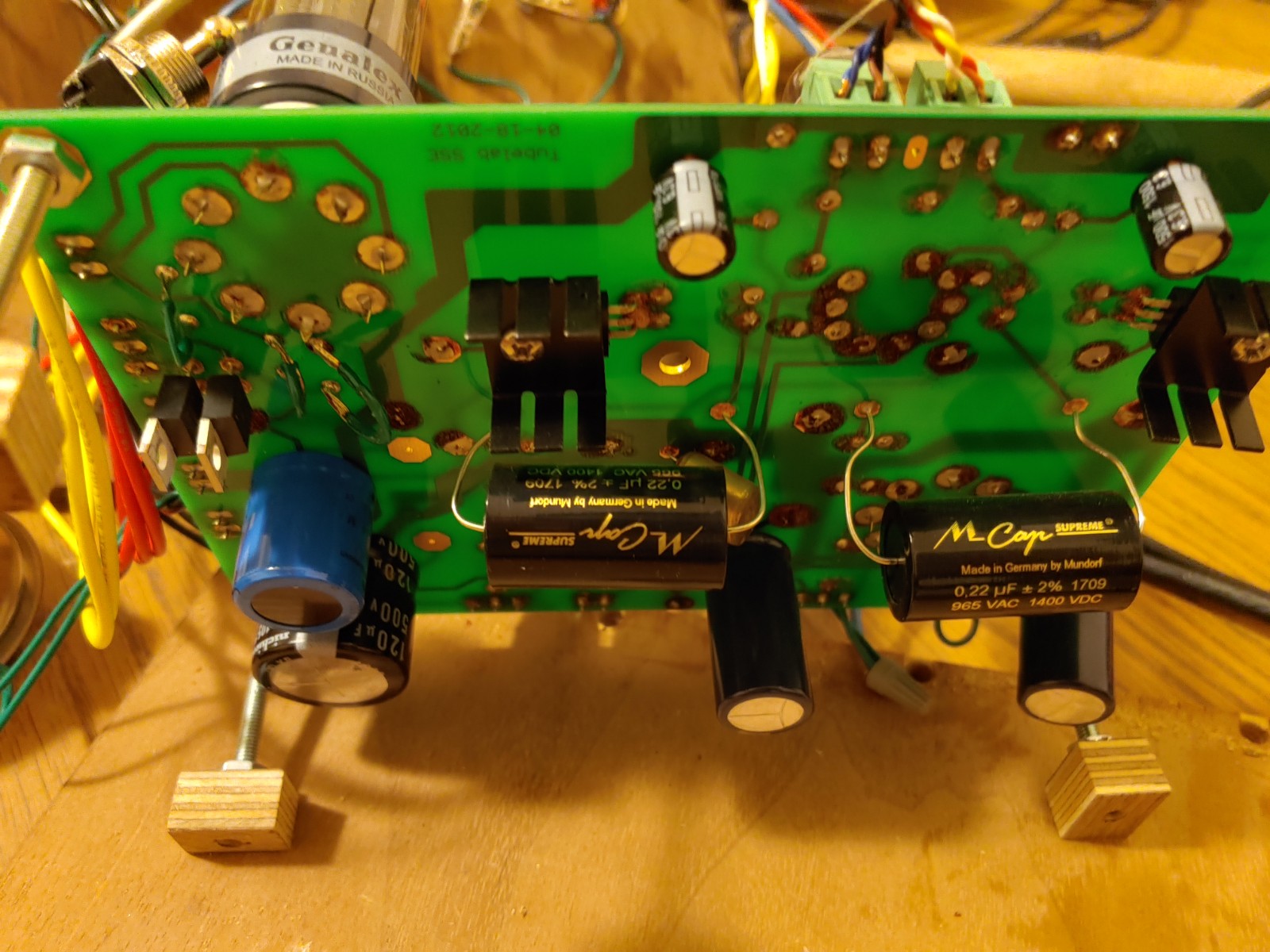

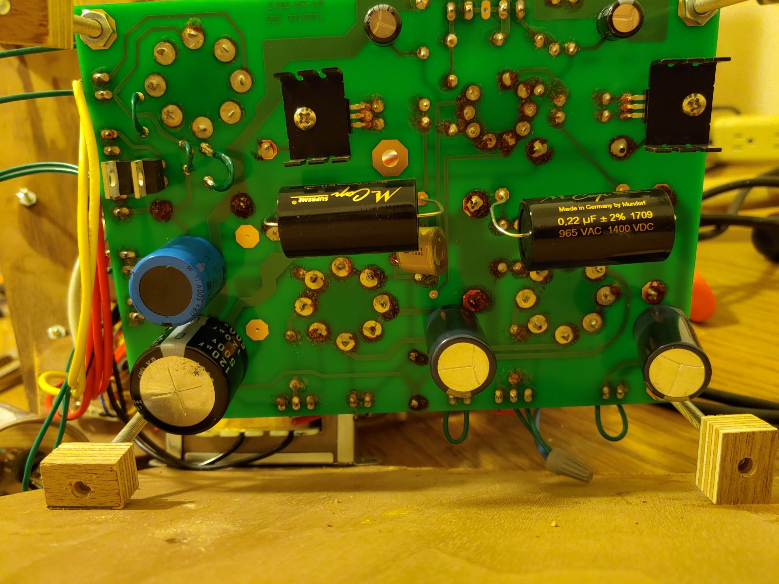

Here are a few different angles of the back. As far as I can tell, everything looks attached and okay. Not sure what a blown capacitor/resistor/FET/etc. would look like, but I think it would look obvious if there were any.
a lot of the messy joints are actually because I was using the solid flux that came with my soldering iron when I bought it. I guess it's resolidified and blackened over time. Scraped it off with no issue.
I put everything back together with my volume knob in the correct position this time and I think it sounds about as loud as it used to. I might just be paranoid that something's still wrong but it doesn't sound quite the same as it used to. Maybe it's just the new tubes that need breaking in...
