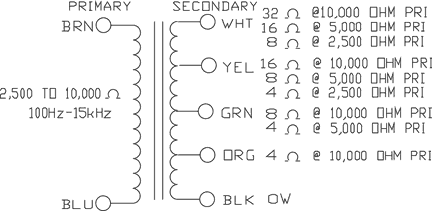

now my question is how to wire my hammond 125ese for my 16 ohm speakers at 5k impediance like tubelab suggests (also suggests cathode feedback)
the taps are as follows with the picture

http://ericsaletel.com/amp/125ese.jpeg
Thanks i thought i had this figured out but been away from the project for too long to make any sense of it.
ok so after looking at this a bit brown and blue go to t2/3-pri and 2 and 1 on those get jumpered? t2/3-sec gets black and white. (because at 16 ohms it will give me 5k ohm impediance im looking for correct?)
then i use the output phase that produces the lowest volume? (as written below)
http://www.tubelab.com/images/AssemblyManualSimpleSE/Wiring/SSE_grounding_2.jpg
Cathode feedback is used in this diagram. The secondary of the OPT's are connected to ground on the PC board so a separate connection is not needed. Note the reverse connection of the output transformer secondaries. This is needed on many OPT's to get NEGATIVE feedback to the cathode of the output tube. If unsure of your particular OPT's try wiring the secondaries each way (swap the two secondary wires, leave the primary alone). Chose the connection that produces the lowest volume.
Blue goes to B+; Brown goes to plate of the output tube.
Use the white secondary lead to reflect a 5K impedance to the primary with a 16 ohm speaker load; black is the common.
The Hammond 125xSE does not connect up the same way as conventional output transformers with regard to cathode feedback. To enable cathode feedback, just connect one of the unused secondary leads to the cathode feedback terminal on the circuit board that connects to the negative end of the cathode bypass capacitor. You can play around with the different secondary leads and see if you hear any difference. They respond very well to cathode feedback - you can really hear it flatten the frequency response, it's not at all subtle.

1) If you are using Hammond 125ESE transformers, they are not properly connected to the board.
Connect the primary of the 125ESE as follows:
Blue primary lead attaches to T3 Pri:3 and T2 Pri:3. (B+ rail)
Brown primary lead attaches to T3 Pri:1 and T2 Pri:1 (tube plate / anode)
The 125ESE lacks ultra linear taps, therefore, there is no connection from the 125ESE to T3 Pri:2 or T2 Pri:2.
T3 Pri:2 and T2 Pri:2 should be jumpered to T3 Pri:1 and T2 Pri:1 for triode operation, or T3 Pri:3 and T2 Pri:3 for pentode operation. It is much easier to get the amp running in triode configuration, and I would suggest you start by wiring the amp for triode operation.
The white secondary lead should attach to the positive terminal of your speaker. The black secondary lead should attach to the negative terminal.
Forget about cathode feedback until you have your amplifier running. For now, connect a jumper across T3 Sec:1 and 2, and T2 Sec:1 and 2.
The Hammond 125ESE connects unconventionally regarding cathode feedback; the method of connection that I use is described above.

so to get cathode feedback i want to run an unused secondary tap to t2/t3sec(2)? and ground to the other? sorry this is hard for me to grasp.

If you look at the T3 Sec and T2 Sec terminals, you will see that they are configured as follows: one of the two terminals connects to the negative lead of the cathode bypass capacitor, and the other is connected to the ground plane of the printed circuit board, thus when these two terminals are jumpered, the negative lead of the cathode bypass capacitor is grounded.
I use an unconventional method of cathode bypass with my Hammond 125ESE as detailed above: remove the jumper, and connect an unused secondary lead to the T2/T3 Sec terminal that connects to the negative lead of the same side cathode bypass capacitor. Nothing more needs to be done. I'm sorry I can't be more explicit and give you the exact pin number - I'm at our secondary residence and have no simple se board handy. Perhaps someone else does.
