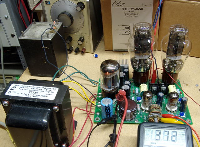

I have been using surplus transformers in my 300B amps that deliver 640 VCT. My supply of them is getting low, so I am searching for a new source. Some users built 300B amps using the Hammond 276X transformer which is rated for 640 VCT. The problem occurs when some Hammonds put out far more than they are supposed to. I recently saw a 276X put out 708 VCT with a 175 mA load. The no load voltage was 740 volts. This caused some grief, and I can no longer recommend the 276X transformer.
Since Hammond transformers have a reputation for too much voltage, I have ordered a Hammond 272JX transformer for my next 300B amp. I couldn't justify the higher cost of the 300 series. I will test it as soon as it arrives, but I just ordered it yesterday, and it comes from the other side of the country.

When I got home from work today there was a box from AES on my doorstep. How long do you think that it took me to get sound from the moment I opened the box?
After dinner and an hour of mindless reality TV with Sherri, I ripped the box open at 9 PM and had sound at 9:34. I played the amp for an hour. During this time the transformer remained cool. It is a relatively cool (about 68 Degrees F) tonight, so the line voltage is up to 124.5 volts. I measure 372 volts of B+ with the 300 B's biased to 70 mA each. I had 390 volts on the hot side of the choke. With a more normal line voltage, I would expect 355 to 365 volts.
I didn't take any other measurements, I just wanted to listen.

No, the amp hasn't been turned on since the initial test. I have been stuck at work until 7 or 8 PM this week. After I posted the initial report, I noticed that the 6.3 volt filament winding was puting out 7.2 volts. This is also a common complaint with Hammond transformers. The filament voltage is regulated in the TubelabSE, so the tubes are safe. The regulator however must eat this extra voltage causing it to generate extra heat. A larger heat sink is needed on the regulator IC.
I plan to do some more testing on this amp this weekend. I will be making a cabinet for it in wood shop class Monday night.
I think that this transformer is a good choice for 300B amps.

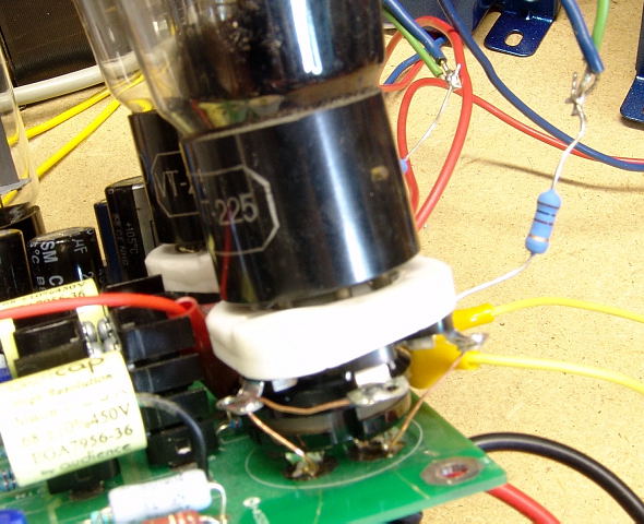

I did some more experiments using the Hammond 272JX and a TubelabSE board. I found a bunch of 307A / VT225 tubes in my warehouse so I wired a pair in place of the 300B tubes and performed some testing last Sunday. It was unseasonably warm and my line voltage was 119 volts. B+ varied form 345 to 355 volts. Some prefer to operate 300B tubes with a higher voltage, and I usually tend toward running most tubes near their maximum voltage with a higher than "normal" load impedance. I would like to run 375 to 395 volts on 300B tubes, unfortunately there are very few transformers available that can make this voltage easilly. I have been using some surplus transformers that are 325-0-325 volts, but I am running out of them. The Hammond 276X or 273CZ (funny mounting) are marginal for current ratings if you crank up the tube current, and work but get quite hot. The 273BX puts out too much voltage, especially when the line voltage is high. The 372JX should be ideal since the "universal primary" allows for some fine tuning of the voltage, but this transformer is too expensive for my use.
The 300B tubes sounded good at 350 volts and I was planning to build a 300B amplifier using this combination.....until I heard the 307A's. I will build this amplifier, I just haven't decided whether it will use Chinese 300B's or vintage 307A's. The expensive 300B's are not in my budget.

The 350 volts that this transformer produces is too much for any "normal" 45's or 2A3's. The Hammond 1627SEA is a 2.5K ohm OPT. That is too low for a 45 tube, but is OK for a 2A3 or 300B. I am not familiar with Sovtek 2A3's, so I can't say if they can deal with 350 volts. The voltage could be lowered a bit by using a choke input, but I haven't tried this combination.

Hello,
How did you get the 5 pin socket so close to the PCB designed for the 4 pin? Did you use jumper wires, or were the pins(tabs on the socket) close enough that you could bend them to the correct contacts on the pcb?
I'm a tube nube.. I'm sure it would make more sense if I had ever seen a 5 pin socket in person.

The 5 pin socket that I used was a flat ceramic unit designed for mounting underneath a chassis and wired using point to point wiring. It is the only type of 5 pin socket that I have seen. This was one of those 5 minute experiments that I did to decide the fate of a box full of tubes sitting in my warehouse, so I simply sat the 5 pin socket on top of the 4 pin socket that is already on the PC board and ran wires to make the connections. The OPT (blue wire) is wired to the plate cap on top of the tube (green wire) and a 100 ohm resistor connects to the screen grid pin. That 5 minute experiment is now in its second week.
I have not decided just exactly how I will make this a permanent arangement yet. I mak make some sort of adapter using a 4 pin tube base and the 5 pin socket, or I may mount the 5 pin sockets above the board somehow and use short wires for the connections. I will post the details once I figure it out.
