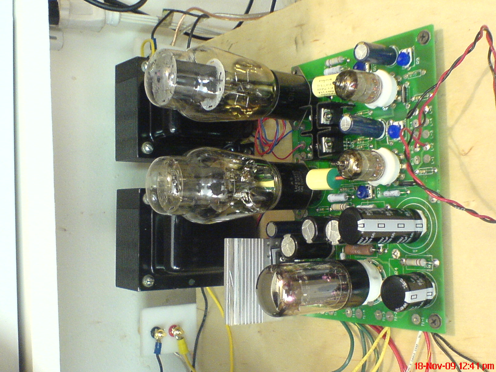

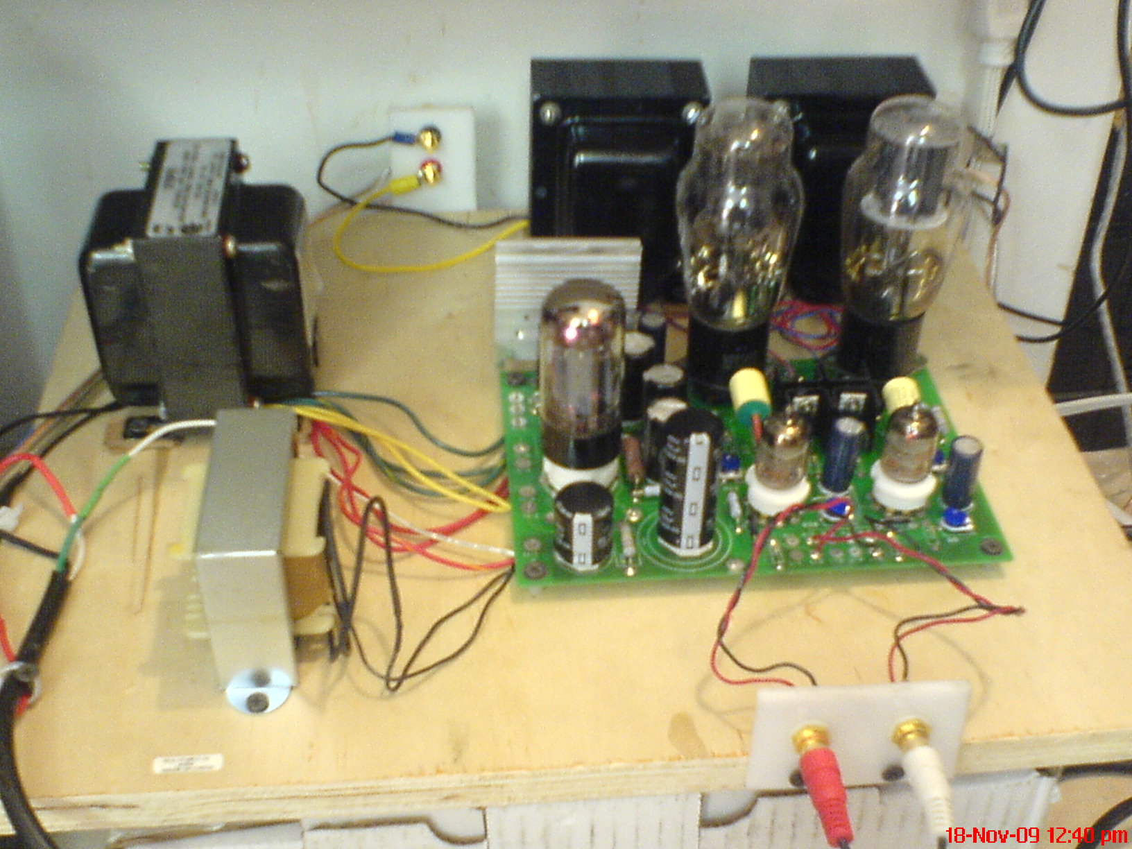

I just built the tubelab SE amp. and it runs 2A3 tubes. In the AC input I put the 3/4 A fuse. Is it suitable for the amp? The resaon I ask because I was running it for about 2 hr. and it blew fuse. I replaced another fuse and blew instantly. The power transformer hot but touchable. Please give me some advice.

I can't quite read the label on your power transformer, what number is it? The Tubelab SE with 2A3's needs a 1 amp or 1.25 amp fuse depending on which power transformer is being used (on US 120 volt power). A Hammond power transformer will get pretty hot, but if you can keep your hand on it for 20 seconds or so without using bad language, it is probably OK.
I use Hammond 270HX power transformer for the amp. I will buy some new fuse tomorrow and re-check the amp. Thank you Tom and George.
Binh
Binh
I'd pickup some 1A and 1.5A slo-blo fuses. Start with the 1A. I suspect they will suffice if it was working for a while on a 3/4A.
