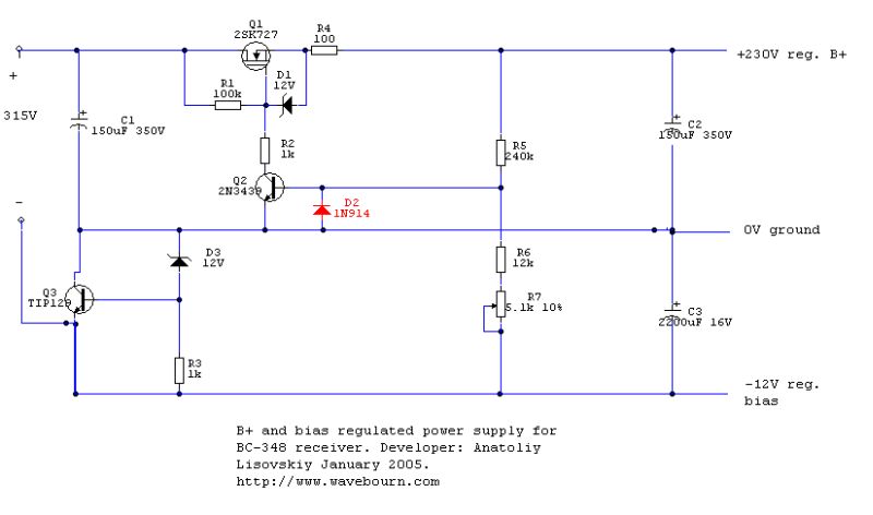

One zener from source to the gate solves the problem more gracefully, without hot red plate and blown up pieces of cathode, but don't affect normal conditions:
To further limit the current you may move it's right leg through the R4 resistor.
this is a nice design for a regulator. Can I ask why no bypass cap on R5? From R5 to the base of Q2. That is common to reduce the HF impeadence of the supply.

Yes, you may reduce own dynamic resistance on high frequencies of the regulator (without output capacitor), but in case of shorted output you'll get a pulse of voltage between base and emitter that may exceed 5V and damage the transistor. It is better to use output capacitor, anyway the regulator is far better than a passive filter with chokes and capacitors. But as soon as a diode present, you may use a capacitor. Also, one more zener may be used to limit maximum output current, as I described above, in this particular case 12V Zener will limit on about 50 mA, if to decrease resistor in source proportionally the limited current will be higher.
Also, the main feature of this regulator is a soft start. It was designed to power vacuum tubes. When tubes are cold they don't draw a current, and voltage on the output of the regulator goes up slowly; when tubes are hot and start drawing current due to positive feedback it increases output voltage untill it is stable. This regulator extends life of tubes powered by it, also it minimizes impact of transcient processes when switched on, despite it is so simple and contains very few elements.
TUBESMAN said:this is a nice design for a regulator. Can I ask why no bypass cap on R5? From R5 to the base of Q2. That is common to reduce the HF impeadence of the supply.
